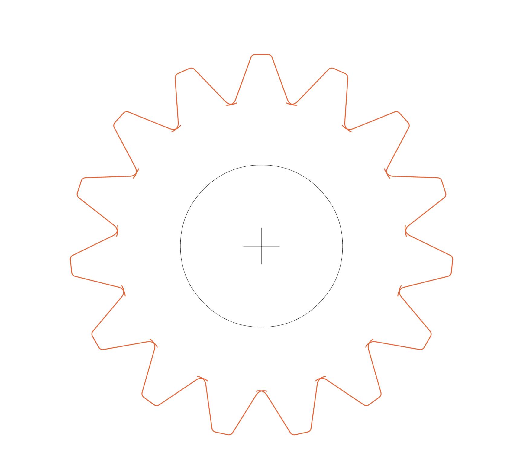

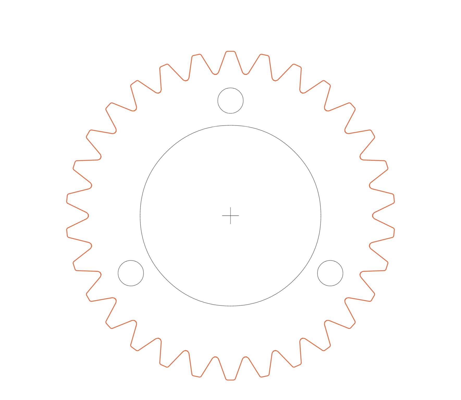

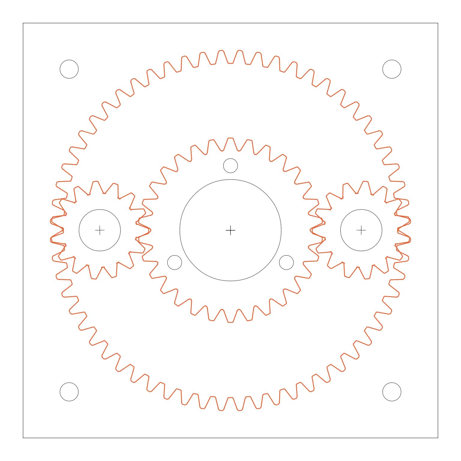

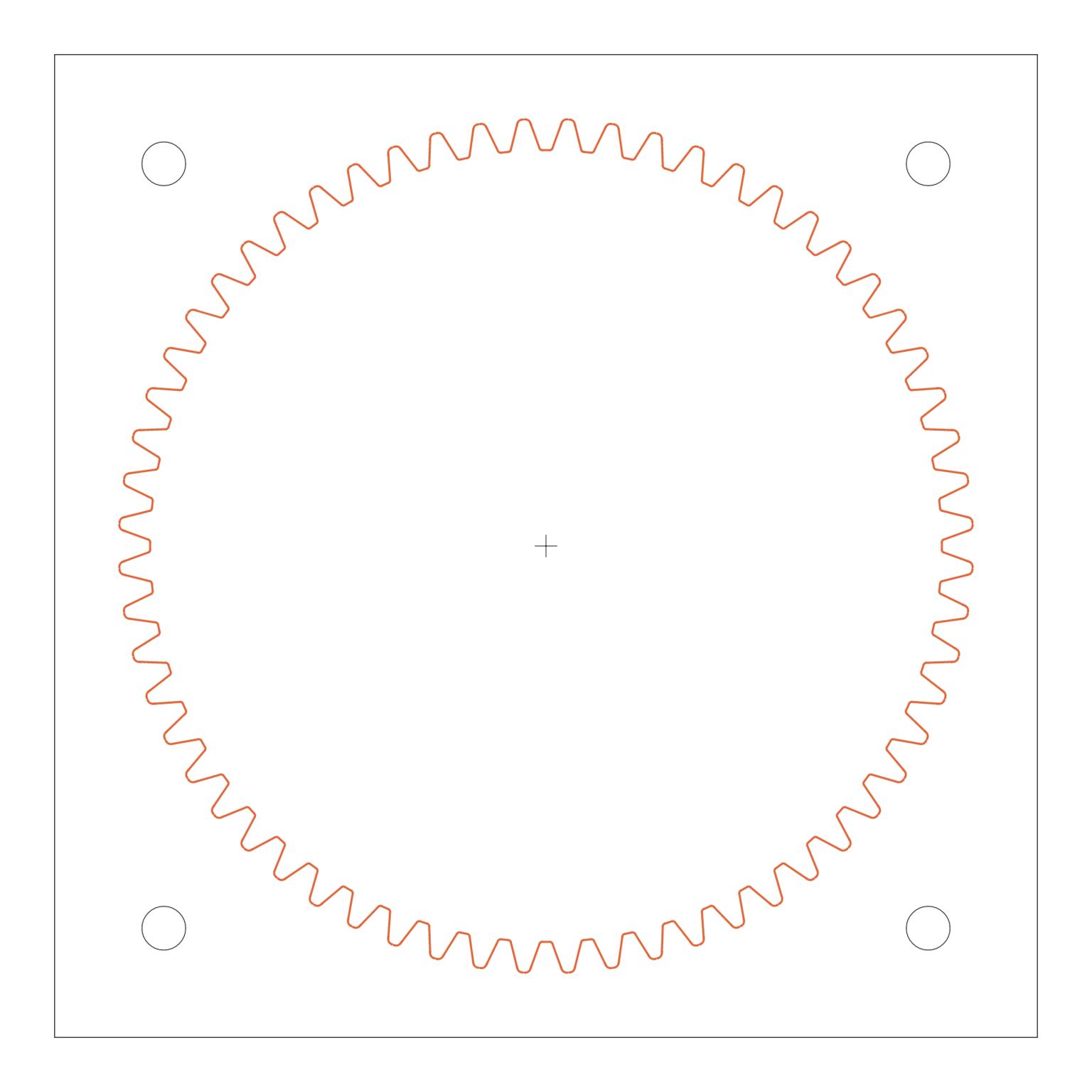

    Trying to work out how to draw the teeth for this in my CAD program, but attached is an initial sketch of the epicyclic gears.
    Current thinking is I basically want a mod 1.25 60 tooth internal ring with a couple of fixing lugs (the ring is static), a mod 1.25 30 tooth sun spur gear on a press fit 10 x 22 x 6mm bearing (this will be fixed to the rotor which will rotate freely on the 10mm axle using another 10 x 22 x 6 bearing), and 2 off mod 1.25 15mm planetary spur gears on press fit 3 x 9 x 5mm bearings (these will be fixed to a carrier thats connected to the 10mm axle ). Spinning the 10mm axle will spin the rotor at 1+60/30 = 3 times the rate or 180rpm. the torque in the gear train is around 6Nm
    That looks ok for printing - probably best if I get the finer extruder going but I've made some gears about that size which work ok. Could the unit be thicker? I'm thinking that it's maybe a bit marginal on strength - probably easiest to just build it and test it than worry too much at this point though.
    If you (or anyone else) can point me towards a gear profile calculator (can't find one that does the outer ring) I'll knock up something for a strength test.
  3. So finally managed to draw tooth profile and rotate/replicate it round a circle... Inard CAD doesn't have an easy way to do this, but what do you expect for £6!
Name:	mod 1.25 30T.jpg

Name:	Epicyclic assembly.jpg

Name:	mod 1.25 15T.jpg

  5. Strength calcs: Calculate for input gear as worst case (Ref: Spur Gears)
    Input torque = power/revs = 90/6 = 15Nm, add 50% for safety = 22.5Nm
    Tangential force on tooth Ft = 2 * torque/PCD = 2 * 22.5/.01875 = 2400N
    Bending stress = K * Ft/(b * m * Y)
    K=velocity factor, estimated at 1.03
    b = face width = 6mm
    m = module = 1.25
    Y = Lewis Form Factor = from tables, for 15T 20deg gear = .289 @ tip .49 @ centre of tooth, use .289
    stress = 1.03 * 2400/( 6 * 1.25 * .289) = 1140MPa = ~165kPSI
    PLA = 500kPSI so should be OK!
