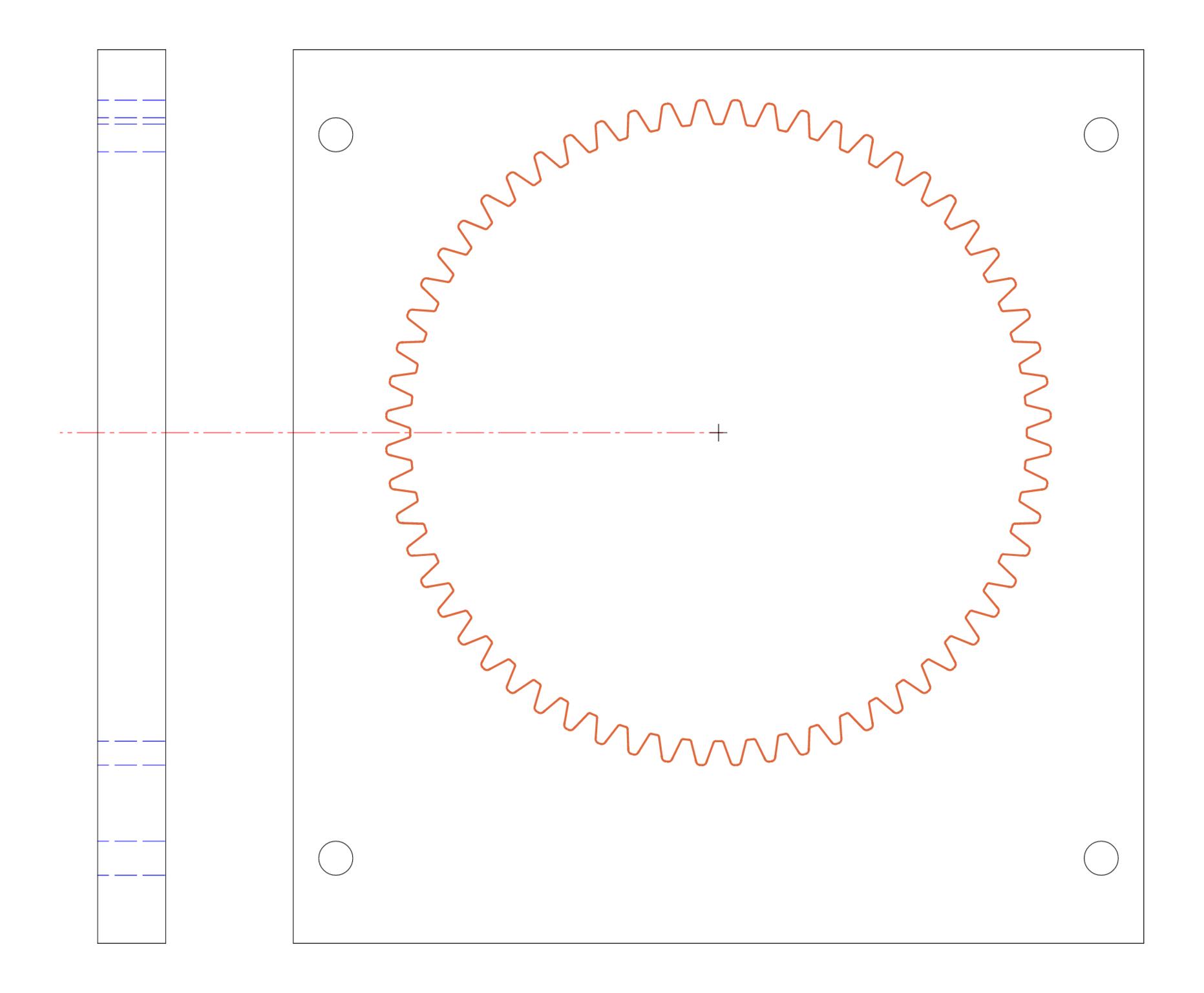

  1. Looks good tho :) Are those full thickness?
    When you say the ring gear 'bows out under pressure' what exactly do you mean? I've changed the design of that, see attached. It will be bolted to a pair of 10mm sq ally columns which will add considerable rigidity.

    Yes - that's full thickness (6mm).
    The majority of the deflection is where the gear is closest to the outer edge of the piece - the straight edges by the gears become convex and the ones on the side away from the gears become concave - it moves enough for the teeth to slip over the tops. Moving to three or four planet gears may be a simple way to alleviate this without having to make the ring gear much stiffer. Your new design will also be somewhat stiffer - is there much room to play with?
  3. There's a bit more room, I can go wider and taller and thicker if need be. This new ring gear is 8mm thick and the new gears are also 8mm as I needed more space for bearings & bolt heads.
  4. I'm surprised it deflects that much, a quick calculation, crudely treating the side as a 6mm deep 'edge' x 6mm thick beam of length 90mm with fixed ends shows a deflection of .01mm per N of load... so deflecting a whole tooth is a 250N load, larger than expected but not impossible I suppose.
    The v2 design (100mm long, 12mm deep 'edge' x 8mm thick) is .0013mm per N, so only 0.32mm deflection.
    If need be I could add a surround of 8 x 8mm ally angle to constrain the PLA.
    edit I was using the Youngs Modulus of PLA as 3450MPa. That article suggests a 50%+ reduction depending on how the filaments are laid down. The max strength requires cross-bonding, preferably at 45deg. So it could be that the forces are much lower, but the relative calculation above still holds.

    A couple of complicating factors - I forgot to say that the part is printed with 30% infill to save plastic so it's not as stiff as it could be (there are three solid layers on the top and the bottom (1.1mm) and on the perimeters (1.5mm - I'm extruding filament 0.5mm wide and 0.35mm thick)) and the concave bending of the sides away from the planet gear effectively doubles the deflection.
    I tried the new ring gear (still 6mm and 30% fill) and it moved but didn't skip (at moderate loads - see below) so I don't think it will be an issue - more something to bear in mind for any future modifications - I'll know more when I've managed a proper load test.

    Your new ring gear design is much stiffer and I don't think skipping will be a problem. Engagement seems fine as long as it's within certain limits but when the engagement zone of the teeth moves to the more angled zone near the tip, the forces increase rapidly causing the skipping so a moderate increase in stiffness (and improved tolerances from the new slicer) has made a big difference.
