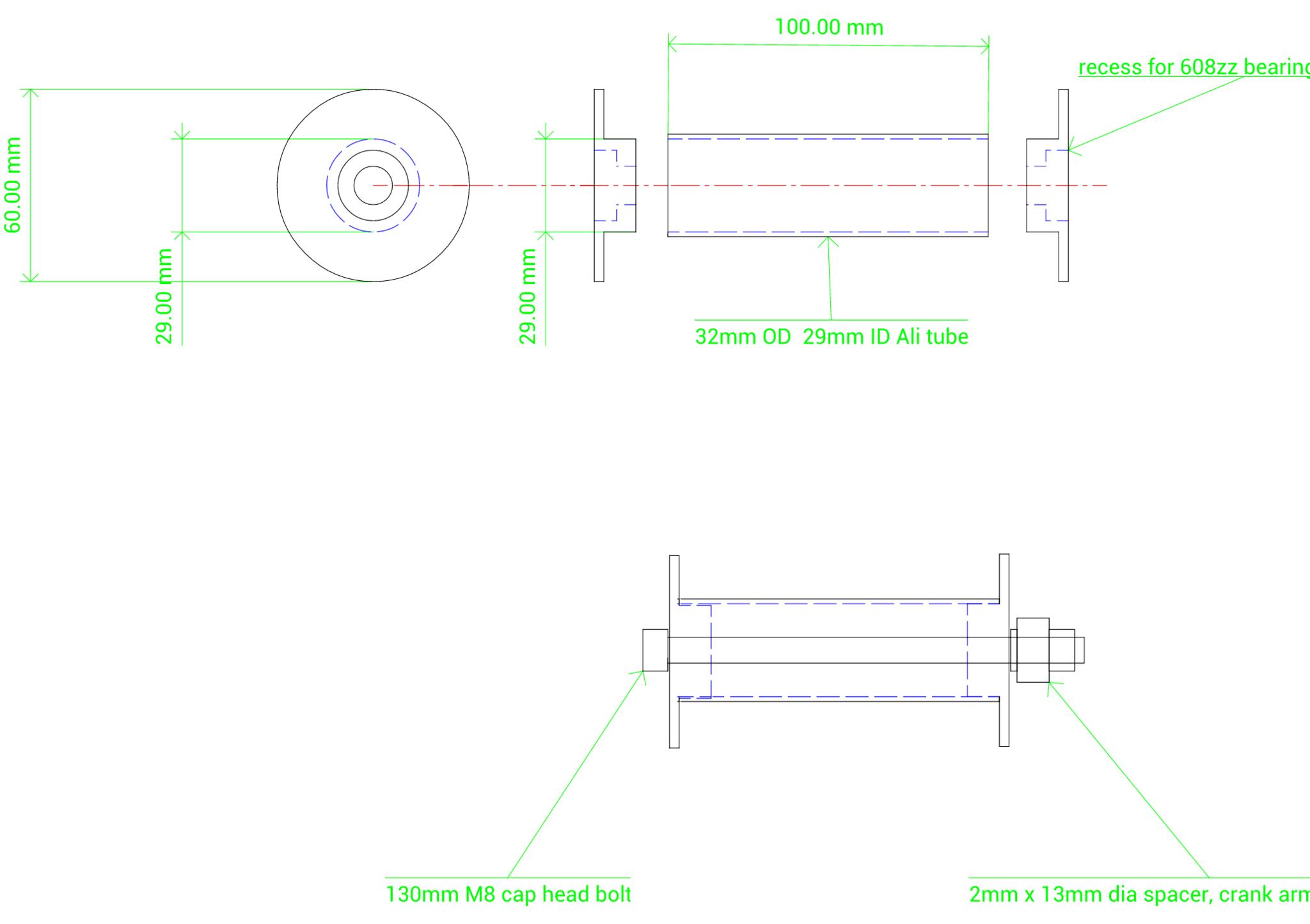

    Attached are some parts drawings for comment/discussion. Unless spec'd all parts are 6061 ali or similar. They are not final, in particular I am going to simplify the handle design/assembly and I've not done the load cell or Arduino mounting, or the floor mount arrangement. They were drawn using Inard CAD Pro for Android tablets For £6 its not a bad package and exports PNG, PDF and DXF.

    It looks like the radius of your disc at the center of the magnets is about 75mm, so at 60rpm that's 0.5m/s. You're going to need a high flux density in the aluminium disc to generate much force due to eddy currents at that low speed. It's annoying that there's not much information about the 500N electromagnets on eBay. I think we can work out the flux density at the pole face required to lift 50kg, estimate the reluctance of the magnetic circuit, then use that to work out the torque/speed characteristic. Another approach is I could model in FEMM, using the dimensions of the magnet and making an educated guess for the rest. Either way I suspect you might need either some sort of gearing between the handles and disc, a bigger disc, copper disc, or more electromagnets.

    The radius is 90mm and there are 4 magnets. Fully energised they each generate 1.6 Tesla (core saturated magnetically) at the pole which is 20mm dia. I don't have the B-H curve (as you found, no data sheets online, but then this isn't their intended use) but I'm hoping to be able to calibrate it. The air gap to the rotor is 1mm. I kept it this size as think getting it smaller will require too much precision in mountings.
    Now for some calcs....
    torque = sigma * omega * B ^ 2 * p ^ 2 * a * d
    sigma=rotor conductivity
    omega=speed rads/sec
    B = mag field Tesla
    p = effective radius
    a = pole area
    d = disc thickness
    sigma Al 6061 = 3.5e7
    omega =6.3 rad/sec (60rpm)
    p = .09m (200mm dia rotor, 20mm mag)
    a = 0.01m^2*pi = 3.1416e-4
    d=0.005m
    using an online calculator whose URL I cant find right now the 4 magnets @ 1.6T generate a total of 1.36T yoked in a 7mm air gap. Therefore
    max torque = sigma * omega * B ^ 2 * p ^ 2 * a * d
    = 3.5e7 * 6.3 * 1.36^2 * .09^2 * 3.1416e-4 * .005
    = 5.2Nm
    Power= torque * omega = 5.2 * 6.3 = 32.8W
    So will need to increase # of magnets to 8 x 40kg, or go to 40mm dia pole or increase rotor dia to 300mm to get to 60W. Also could consider some sort of epicyclic gear to rotate rotor faster e.g. 3 or 4 times but maintain it concentric to axle to minimise footprint.
    edit: 27mm dia pole (70kg magnet) and 250mm rotor gives 91W
    I did look at permanent magnets but the mechanical complexity of moving them and still measuring torque accurately got very messy (mechanical sizes were based on 3 pairs of 20mm x 10mm Neo magnets, I'd not recalculated based on electromagnets, my bad)

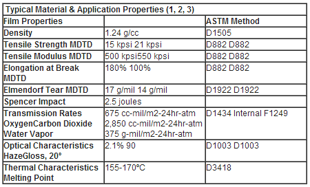

    That size wouldn't be a problem, resolution is quoted at 0.0125mm and accuracy at 0.1mm (Mono Mendel - RepRapPro). The current nozzle is 0.5 mm (best used with a 0.4 mm or slightly smaller filament thickness) but I've got a 0.35 mm one that just needs putting together for finer detail.
    Some material specs - Click image for larger version.
    Interesting PDF on designing for FDM (http://ode11.com/publications/sme_rp_2001.pdf).
    Because there is variable bond strength between the filaments, it's best to design so that the stresses are applied along the filaments but for things like gears that happens anyway since the slicer will trace round the perimeters.
    We could do strength tests before you commit to the design...

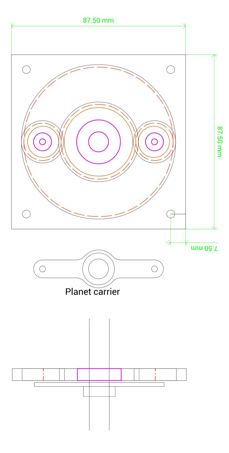

  10. Trying to work out how to draw the teeth for this in my CAD program, but attached is an initial sketch of the epicyclic gears.
    Current thinking is I basically want a mod 1.25 60 tooth internal ring with a couple of fixing lugs (the ring is static), a mod 1.25 30 tooth sun spur gear on a press fit 10 x 22 x 6mm bearing (this will be fixed to the rotor which will rotate freely on the 10mm axle using another 10 x 22 x 6 bearing), and 2 off mod 1.25 15mm planetary spur gears on press fit 3 x 9 x 5mm bearings (these will be fixed to a carrier thats connected to the 10mm axle ). Spinning the 10mm axle will spin the rotor at 1+60/30 = 3 times the rate or 180rpm. the torque in the gear train is around 6Nm
