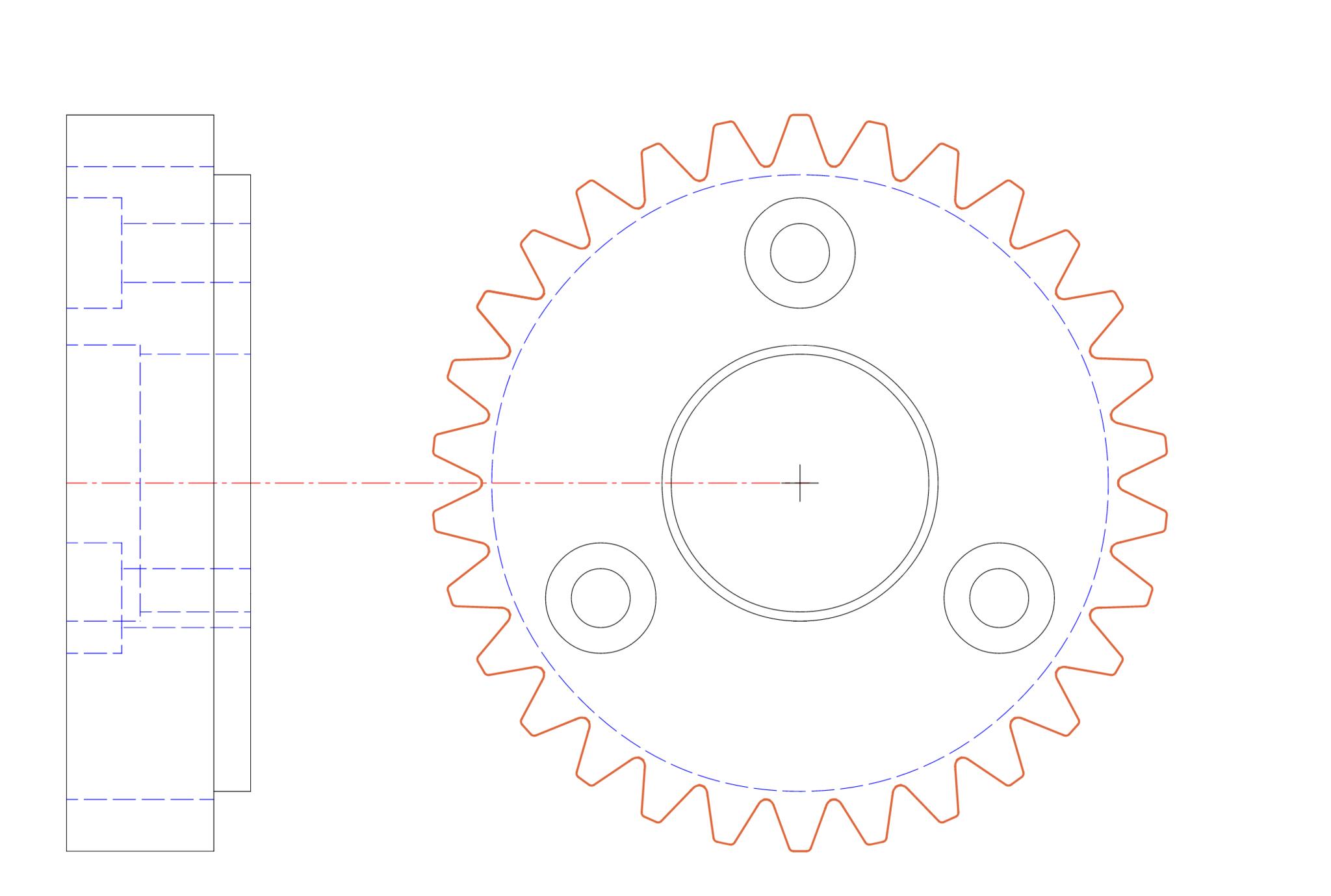

    OK. Attached are image and DXF file for the 3D printable modded sun gear and rotor boss which now include a seat for a 15 x 10 x 4 magneto bearing. these go either side of the rotor and are joined by 25mm M3 cap headed bolts and captive nyloc nuts. Are these printable?
    Crudely each contains 1.25e-5 cubic metres of material, which means 0.02kg of PLA

  2. #32
    Shouldn't be a problem to print those.
    The new slicer is better, both finish and sizing.
    I'm trying to put something together for some destructive testing now :-)
    Don't worry about the plastic usage, I've got loads in (as long as you're not too bothered about the colour).

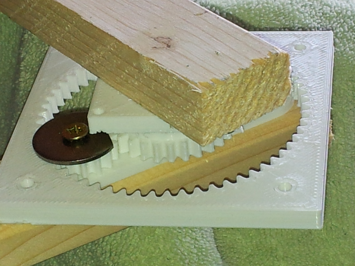

    Attached picture shows the (very crude) test rig - current limit is the stiffness of the ring gear - it bows out under pressure and skips. I'm printing one with a thicker outer now.
    I've also got some issues with the first layer being oversized (the slicers tend to make the first layer slightly thinner to get good adhesion to the bed by squashing the plastic between the head and the base) which should tune out but which would be very easy to fix if Alibre was man enough to let me put a chamfer on the teeth :-(

  5. Looks good tho :) Are those full thickness?
    When you say the ring gear 'bows out under pressure' what exactly do you mean? I've changed the design of that, see attached. It will be bolted to a pair of 10mm sq ally columns which will add considerable rigidity.

    Yes - that's full thickness (6mm).
    The majority of the deflection is where the gear is closest to the outer edge of the piece - the straight edges by the gears become convex and the ones on the side away from the gears become concave - it moves enough for the teeth to slip over the tops. Moving to three or four planet gears may be a simple way to alleviate this without having to make the ring gear much stiffer. Your new design will also be somewhat stiffer - is there much room to play with?

  9. #39
    A couple of complicating factors - I forgot to say that the part is printed with 30% infill to save plastic so it's not as stiff as it could be (there are three solid layers on the top and the bottom (1.1mm) and on the perimeters (1.5mm - I'm extruding filament 0.5mm wide and 0.35mm thick)) and the concave bending of the sides away from the planet gear effectively doubles the deflection.
    I tried the new ring gear (still 6mm and 30% fill) and it moved but didn't skip (at moderate loads - see below) so I don't think it will be an issue - more something to bear in mind for any future modifications - I'll know more when I've managed a proper load test.
    Testing at 2KG/metre resulted in a broken gear carrier and splintering of the wooden batten attached to it so they need to be improved next - I might make an aluminium carrier as I've just converted the milling machine to a CNC-USB controller but haven't cut any metal with it yet :-)
    I think I've pretty much tuned out the oversized first layer problem by putting a slight relief on the side of the teeth next to the bed - the 15t gears look good and the 30t isn't far off - same technique should work on the ring gear as well and has improved the feel of the gears quite a lot.
