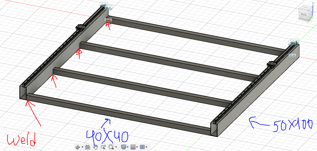

    The table will be made of 40*40 box section profile with 1.5mm wall, partialy welded and partialy bolted (so i could move it later)
    For the frame - ontop of the table I plan to use 100*50 RHS steel profile with 3.2mm wall - (two beams under the linear rails) in between them i will be welding 40*40 box section supports for the spoil board. also the two beams with bolts to the table.
    for the rails i plan to use 20mm HGR linear bearing

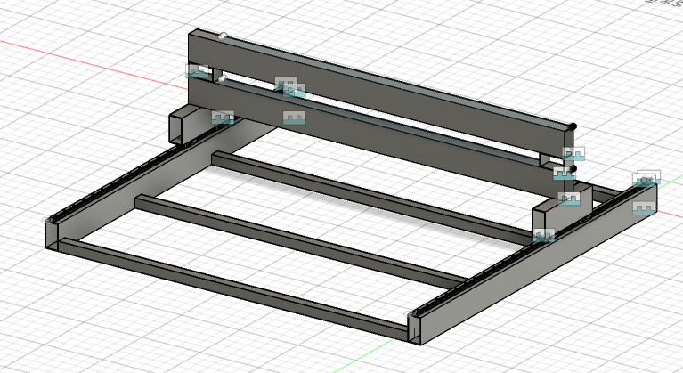

    For the gantry i plan to use 300mm 50*100 RHS on witch the catridges are mounted and those pieces will be welded to the Y axis beam made of 2 beams length of 1500mm and 100*50 RHS
    and here the deflection (bend and twist) should be less then 50 micrometer

    1. To get the X axis flat and coplanar between the two beams i have seen lots of methods but as i sayed this is a poor mans build - i dont have access to precision grinding machines and using a dial - i dont have reference flat surface... so what other methods can i use?
    2. The X Frame will be welded to get more stiffness - although the steel can get twisted - how can i plan my design to compencate for that later?

    i have added some screenshots:

    the red arrows shows where the frame will be welded and the steel dimentions, i intend to use 2 types of profiles: 50*100mm with wall 3.2mm and 40*40 with wall 1.5mm

    One option for leveling is to use low viscosity, slow setting epoxy (such as West Systems 105 resin and 209 slow hardener) on top of the beams. Search the build logs and you'll find several designs that discuss how best to do this.
    i think i wasnt that clear about my design - so i sketched something to explain it alittle better (in the meantime im working on somthing more detailed)
    any way i will not be using no i beams or H sections but regular rectangular hollow section steel tubes dimentions of 100*50*3.2 and 40*40*1.5
    for the epoxy method i have seen some builders use that method - but are there any other methods?

    Think I've told you this in another thread but those tube thickness's are not a good choice, esp the 1.5mm.
    Regards methods of leveling then if you don't have any way to check the rail plane then you'll be better using the epoxy method as it gives the best accuracy for a large machine without needing a reference surface.

    The calculator is correct for ideal conditions, perfect joints, and does not include vibration. So it is just a guide and great for comparing relative performance but real deflection will be a bit higher due to factors not included in the calculations.
    I was the guy who wrote up the "AVOR" design as mentioned earlier - which has proven to do a decent job for me even if it looks like a disaster area.
    However, one of the main things I would change if I were doing it again (and I don't have plans to do that anytime soon) is to go up from 3mm wall thickness steel box to 5mm. When cutting harder materials especially there is a certain amount of resonance/vibration that you can feel as a buzz through the whole machine. May not be needed for strenght but just simple mass. There's a reason why commercial milling machines are made of cast iron - yes, rigidity is one reason but simple vibration damping is another.
    I can only think that 1.5mm is going to ring like a bell!

    As i wrote in the original post i want to do a simulation of that and realy understand the problem (may be i could dampen some spots and it will be enough?) But as you can see im still learning how to use fusion360 and havent yet made a normal model to simulate
    As for deflections - as i wrote i tryed to use the calculator i mentioned above and in the ideal world the total deflation should be ok as far as i understand the results of the calculator
