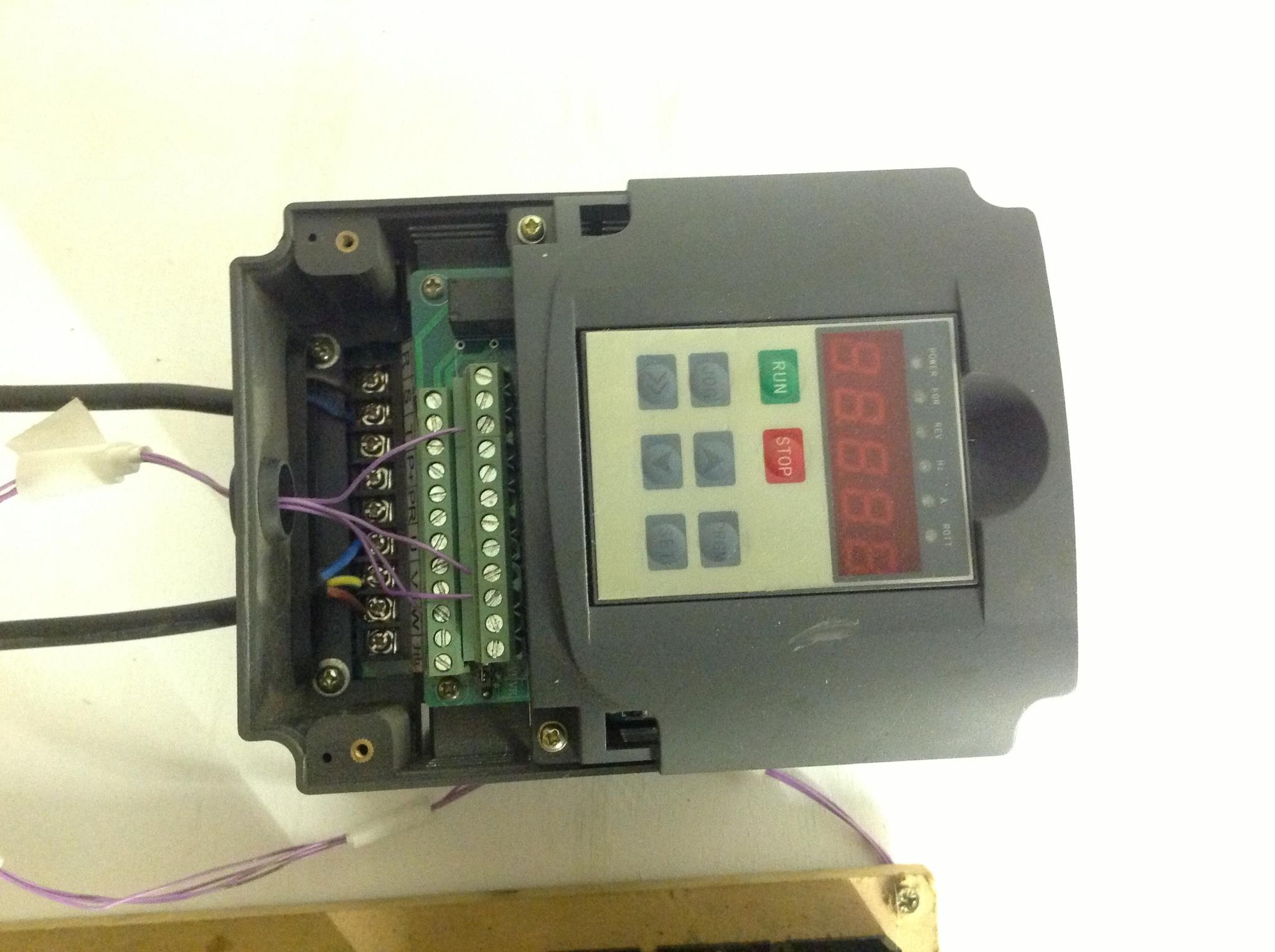

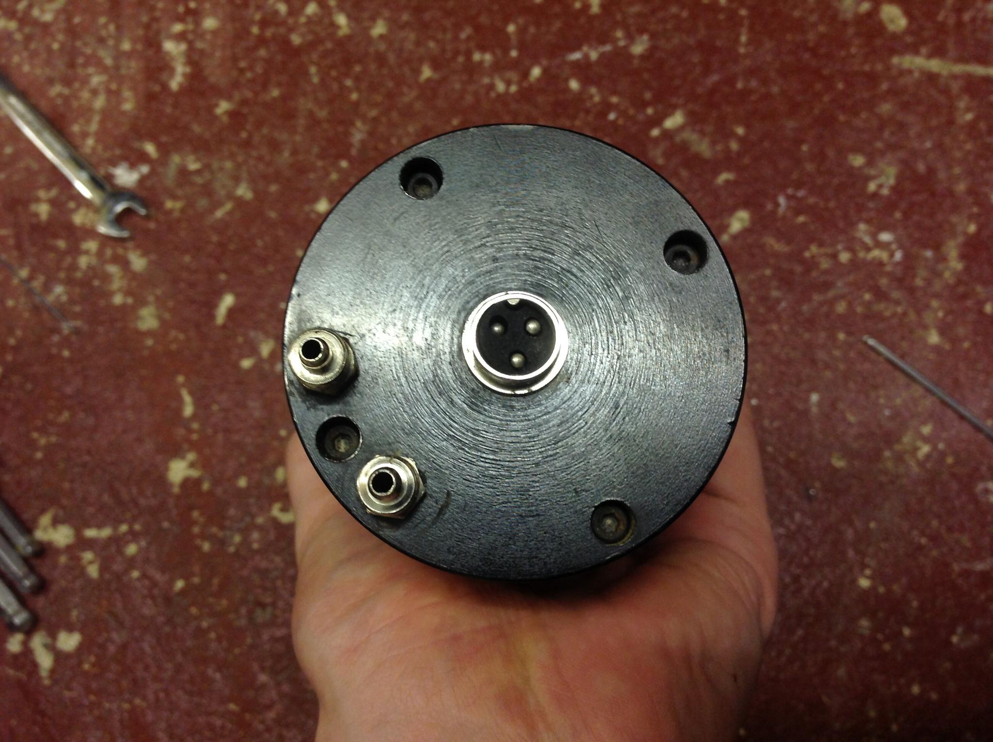

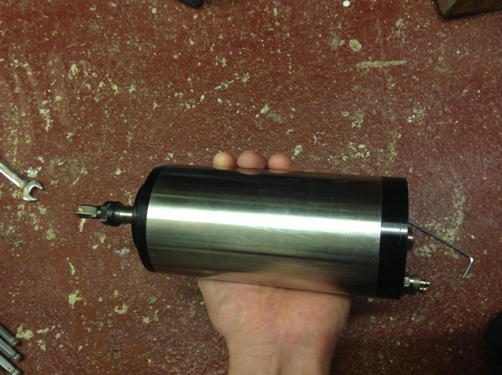

    Hi Jim
    If you post some pictures of your VFD it may be possible to identify it and source manual for it.
    Kn8
    The min was 20000 and max was 24000. I changed this to min 0 and max 22000 so could test different values.
    Quote Originally Posted by Kn8 View Post
    Hi Jim
    Kn8
    Thanks Kn8, here are some pics of the vfd and spindle.

    Edit:
    Just found the front cover for the vfd in a box of bits! It doesn't have a model number but it does say "240v 1.5Kw".
    I've had this thing for over a year and never spotted it, what a spanner!
    Kn8's Avatar
    Location unknown. Last Activity: 10-11-2014 Has been a member for 9-10 years. Has a total post count of 58. Received thanks 1 times, giving thanks to others 0 times.
    Jim
    That looks like a Huanyang Inverter I have sent you a PM.
    Kn8
