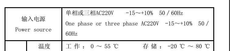

    I am at the point of buying the same servos. At the manual it states it works both on one phase and 3 phase, but nothing more. By the way if you don't have the manual i can mail it to you.

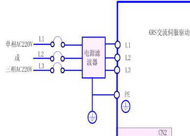

    Hi just send you the message with the manual. I believe there is should be enough capacitance and the drive to be prepared for the single phaze.

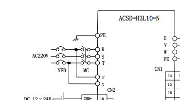

    Look at the snip from the manual below and from another similar Chinese drive:

    It seems the connection should be between L1 and L3/ judging from 3rd picture where they are named R and T/- i mean the phase and the middle one to be 0.
    But dont trust me on this, just open it and see whats there and think

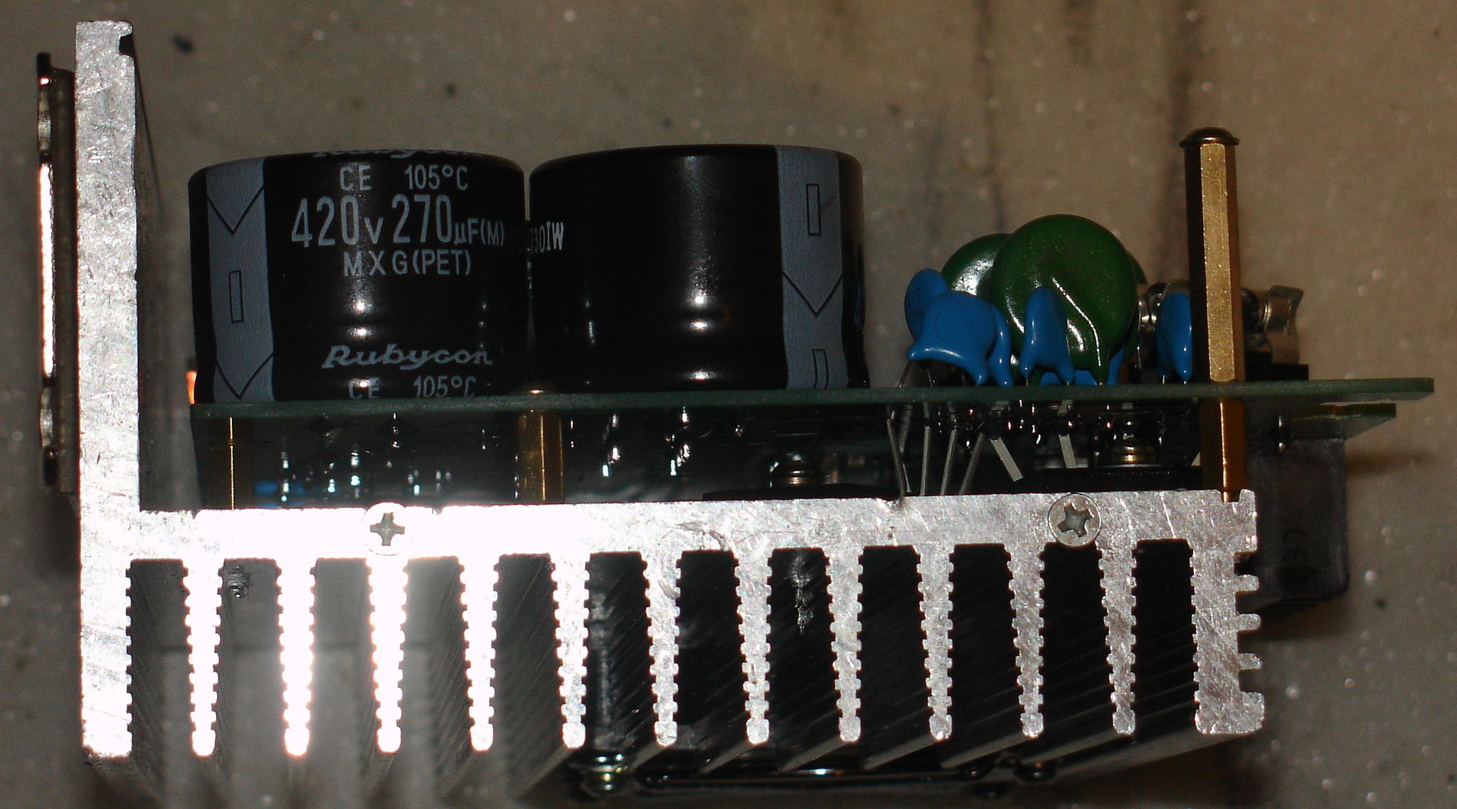

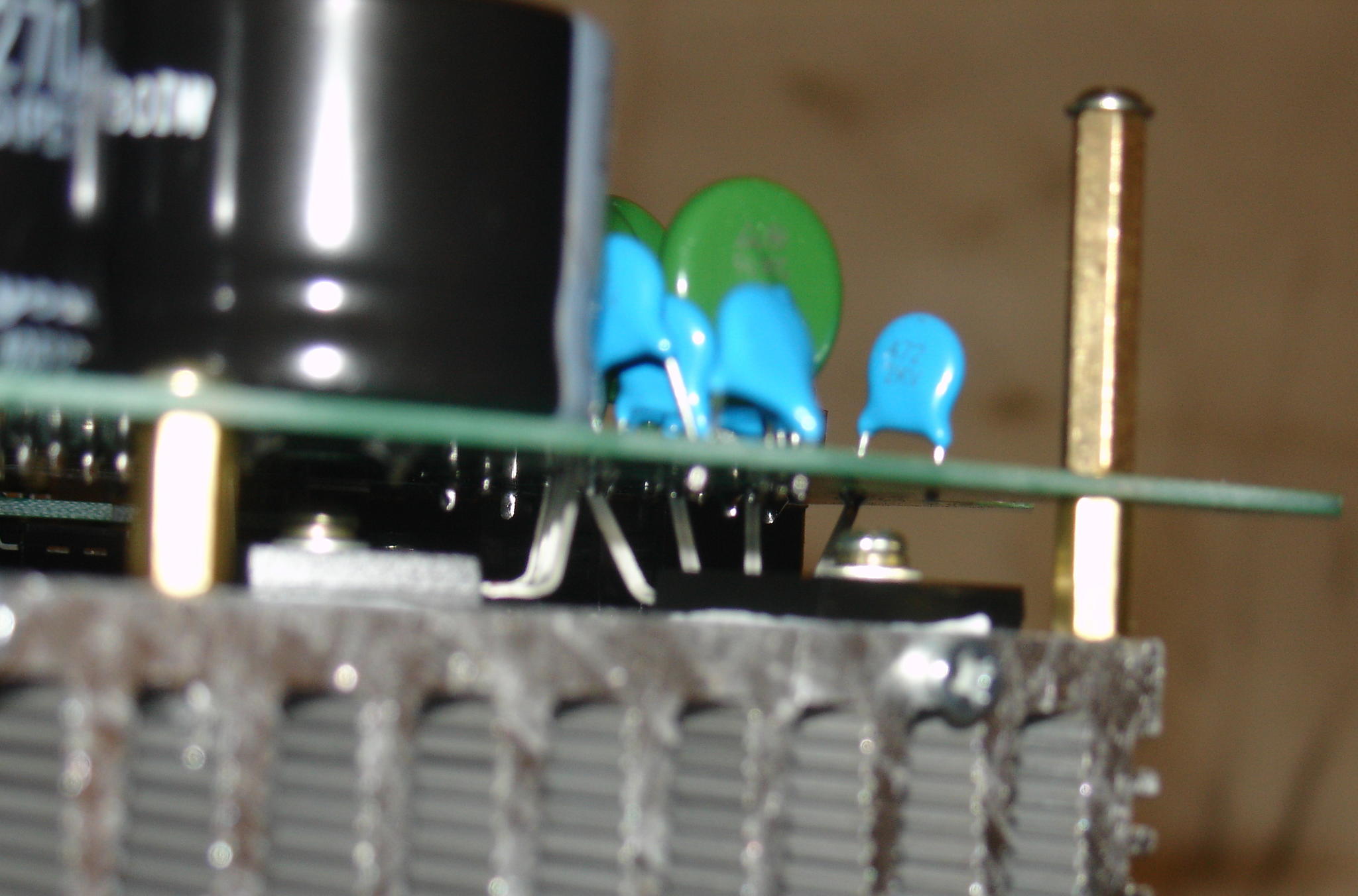

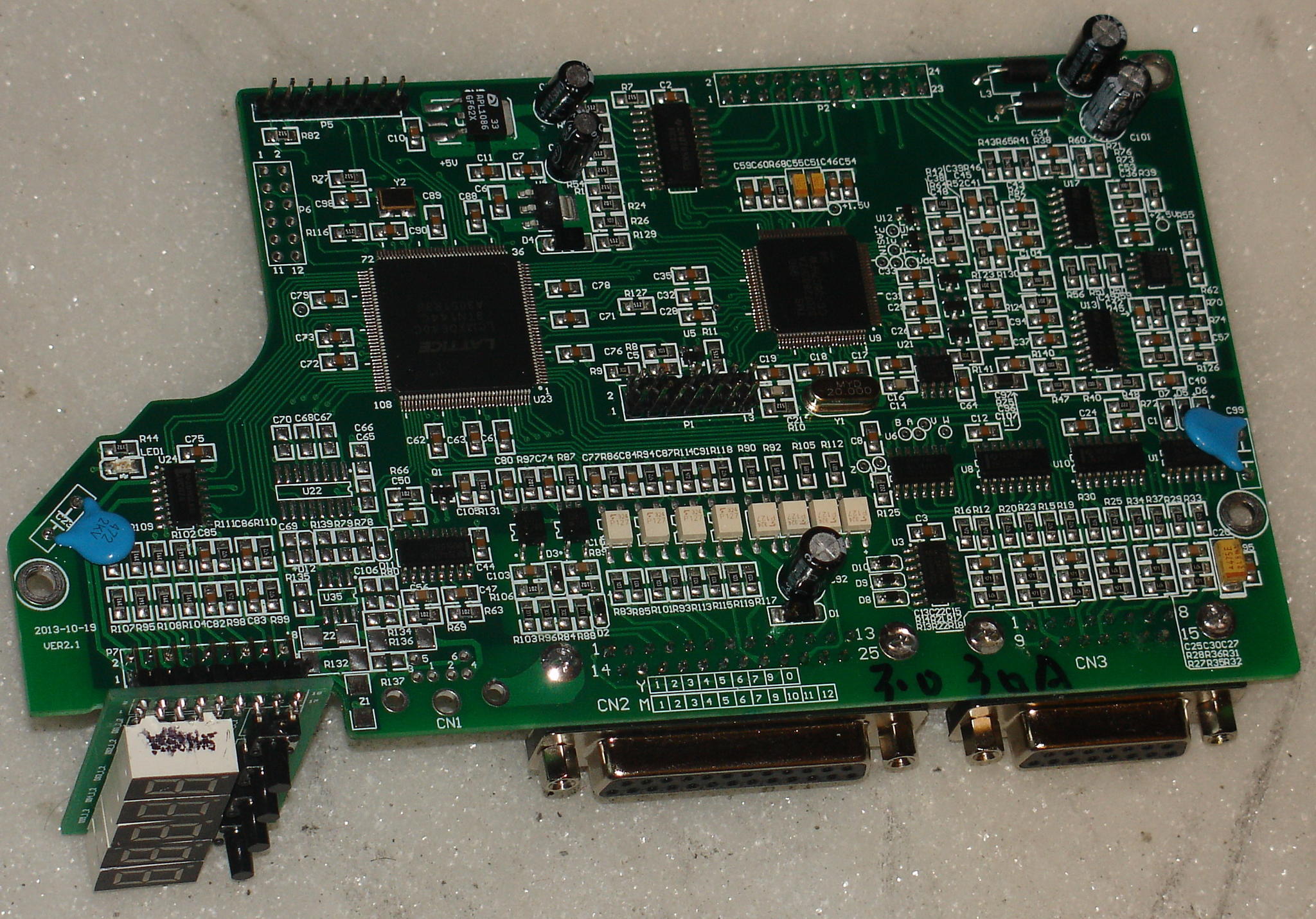

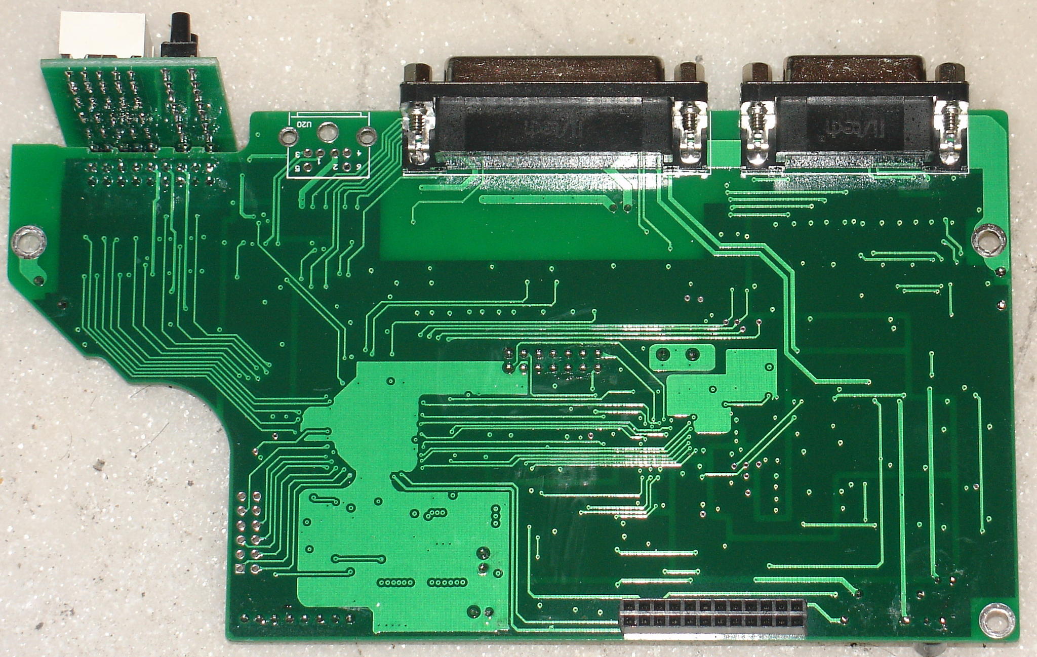

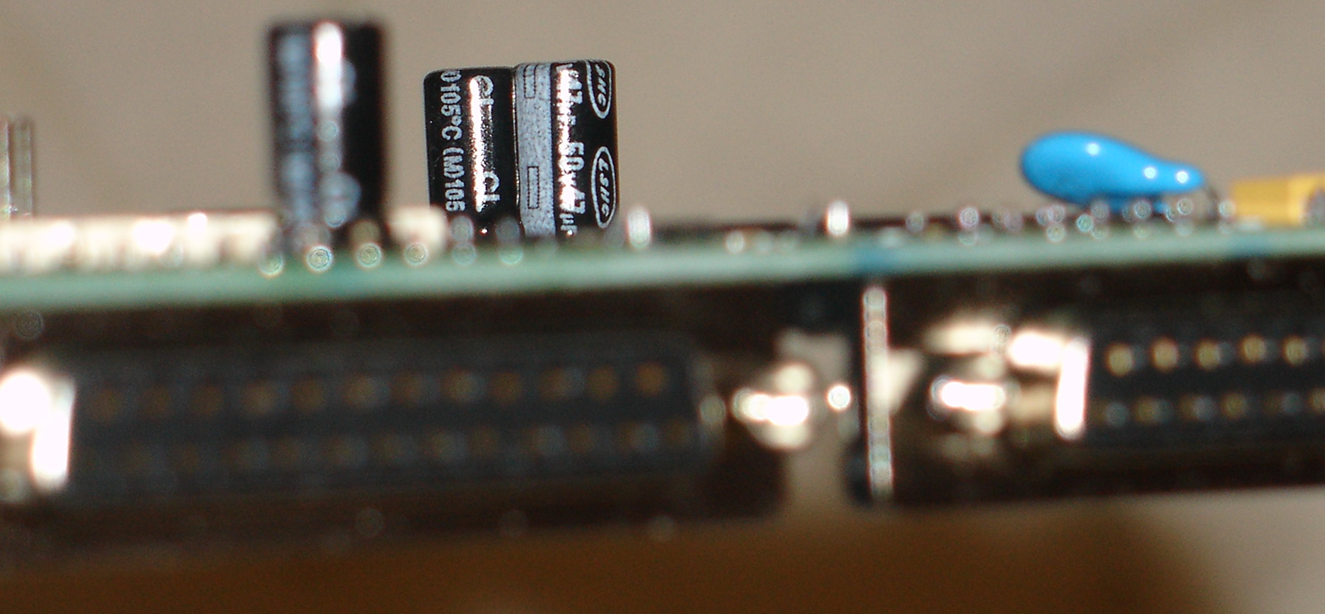

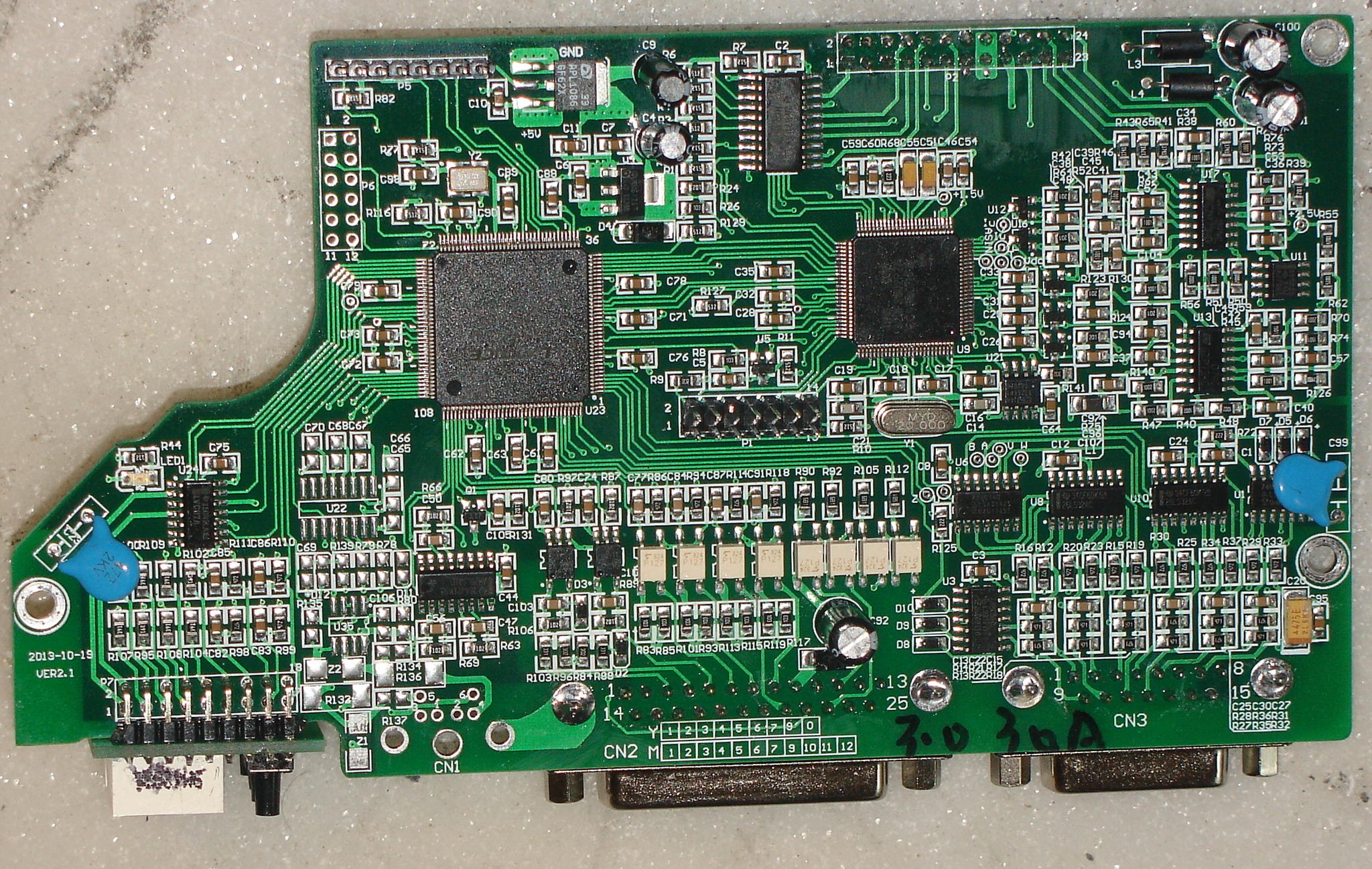

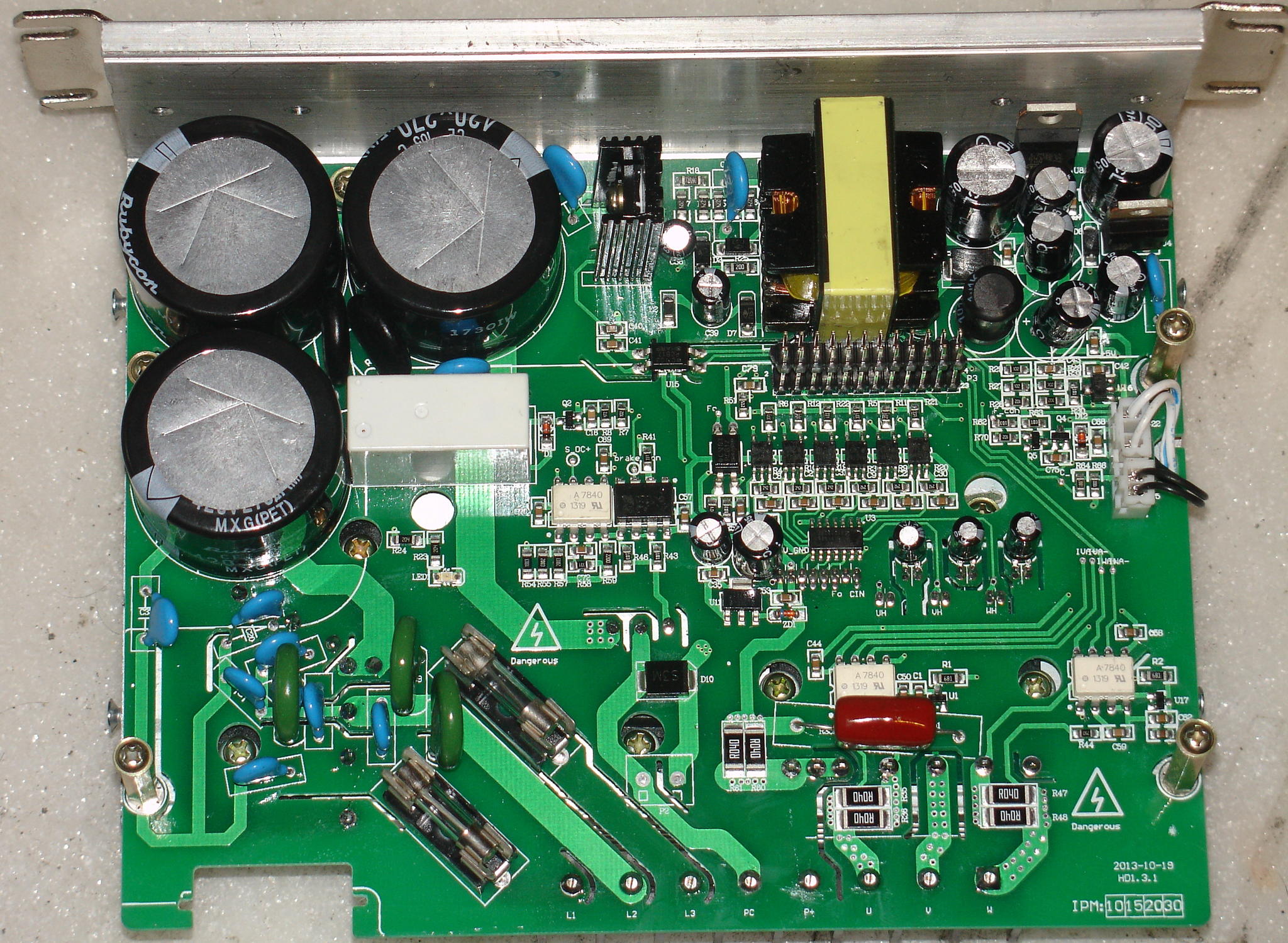

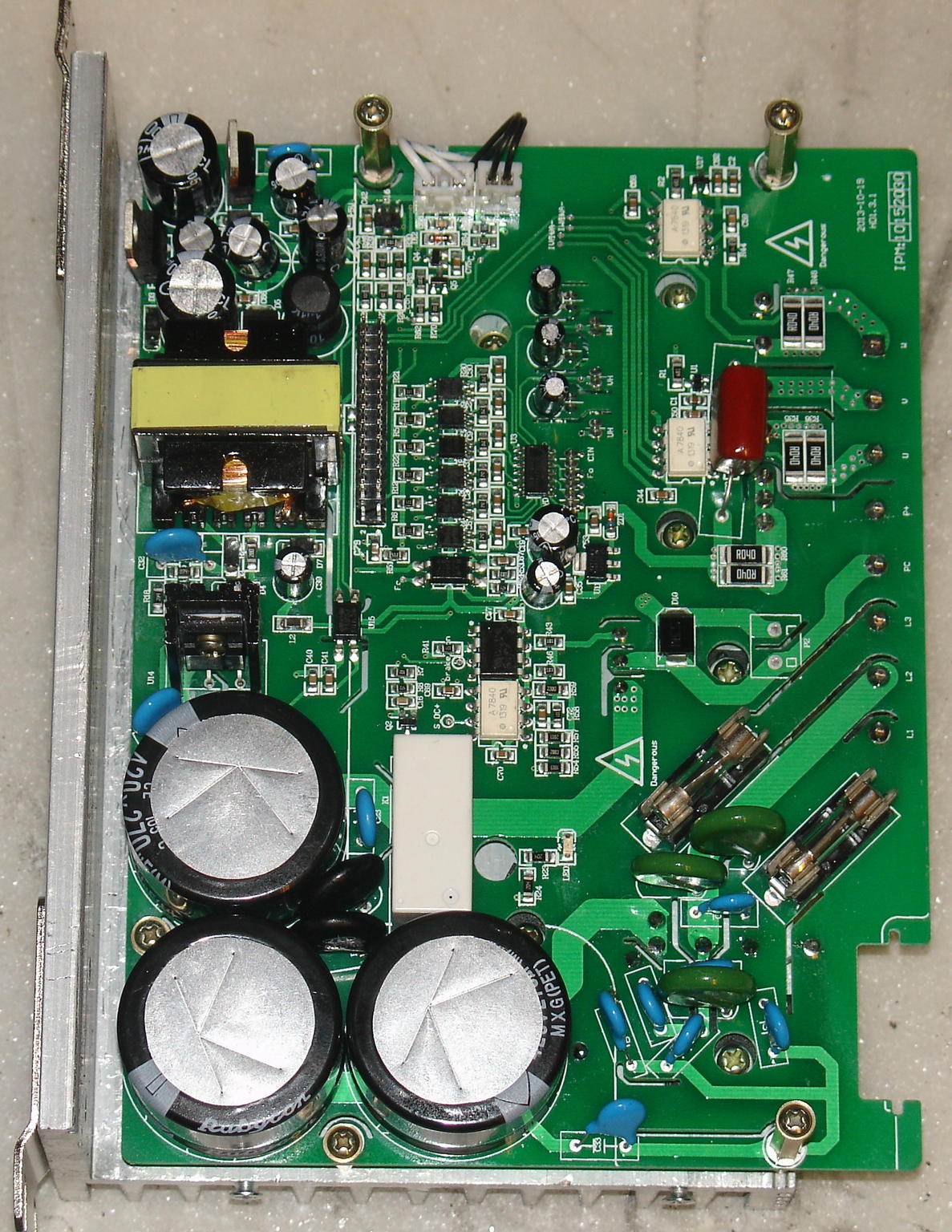

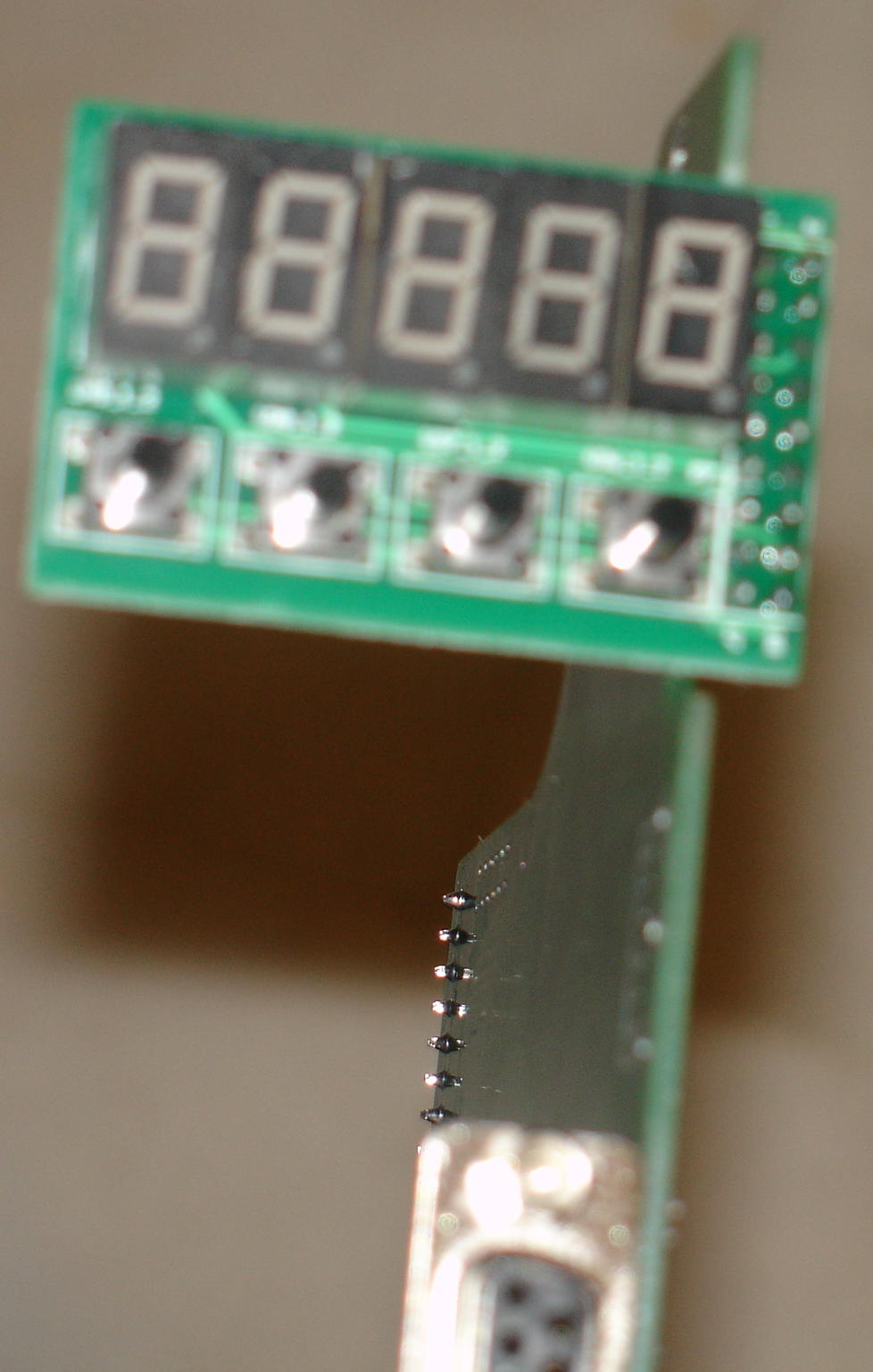

    Some photos of this drive:
    (You can see the big smoothing caps, the 2 rectifiers which are down from caps also you can see that pcb supports
    CN1 connector but missing this connector and some smd components near it.
    I believe that is rs232/485 connector. Has someone schematic to add the extra components ? )
    Fred from BST automation / Aliexpress/ send it to me as i am at the point of buying from him the major mechanical and electrical components.
    I am not sure but it seems from the 1st photo that L1 and L3 as i suggested are where the phase will go, judging from the fuses. But when in doubt i go to a local electronic repair shop and for 1 min the guy solves my doubts with advice, so that will be the wise choice to do.
    I believe they should be Mitsubishi most possibly. But- bear in mind that every copy is a thing on its own, just use the manual i send you. yeah, i know, the crappy Chinese English translation.

    I followed the pcb traces in AASD-30 servo driver and made a simple schematic
    Also in CN1 connector the missing components are:
    R78
    R79
    R80
    R132
    R134
    R135
    R136
    R137
    R139
    C65
    C66
    C67
    C68
    C69
    C70
    C106
    D11
    D12
    Z1
    Z2
    U22 -> 16 PINS
    U35 -> 8 PINS
    CN1 -> 6 PINS
    Quote Originally Posted by rnr107 View Post
    Now, there is nothing in there requiering a phase shift between the 3 phases coming in....all the bridge rectifiers care about is 240V AC...
    So, I decided to connect Neutral, Live, Live where the 3 phase were supose to go (L1, L2, L3)... This way the load is spread over the 2 briges as per 3 phase setup.
    Tryed that this morning... All good! Motor happy, drive happy... (all stays cool )
    Laurent

    Not that i am an expert, but common sense tells me that by the way Lauren connected his drive he achieved nothing more than using only 1 rectifier, assuming his drive has similar schematic.
    From what i see the way to use the 2 rectifiers will be to connect /phase and ground/ to each rectifiers 2 legs /s and s / in parallel which means the rect 2 s and s inputs MUST be un soldered or the path cut with exacto knife so that they are not together
    It probably will work without problem with 1 rectifier.If is not possible to unsolder the rectifier legs or split the path with exacto knife, having in mind that on ebay are selling big heavy duty rectifiers for dirty cheap, just 1 bigger rectifier and forget about connecting the second.
    PS. Dont mess adding components, what is written on a board and is missing, does not mean you can add it without understanding what you are doing.
