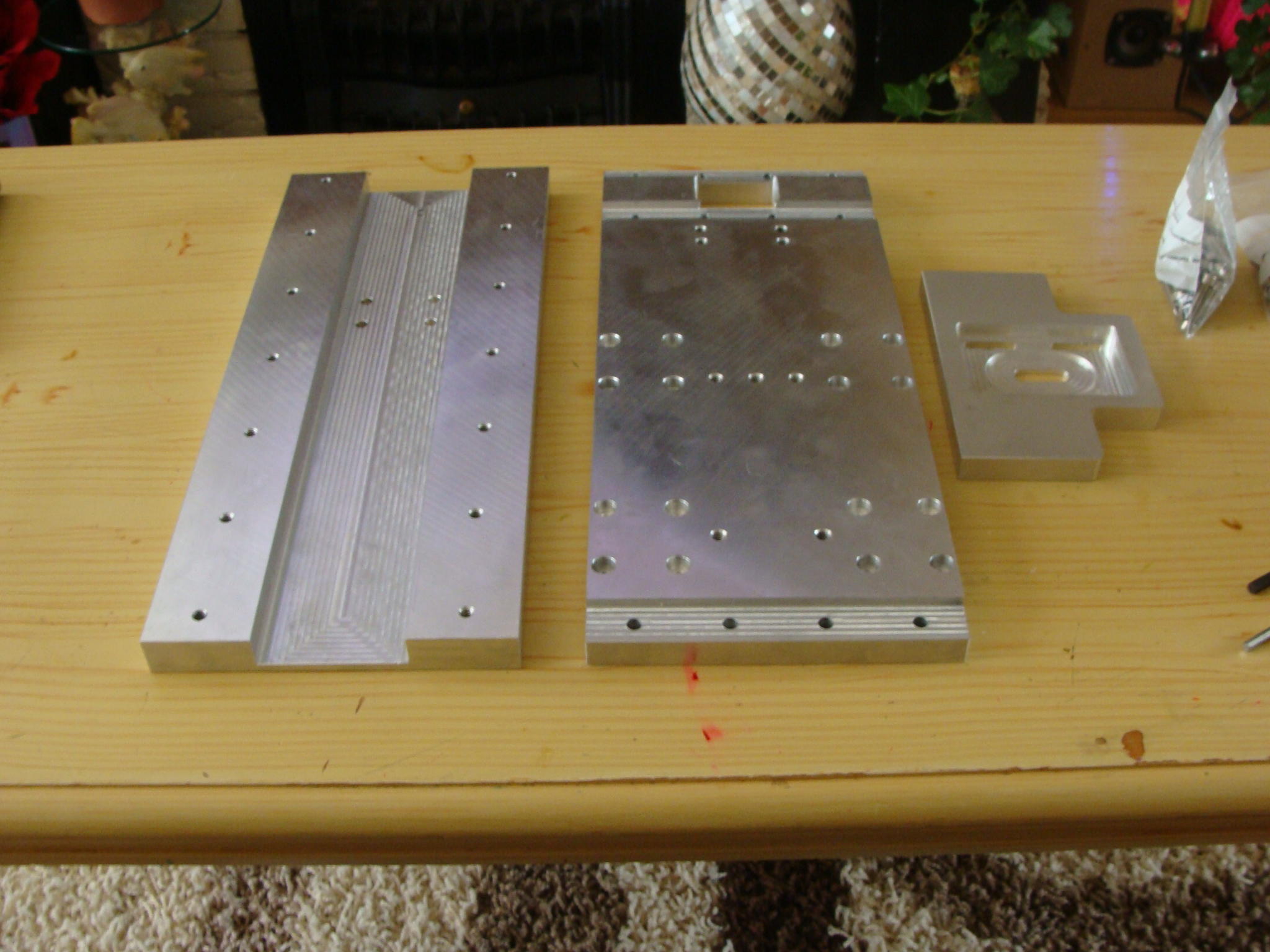

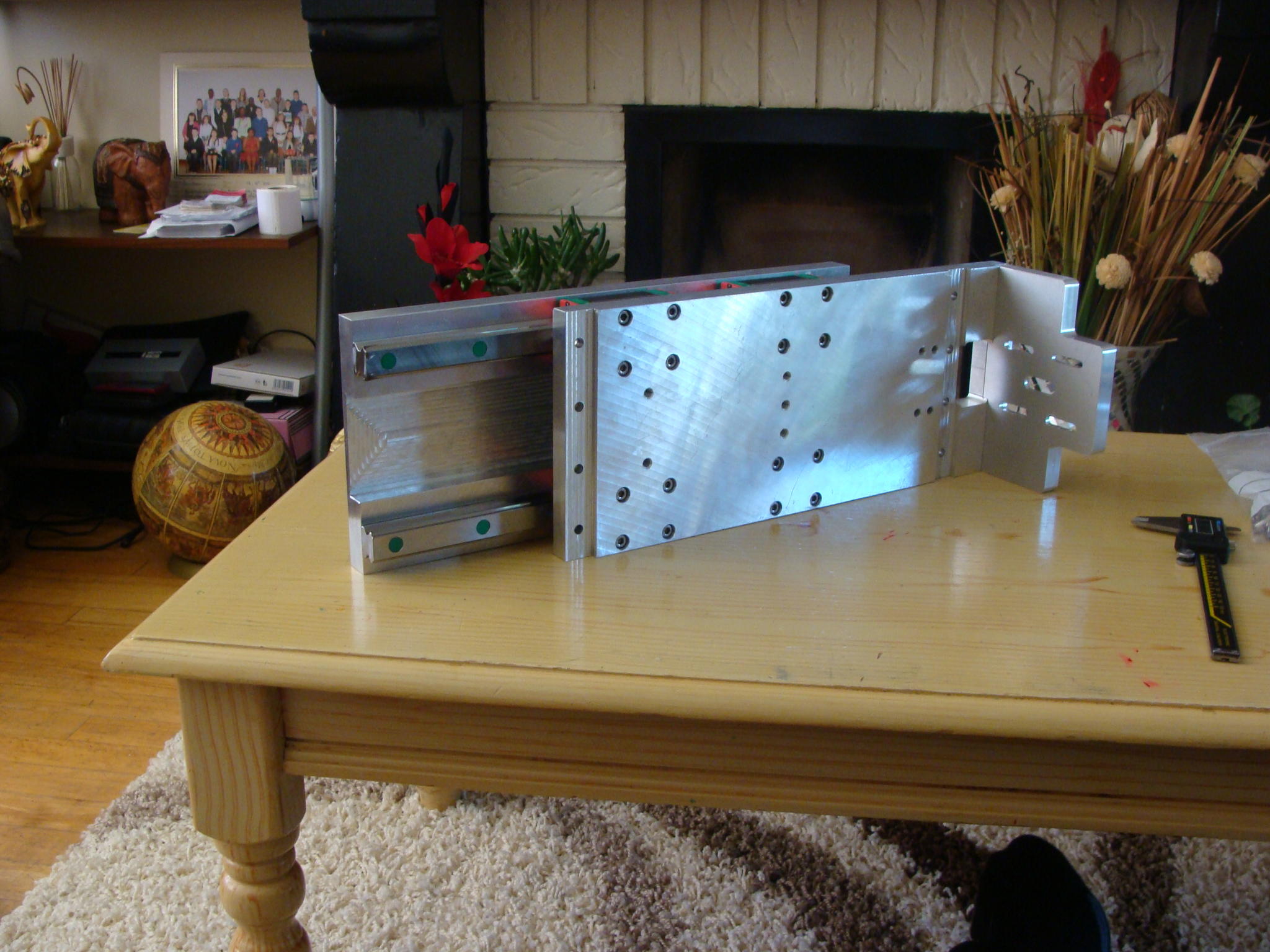

  3. #33
    quick update,
    received yesterday parts for the Z axis from JAZZ CNC
    well.., what I can say.., he is a real man !
    I'm impressed with the quality and accuracy of the parts! Thank you Dean!
    My next step will be steel frame construction , I waiting for the chop saw speed regulator (I want to drop RPM of my saw) and welding mask .
    I hope to see you soon?!

  4. #34
    Your Welcome Gytis pleased they got there ok and more pleased those holes are in correct place.!! . . . Always worrying when you haven't got rails in your hands and working to someone else drawings. . .Lol . . .You did good too my friend.!
