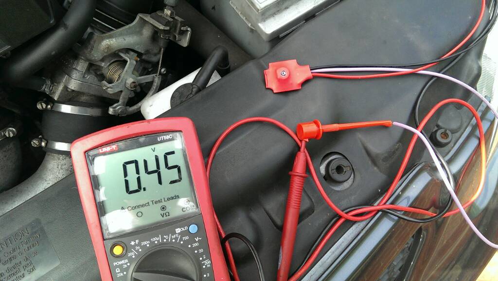

  1. Is it critical for the value of the zener diode as I can only get my hands on a 2.7v jobbie today

    No, but a higher voltage zener will mean the potentiometer will be working a bit harder.
    Not really, your output voltage will be 0 - 2.7v rather than 0 - 1.5 so trimming it will be slightly more fiddly.
    I'd set it to zero and connect it up and then bring it up to the voltage you want - this will negate any effects due to the load the ECU puts on the potential divider.

  6. It's for a Toyota Corolla Compressor
  7. Well works like a charm on the meter so now to plumb it in.
