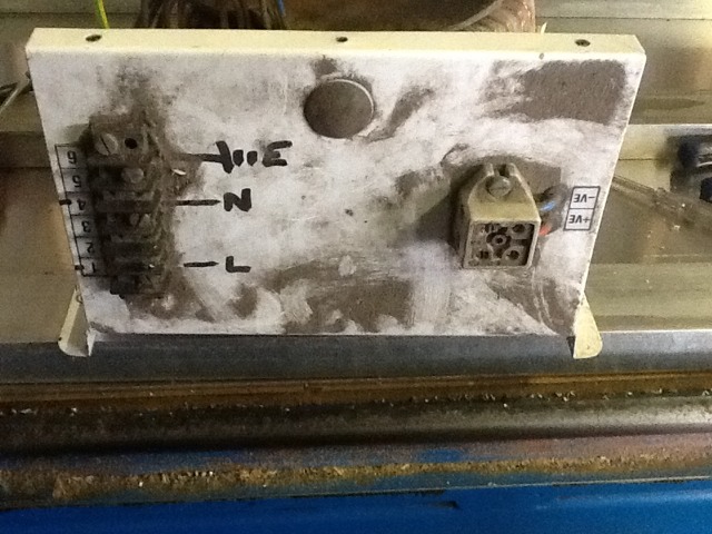

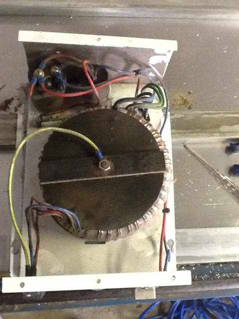

    Hi guys heres a couple of phots of the motor under the table that i thought was for the pump, does anyone know how this should be wired as the is no input indication on the end, thanks for the helpClick image for larger version.

    Well to me its looks like the red and blue wires is going to the square block and that is your DC out +ve and -ve at the other end is mains AC in where it is marked L and N but the earth seems to be connected to the bolt that is going through the centre of the transformer and if here is a metal plate on top it could be causing a shorted turn in the transformer. that needs checking out.
    One other point is you need to check if this was wired for 110V or 230V before use and it need a good clean up with new connection block fitted ...Clive
    This is not a motor it is a power supply

    That's a DC powersupply.
    Before you stripped the electrics, did you take a note of where the router was wired previously?
    I'm wondering if somebody had just wired it into the 240 previously...
