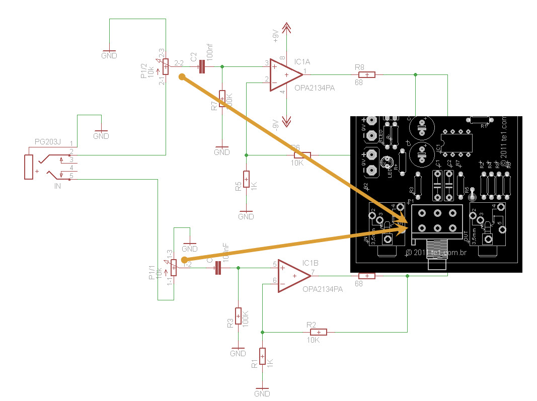

    Basically on the schematic there is one opamp and one Pot , I’m trying to replace the pot but its on the schematic somehow dynamically linked to the other. So its shows two pots but there’s only actually one, I’m trying to figure how you do this anyone any ideas, I’ve done the google thing but I don’t actually know what to ask in the question.

    Hi Bubba , no thats not actually what I mean. :) take alook at the picture. On the board there is one Pot on the schematic there are two mirrored, if I delete them both then replace them, on the board picture I get two pots. It’s the same amp repeated on the schematic I’m trying to figure out how this is done. I want to be able to replace both pots on the Schematic and only have 1 pot on the board.BTW i didnt do the original thats why I dont know how they did this.

  4. They are two halves of one dual pot package. you need to choose a part that contains two pots in the same device. Eaglesoft knows this, just like it knows that a dual or quad op-amp is 2 or 4 elements in one package. If you replace them with individual pots you will get two on the board.

    As Irving has said, that part is a dual gang pot.
    That's what you've got already....two separate pots on the schematic but just one physical(dual ganged) pot on the board...clearly you seek something else so this must be a terminology/explanation thing!

    Thanks irving that makes sense , theres no dual pot in the parts list for the alps but there is enough of the others to make on from scratch or coble them together to make a new part :)

    yeah I found a duel element pot now, but its not switched so Ill have to take that and add a switch to it.
