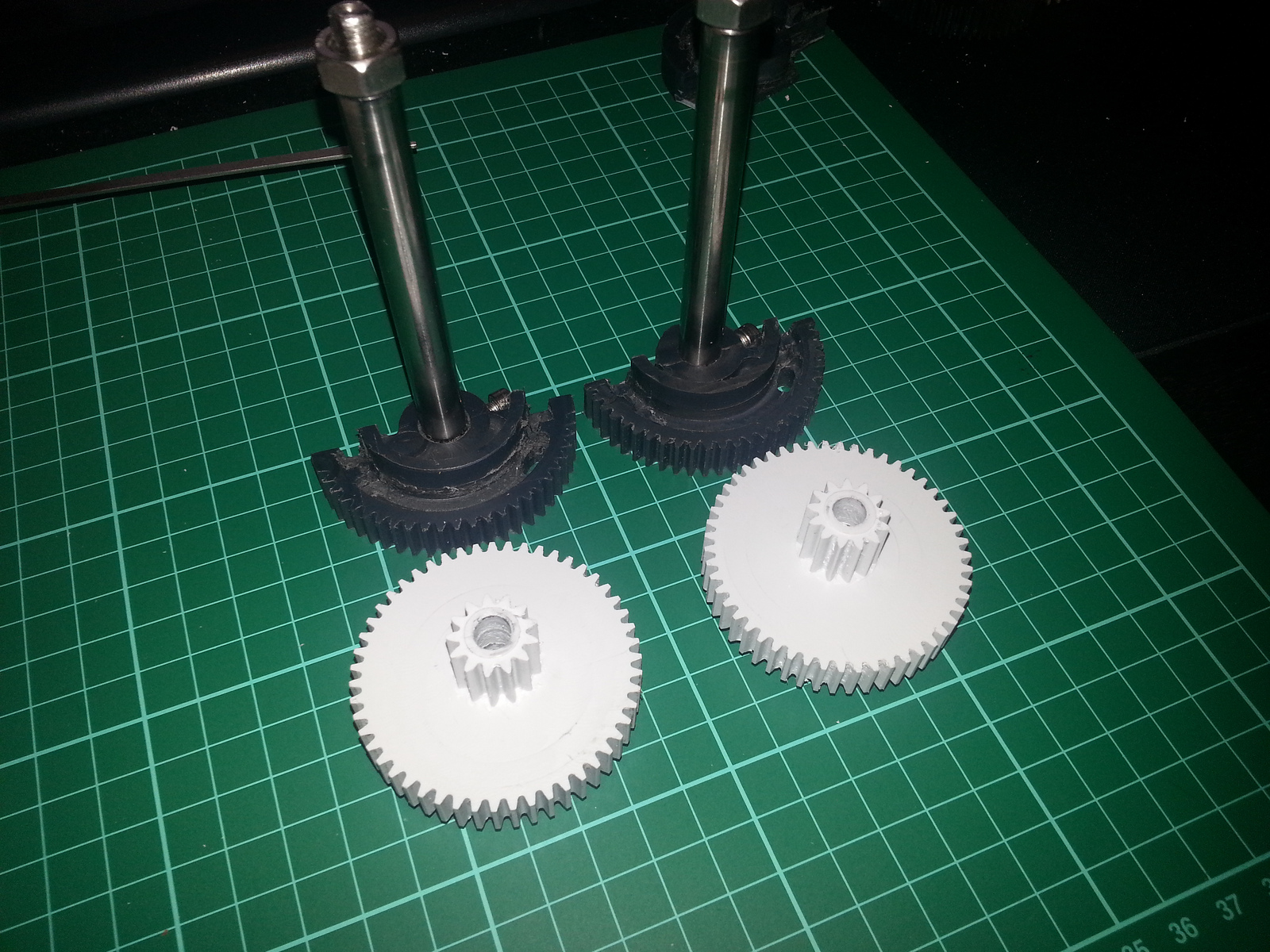

    So it looks like my gears that I am cutting on my DIY mill are becoming more popular and I need to find ways to machine quicker / better. Currently the bane of my life with cutting gears is the changing of bits and that I am using a Kress with not the best runout values (and not enough speed control).
    Please suggest me something that is decent, not too big but still powerful enough (I mainly cut plastics and brass) - but that has the ability to have 4-5 bits assigned that can be automatically changed and autoleveled ready for cutting without my interaction needed ...

    Thanks - am starting to look at other methods to machine these - bought a small lathe - might be able to take the gears down to a certain size and then mill the teeth. The semi circle gears however need a lot of work and need a few changes made to the tooling during a cut. I dont want to move the part once it gets machined - I struggle to get them back to where they were with the correct precision - perhaps I need to look at that again, biggest issue I have is stock holding and placement - main issue anyways.

    Thanks, no, only 3.
    Here is a pic of the gears im doing.
