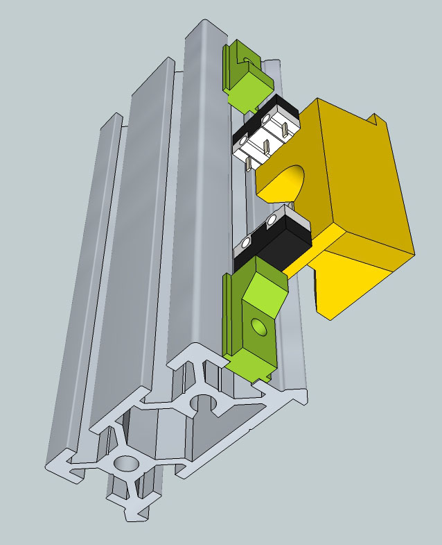

    Hi, would anybody be able to make / mill these:
    Z limit switch holder RH.stlZ limit switch pusher.stl
    I need two of the pusher and one of the mount, could it be milled out of alu / plastic? or would 3d printing be the best option?
    Thanks for looking

    Hi this it what it looks like :
Name:	Z limit switch.png
    the dimensions are in mm, 48.98x20.8x21.1 and 9x8.5x18
    I have printed these off as to see what they are like but do you need those bits that stick out on the side of the pushers 3D printing is not good with overhangs so they have to be printed vertical. I think the model could be improved for 3D printing.
    If you pm me with an address I will send you them foc. Clive
    If you are regarding the black bits on the above picture then no, they are the micro switches?
    Thanks everybody for the help
    I was referring to the lugs on the side of the green bits. If they were not on i.e. square it could be printed flat and it would be a better print.

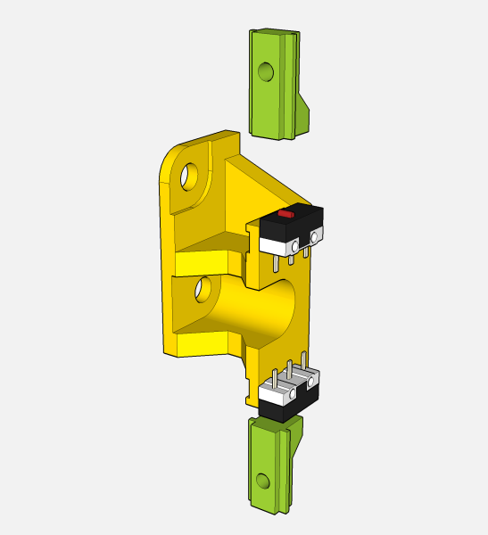

    yes they are needed :( but could be tapered i guess - see this image showing them in place:

  10. Just my 2p worth...
    I'd consider modifying your design to put the switches horizontal and use roller lever operated by the green bits as a cam. The way you have it relies on the carriage stopping fast enough not to overstress the switch. Hitting the limit a few times could compromise the switch reliability.
