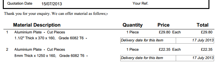

    My last order with ASC was £174 with VAT total. Here are the first two lines:
    Put the same sizes in the aluminium warehouse site and it's £8.39 more, plus delivery at £12.49 so that's £20.88 saved. I'm happy to make a 5-10 minute phone call to save 20 quid!
