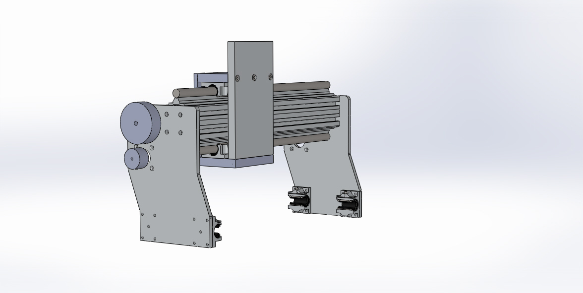

    so for starters we have the gantry... i will be working a little more on it today along with the frame

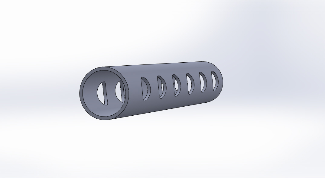

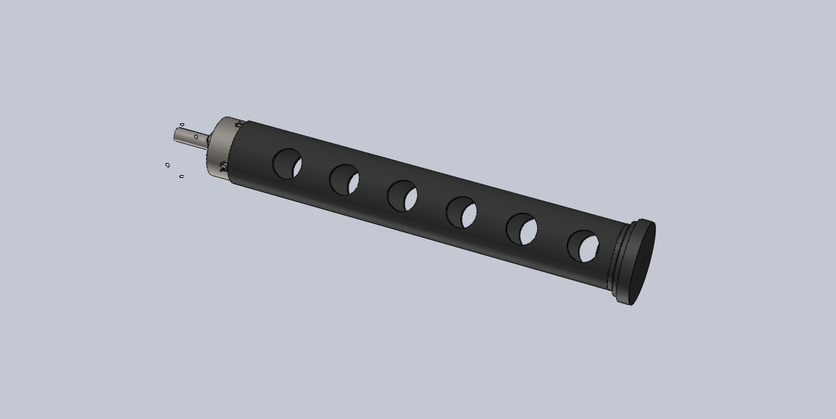

    ok this ill give you an idea what im trying to achieve

  3. are you planning to mill the holes or use a hole saw? the latter could simplify things and reduce the need for high rigidity at the expense of potentially needing tool changes if there are variable hole sizes. obviously you couldnt do rectangular cutouts.
    Also I'd consider mounting the spindle horizontally on a sliding carrier rather than a gantry (think lathe toolholder) so it drills in from the side. easier to make it rigid for large diameter workpieces.
    Do you need a chuck? one with internal jaws that expands to 220mm is going to be heavy and expensive, although i realise you wont be spinning it at any speed. Why not use a stepped cone each end with a screw-down clamp (big jubilee clip maybe?)
    The back of the cone could have index holes to manually lock it against a static support at 60 & 90 degree steps. you could add stepper later if you wanted.

    Thanks for your input buddy,
    I plan on routing the holes due to wanting it automatic, and understand that a longer bit would be needed.
    To mount the spindle on the side wouldn't give me what I require as when routing the holes the pipe would need to spin which would leave a chamfer on the inside of the holes, and that wouldn't enable me to slide a socket into them.

    OK, Fair point, but you can still achieve that result by having a short 'z' axis on the side saddle. I reckon it'll be a lot easier to get that rigid than a gantry approach.
    Really? Now you are testing me with solidworks I've only just learnt this bit hahaha
  7. Here's my thinking... To handle 3m length on X with a 500mm wide gantry (to allow for a 220mm wide cutting area) you're going to need to use a fairly heavy ballscrew or go for a belt drive. Either the gantry sides are going to be tall to accommodate the 220mm workpiece+the tool length or your going to have to raise the workpiece manually. The actual required Z motion is small, the max wall thickness of the tube.
    By making the X run alongside the workpiece the saddle will be much lighter and relatively narrow. The workpiece supports can then be made to manually move horizontally to handle different diameters, much easier than doing it vertically. The Y axis is then only the cutting depth of the spindle in and out of the work and Z only needs to raise/lower the horizontally mounted spindle 220mm or so. All in all much easier to make and much more rigid for a lower weight.
