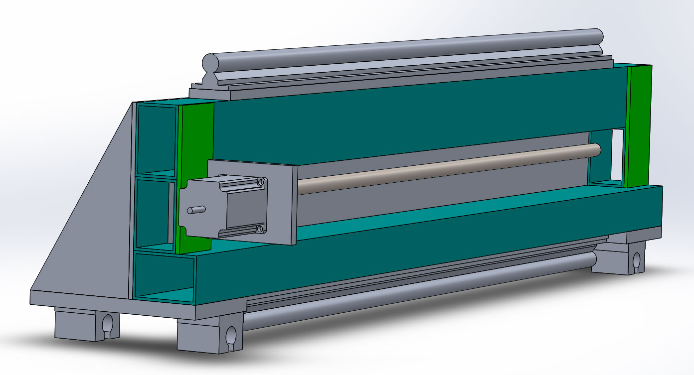

  1. It may be a little premature to start a build log - but I think it makes more sense to be asking questions regarding my design/build in a single thread rather than scattering questions across the forum.
    I built an MDF CNC router a few years back using a design modified from the original buildyourcnc.com plans. We moved house a couple of years ago - the machine has sat unloved in (warped) pieces in the garage since.
    I was planning on building a modified FLA-100 using aluminium profile - but i've already been talked out of that approach (see this thread).
    I'm now instead designing a machine from scratch using 50 x 50 x 3 steel box bolted together. I'm aiming for a cutting area of 1200mm x 600mm. The machine will mainly cut MDF & wood - but plastics & aluminium are also a distinct possibility.
    I have all the electronics from the previous build which include:
    3x Nema 23 motors
    all control boards, breakout board, 24v power supply (to be upgraded in the future) & dedicated PC at the ready.
    Spindle will just be a trend router for now - another part to upgrade later.
    I now plan on using supported rails from Chai/ebay.
    Leadscrews are, as yet undecided.
    I'd like to use 2 X-axis leadscrews - but the financial side of things may keep this as a single leadscrew for the initial build...then move to 2 as an upgrade later.
    I've started drawing up a design which is far from complete. The board on the curtting surface is sized at 1200mm x 600mm for use as a guide only. In practise the lower shelf surface & full table would be covered with MDF. There's no diagonal bracing anywhere either..that can be added in later.
    At the moment i'd like some feedback on the general approach & layout. I have a few minor concerns at the moment one being am I over engineering it?
    I've also started wondering about bolting the frame together - there's a lot of holes to drill/tap & bolts to buy which will be time consuming & more expense....which leads to me to wonder whether its worth buying a cheap arc welding starter package (£60-75) & weld the frame instead?
    Be gentle with me ;-)

  4. i thought you might say that...is a cheap Arc welder up to the job in hand though? Anything I need to be aware of? (sorry I have absolutely zero knowledge of welding)
    I'll need to rework the machine assembly to allow for welding rather than bolt together...it'll be cleaner layout.
    yeah, get a cheap machine, it will be fine
    beauty of arc welding, is its EASY especially if your welding 2mm+ mild steel. even easier with new steel
    get 6013 rods. say about 3.2mm (which again are good allrounders)
  6. Thanks kingcreaky - i've spotted a Ferm 100A unit on ebay that comes with basic accessories that looks like it should be enough to get me started.
    Regarding the rods - what does the 6013 bit mean?

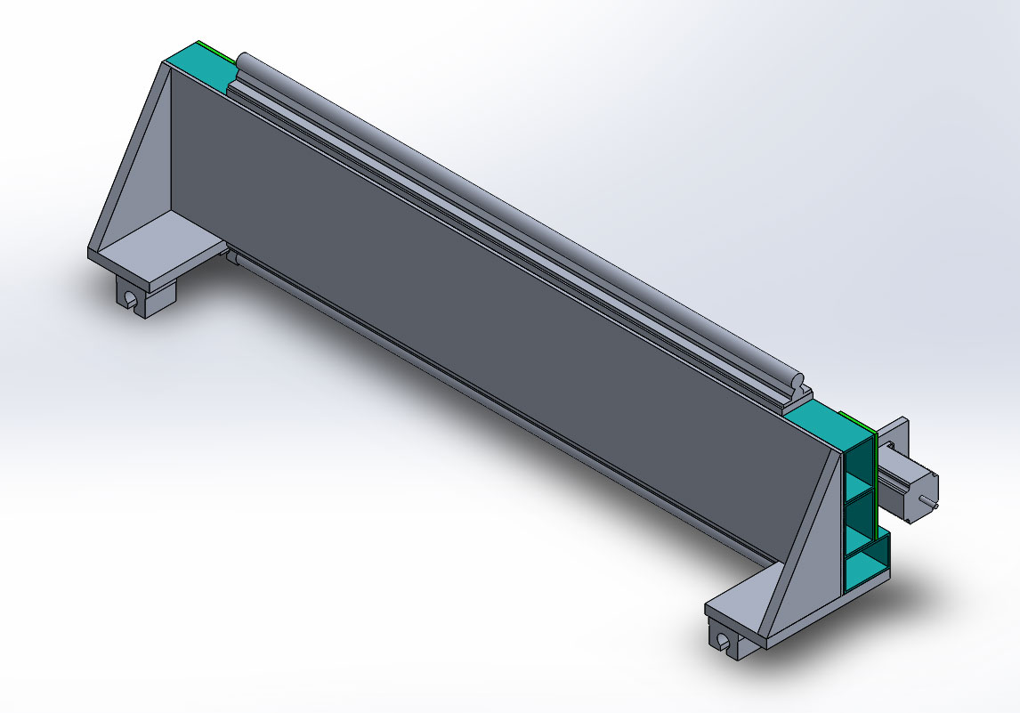

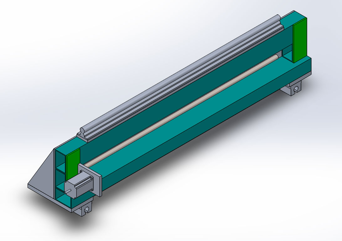

    I've done a quick reworking on the design so far for welded assembly - it currently has a bottom on the gantry for a single leadscrew, not sure if this is staying yet or not (probably not).
    As mentioned before, i'm interested in comments about the approach as a whole - not anything too specific yet as i've still got quite a bit to do on it.

  7. #6
    a 6013 is just a type of welding rod. Reading into it before posting this it appears 6013 seems about the most common type used but here is the speal if your interested
    Different Types of AC Welding Rods | eHow
    no doubt this clever lot on here will tell you these are the wrong ones... but they are the ones ive always used. Work perfectly fine all weather for me
    regarding your design...
    Good start... ive seen a lot worse.. but in my opinion...
    *id have a center leg on each side rather than use the bed horizontal as brace (you could use that aswell)
    *more bed frame crossmembers
    *forget the single ballscrew arrangement for the X, use two one on either side
    *triangulate the corners wherever possible
    *If you think its over-engineered at any point... its not.. you watch it dance round the workshop like its made out of carboard when its cutting. You wont regret stregth in design
    read ALL the other build logs...
    My machine
    http://www.mycncuk.com/forums/router...ation-cnc.html
    is similar to your design
  8. #7
    Quote Originally Posted by CraftyGeek View Post
    No Don't buy 100A welder you need more Amp's spare for duty cycle. Biggest problem with cheap Arc welders is low Duty cycle or better put the time you can weld before the it trips out from over heating is short.!!
    Now your not going to be running long welds or in a rush so it wouldn't probably be a major problem but for £10-20 more you could get 140-160A and have decent duty cycle with less stress on welder.
    Like Matt says 6013 rods but more important is ONLY buy decent quality IE: branded name BOC, MUREX etc none of this rubbish you see at Aldi or car boot sale etc and keep very dry.

    You may be interested in my steel frame router Home Built GantryMill Improvements - YouTube the cutting area is 600mm x axis and 350mm y and 100mm z. It is built with materials I had to hand hence the mixture of steel and aluminum.
    I would like to echo Robins comments about distortion caused by welding, it can be a nightmare so you will need to be very careful, also it is easier to weld thicker material but harder to remove the distortion.
