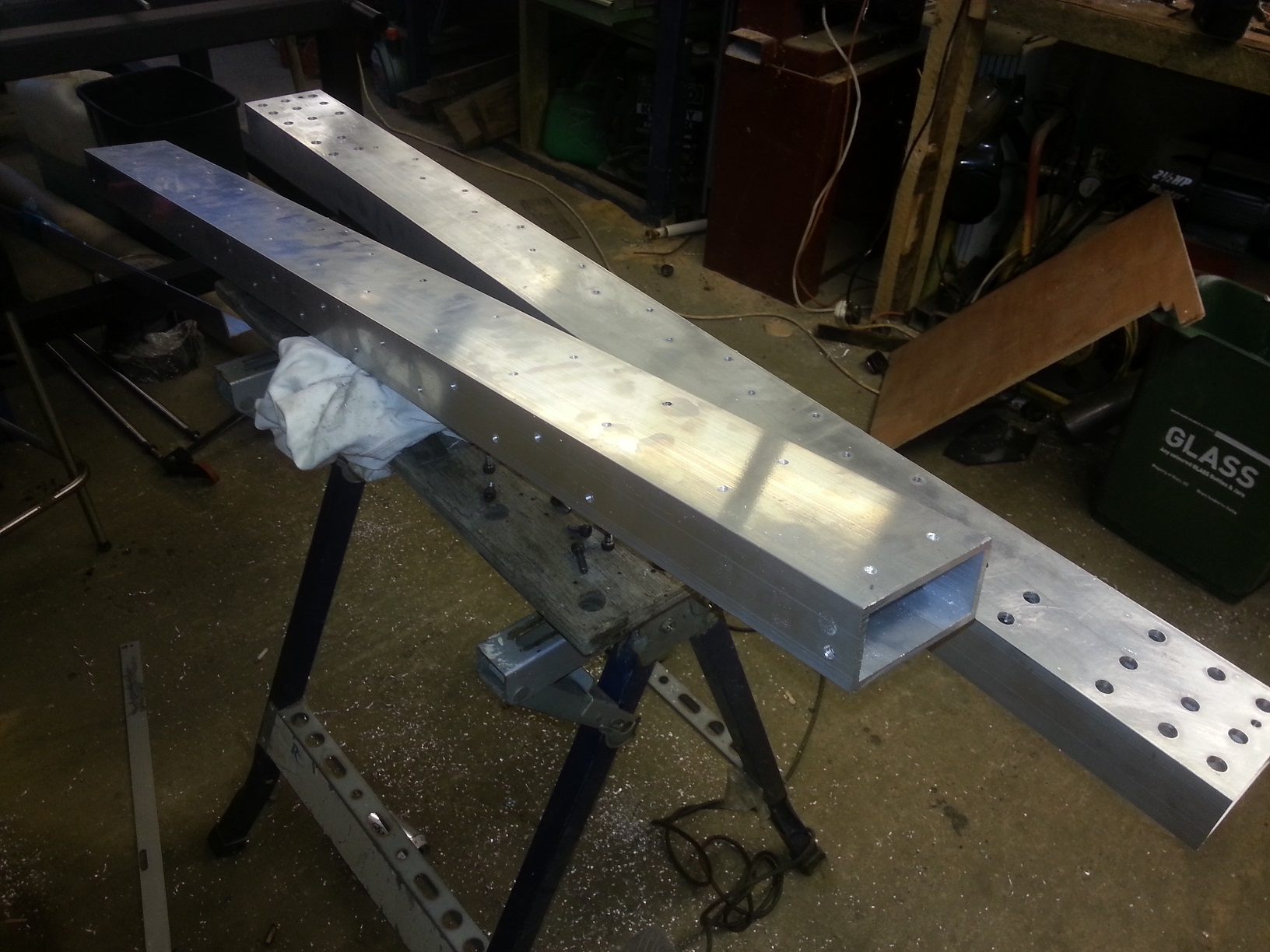

    Secondly - Jazz, the mock up design that you posted earlier in this thread - the gantry on that has 2 lengths of steel box attaching to vertical end pieces. I assume this would have to be a weld - my concern here is alignment & the lack of adjustment. Is there another way of going about it?
    Doesn't really matter because all the adjustment is taken care of thru the rail mounting and were gantry sits on X axis bearings. . . The only requirement is that it's not twisted.
    There are several ways to do different and I just drew this quickly to give an idea of easy and strong which go with single screw.
    Really how you go about it depends on the job in hand, like in creakys case it was simple but would only really be suitable or woodwork type cutting any harder material like aluminium or if higher accuracy say for fine engraving, by that I mean in brass or Aluminium, PCB's etc where required then this is when weaknesses show thru quickly. . . . Resonance and vibration being the enemy has hollow aluminium box isn't stiff enough.! . . . It's also only works with twin screws and with single screw wouldn't be very good at all.!!
    Your problem or complexity/weakness comes from using single screw.!!
