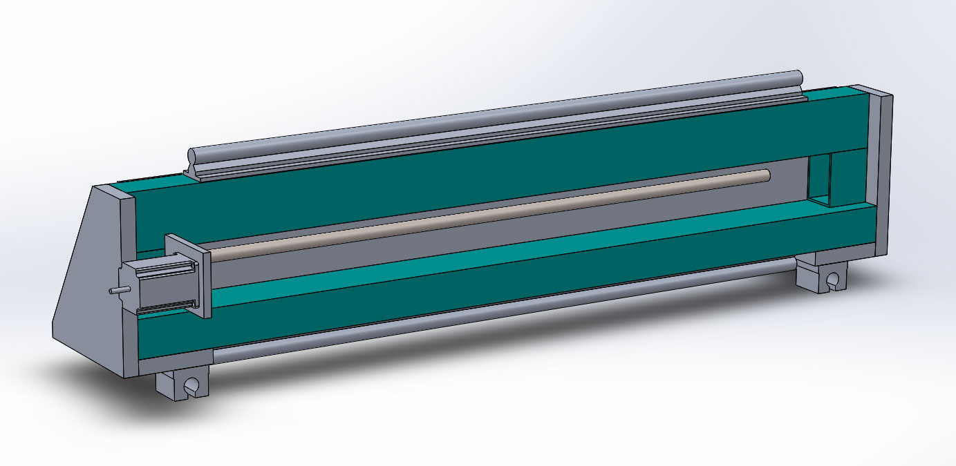

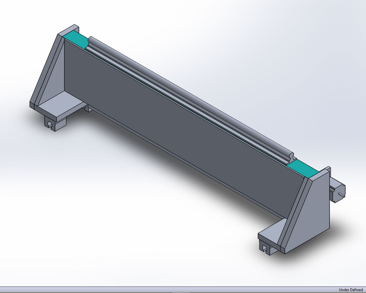

    Inner end pieces are 15mm plate
    Outer end plates are 20mm
    bearing blocks also beefed to 20mm
    Front plate is still 5mm - more to keep crap away from the leadscrew than perform a major structural role...although should help with twist & sideways flex.
    Rear stell plate removed - although that was there more for a convenient flat mounting surface rather than anything majorly structural.
    Still comes in under £100 - so that keeps me happy

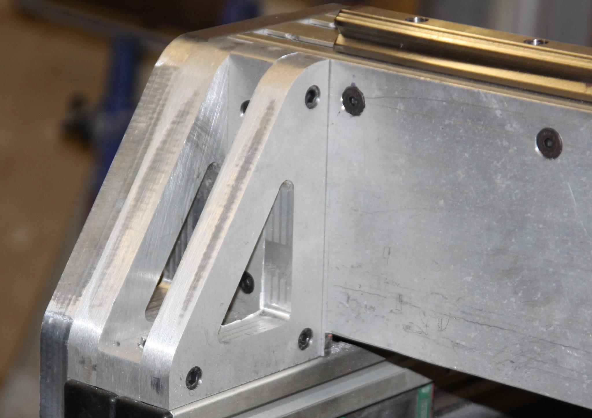

    Better but still no inner triangle brace.!! See pic of brace on my machine. It's only a small thing but does help stiffen and dampen vibration more than it looks.
    Don't let Money run this Build too much because you could easily find you spoil it for not much more money.!! . . . Better waiting and saving up to do it right than skimp. It's a lot of work building a CNC machine and just small things that don't cost the earth can make a big difference.

  9. There is one inner brace already - 15mm plate & then 20mm outer on the end.
    I'll look at doubling up that inner brace later.
    I have to keep an eye on the cost as its already adding up to way more than I originally intended...& its going to take me months & months to sort out the finances for it - so yes, the budget is important. I appreciate that its not worth cutting some corners - but I can't shove a bottomless pit of funds at it.

    Yep but the more towards the centre you can support it the better, bring that inner triangle inwards the gantry side does the same job so it's not needed there. On mine it's only built like that for ease of fitting it's piece on it's own that bolts on could have easily done it like suggested you do and would work just the same.
    Quote Originally Posted by CraftyGeek View Post
    Yep completely agree and understand but just understand it's here at this point when building frame you can't afford to cut corners. If you have a weak structure you have a Weak machine and it will always be weak or hard to correct without major hassle and expense at later date.
    I've seen this often where folks think I'll do it on cheap then upgrade later only to find out it's not that simple or easy and end up scrapping and starting again. . . . It's called learning the hard way, I'm just trying to help steer around that.!
