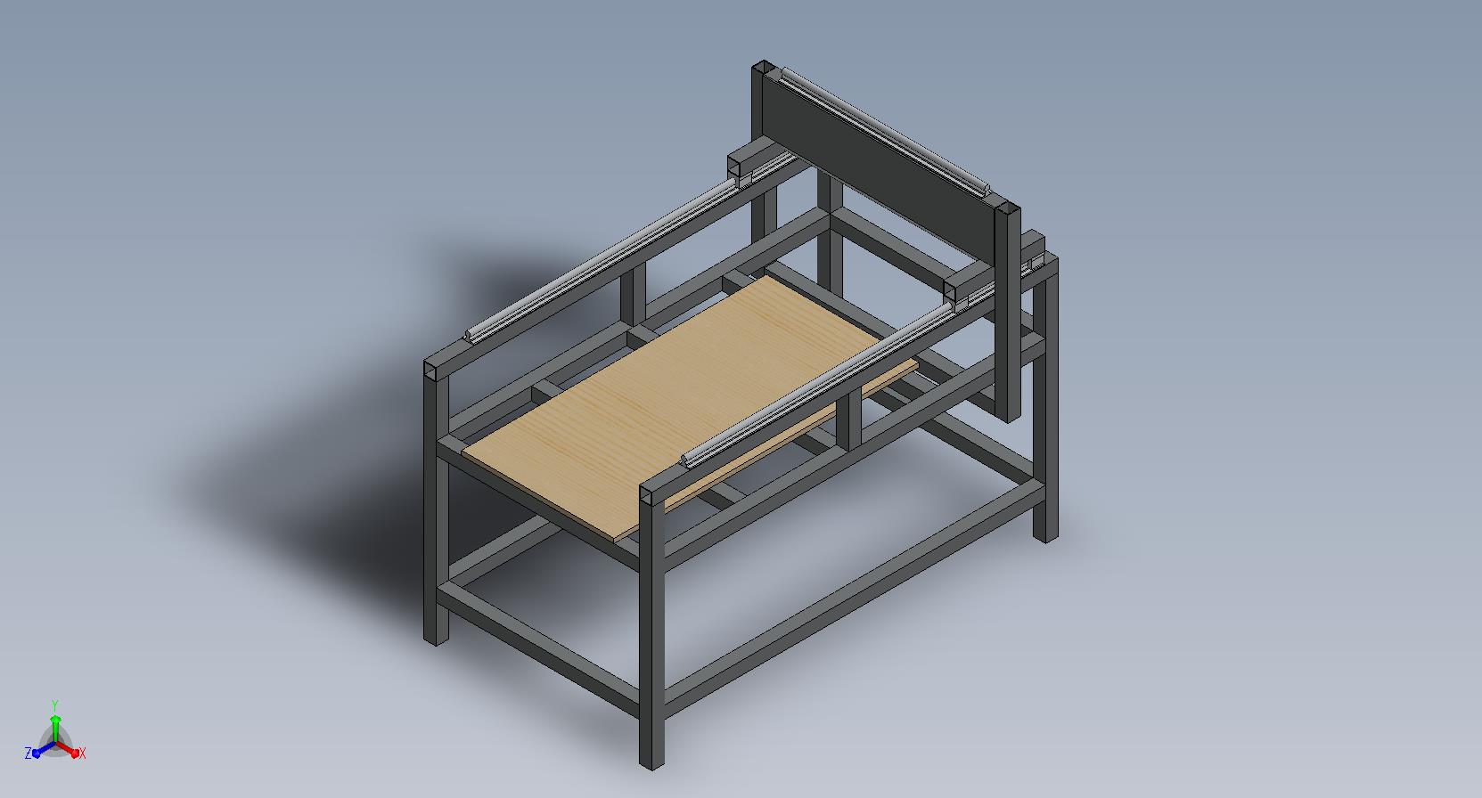

    I've started drawing up a design which is far from complete. The board on the curtting surface is sized at 1200mm x 600mm for use as a guide only. In practise the lower shelf surface & full table would be covered with MDF. There's no diagonal bracing anywhere either..that can be added in later.
    At the moment i'd like some feedback on the general approach & layout. I have a few minor concerns at the moment one being am I over engineering it?

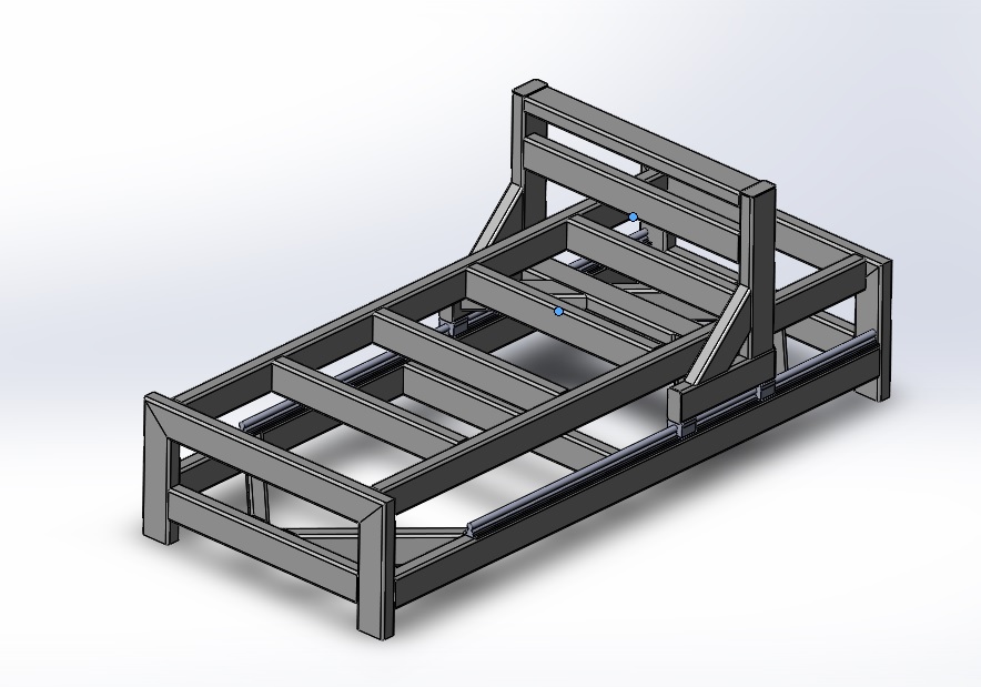

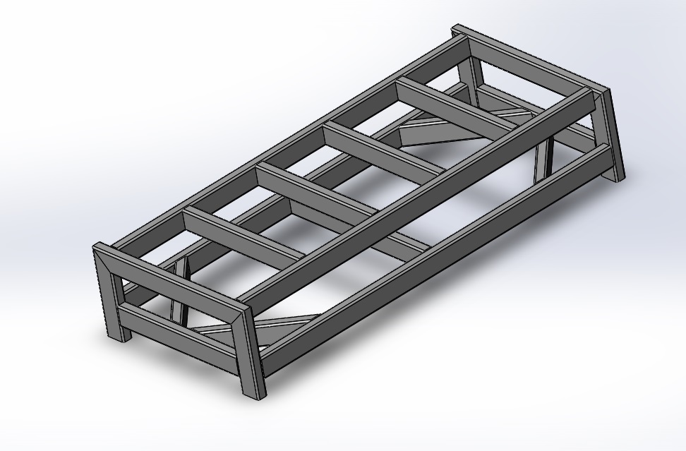

    I've done a quick reworking on the design so far for welded assembly - it currently has a bottom on the gantry for a single leadscrew, not sure if this is staying yet or not (probably not).
    As mentioned before, i'm interested in comments about the approach as a whole - not anything too specific yet as i've still got quite a bit to do on it.

  7. #6
    a 6013 is just a type of welding rod. Reading into it before posting this it appears 6013 seems about the most common type used but here is the speal if your interested
    Different Types of AC Welding Rods | eHow
    no doubt this clever lot on here will tell you these are the wrong ones... but they are the ones ive always used. Work perfectly fine all weather for me
    regarding your design...
    Good start... ive seen a lot worse.. but in my opinion...
    *id have a center leg on each side rather than use the bed horizontal as brace (you could use that aswell)
    *more bed frame crossmembers
    *forget the single ballscrew arrangement for the X, use two one on either side
    *triangulate the corners wherever possible
    *If you think its over-engineered at any point... its not.. you watch it dance round the workshop like its made out of carboard when its cutting. You wont regret stregth in design
    read ALL the other build logs...
    My machine
    http://www.mycncuk.com/forums/router...ation-cnc.html
    is similar to your design

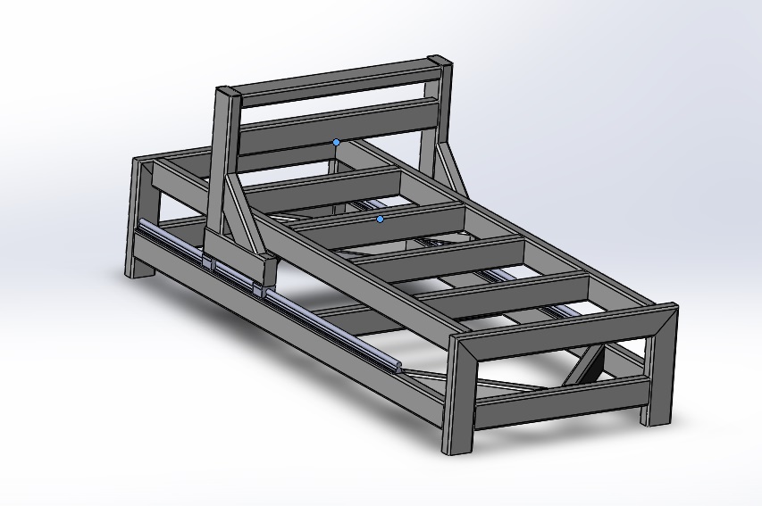

    Ok I'm back with my wrecking ball . . Get ready.!!. .
    So I see you've been paying attention with using the high sides and gantry sat on rails design which is great for twin screw machines but in this case it's actually hurting your design badly.?
    Because your wanting to use single screw (with option to upgrade) this means having gantry cross brace but with those high sides it means having long gantry sides which are acting has levers. They will flex, twist and stress the bearings, they will also resonate like crazy, this all transfers back to the work or like Matt hinted at make the bloody thing dance around the room if bad.!!. . . Not good design for this way of doing it.!
    Really because of your budget restrictions then your going to have accept a bit of compromise on design.? In this case it's flexibility regards cutting height and materials you'll be able to cut. The high sides with gantry on rail design works very well if you want strong rigidity and flexibility of lifting the bed but it just don't work for use with single screw.
    So your going to need a way to keep Gantry sides short has possible but yet high enough to give clearance you'll need for cutting what you want to cut.? . . . . It's simple enough you can't have high clearance and high strength,it's always a compromise with this way of doing it.
    So best thing is first decide the lowest clearance you can work with a build frame that allows gantry to be kept short and strong.!
    There's several ways to build frame to allow this and I'm not going to try telling them all I'm just going to show the sort of thing I'd build for this Budget and upgrade has you can afford way of doing things. (It's just something I knocked up to show principle not finished design)
    This gantry/frame design will be very strong and use's roughly 2.5 x 7.5mtr lengths of 80x40x3. It can easily be converted to twin ballscrews.
    It's shown has desktop machine to keep cost's down but making it free standing would be simple enough just cost more.
    Hope this helps and carry on it's perfectly do-able to build strong machine even on budget.
    Oh one more thing or Tip with modelling.? . . Get accurate dimensions or better still Cad models for the things you plan to use, like ballscrews, motors etc has it's easy to think I'll use this or that like this and then it doesn't fit or interferers with something else.

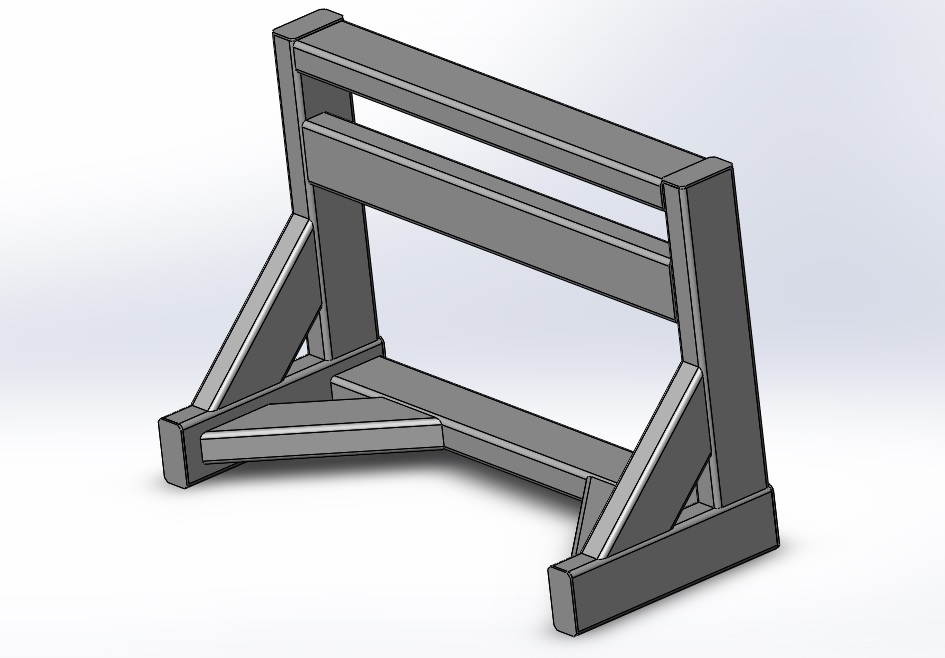

ID:	9372   Click image for larger version.
ID:	9373   Click image for larger version.
ID:	9374   Click image for larger version.

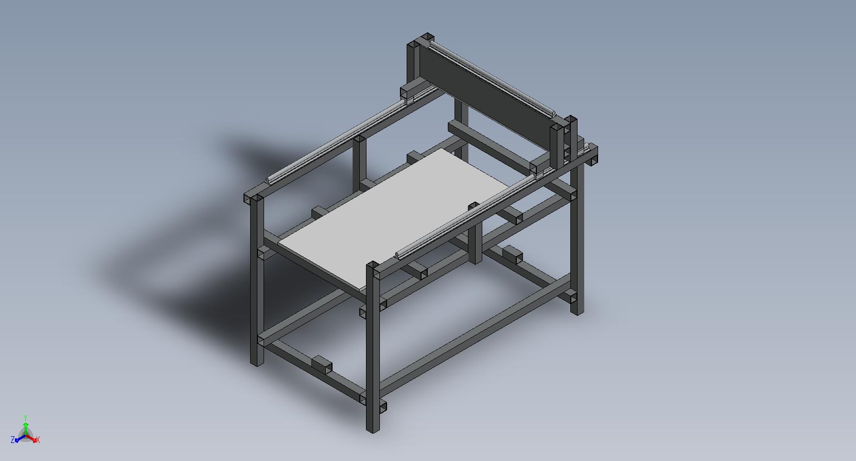

  11. Thanks Jazz.
    I have made a few changes since I posted that last image...the main one being the removal of the single leadscrew option. I've decided that I want to do a decent job of this, which means it'll take me longer to get it running - but the end result will be worth it...so dual leadscrews from the start - hopefully driven from a single motor.
    I'm still very much tinkering with the overall dimensions - I have shrunk the z depth & reduced the overall height a bit as well.
    I hope to have a bit more time to spend on it tomorrow to make some more changes, then i'll come back for another slap on the back of the head :-)
    On the gantry you posted above - I assume that the spindle mounts between the *ahem* open legs?
    Question...does the distance fore/aft that the spindle is mounted (relating to the x rail bearings) have any effect other than allowing the cutter to reach different areas of the table?
