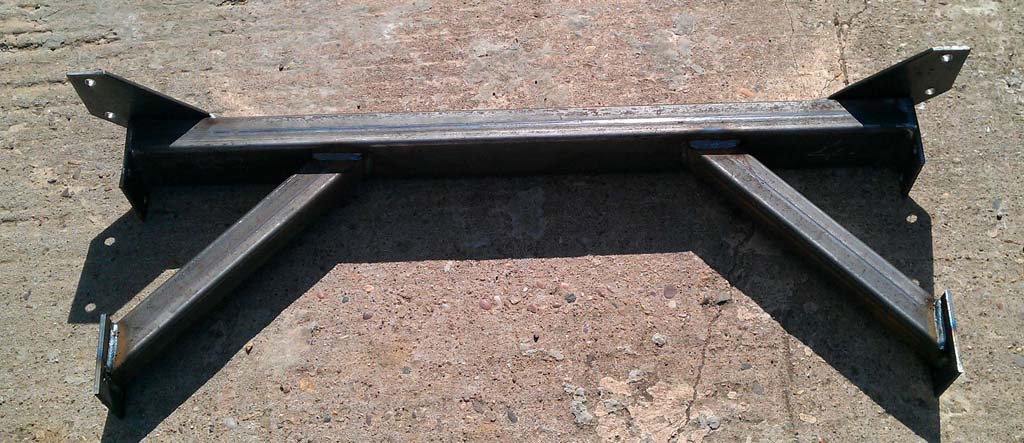

    Here's Where and how I use it. It's also why steel or frame distorting slightly is no big deal.!!
    Most of the frames I build are a mix of welded and bolted like these pics below. ( Frame only here no Bed, it's adjustable) At the joints and where top rail sits on plates is where it's used.
    When I'm all finished and welding up then I bolt frame together to get an idea of how far off things are.? Most the time they are hardly off at all and just a quick grind or tweak of mounting plates brings it near enough to call Ok.!! . . . Some times shims may be needed.
    Remember the rails being parallel and on same plane are the important areas and because the top rail is Bolted we have complete control and adjustment of this. It also doesn't get welded so NO distortion happens, just choose the straightest unbent piece you can find. (We have ways around bent rails has well but won't get into that now.)
    Now in most cases after shimming or grinding true and square I could leave it at this but I don't. I go one further and disassemble again this time rebuilding with Epoxy putty at each joint with cellophane between to prevent sticking together.
    This gives me about 1hr to set the frame square and true, Doesn't matter if the welded frame isn't quite square or plates not perfectly flat etc because the putty is going to take up any slack. . . . . So long has the shims from first assemble are used then All that matters is that frame is SET square and uprights vertical Now because Putty's going to fill any discrepancy and when it's set solid over night you have perfectly flat and true surfaces. The shims can be removed or set left into Epoxy.
    Now where not talking 5 -10mm thick epoxy pads here, there often just wafer thin just filling voids etc.
    Drilling and pinning the joints with dowel pins helps make sure everything goes back in same place and makes assembly easier.
    Again the main frame being 100% perfectly square isn't overly important, it's the top rails that matter.!! . . Can't stress this enough.
    Now what can be more of a pain to deal with is Twist of welded sections from distortion but again depending on design etc this can be got round. Often it's just a case of forcing the twist out by twisting in opposite direction, if twist is happening then you can often see it has your welding so stop and twist it back. This is also why spreading the welds around is important.
    The bed is the main area you need to keep an eye on distortion and even then again Epoxy can be your friend if really bad and with a bit of Brute force and epoxy if need be then the Bed can easily be sorted to within a knats cock. When spoil board is surfaced then it will be Cock On.!!
ID:	9407   Click image for larger version.
ID:	9408   Click image for larger version.
ID:	9409   Click image for larger version.

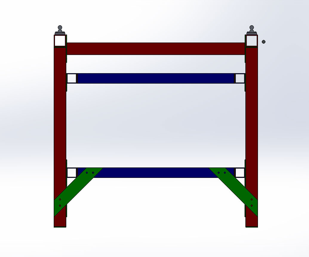

  5. Ok - design progress time.
    I've been focusing on the frame/table so far - its now at a stage where i'm pretty happy with it & I think i've added everything that I meant to.
    red = 60x60x4 box
    blue = 50x50x3 box
    green = 60x4 flat bar
    orange = 50x4 flat bar
    Rails are sat on 50x10 ally flat.
    Ignore the floating guide leadscrew for now - its just there as a vague reference as to where i'm planning to put the leadscrews at the moment. Also ignore the holes going through the outside of the legs, they won't be there when I make it.
    The frame has the ability to be adjusted for square in every direction. The cutting surface can be positioned in 5cm increments down the legs.
    Both the lower surface & cutting surface will be covered in mdf added further bracing.
    Hopefully this will mostly get nods of approval so i can move on & start thinking about leadscrews, motor mounting & the gantry in more detail.

  6. #36
    Ok looking much better.!! . . . Take it you have decided not to weld.? If so Not saying this is bad thing if that's what your most comfortable with but will be a lot more work and maintenance. Mixture of both works best IME.
    Only thing I see and question is DO YOU really need that much adjustabilty of the bed.? If not then I'd raise the lower frame and increase the triangulation. Will just help stiffen the frame a little.
    Crack on.!!
  7. There are still welds in there - I think I need to see how I get on with the welding to see how accurate I am with it...then if I feel confident enough, i'll drop more of the bolts & weld instead (like the table surface). I do want to make it so that the whole frame can come apart into manageable sections for moving house etc in the future.
    Regarding the height adjustment - I don't know is the short answer...I've seen that others do it & it might be useful for me at some stage - but I don't have any examples in mind. In reality I probably don't need that much. I'm also still playing with the overall dimensions a little - so i'll still be tweaking for a while.
    The frame at the moment should be a decent height for me to work at - i'm conscious of making it too low & giving myself back issues (which I get from time to time)...more cross bracing can be added at a later date easily enough.

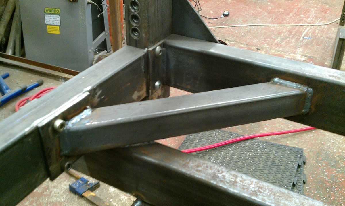

  8. [QUOTE
    Most of the frames I build are a mix of welded and bolted like these pics below. ( Frame only here no Bed, it's adjustable) [/QUOTE]
    Jazz, do you mind explaining how the bed adjustment holes work on the frame pictured. It looks like you have another tapped plate or something inside the RHS? Cheers
    joe
  9. #39
    Quote Originally Posted by JoeHarris View Post
    joe
    Yes there's a 10mm thick plate with holes tapped it.The holes in legs are drilled oversize for clearance. The 10mm plate is tacked in place to hold.
    The main bed frame is heavy so there's 4 lead screws (2 each side) to help lift up and down and roughly get into position. Then there's 8 angle plates(4 each side) fastened to bed frame with 2 holes in each so 16 Bolts total that bolt into uprights with 10mm tapped plates inside.
    It's simple and easy thou to be honest it's not something you do very often has usually you'll settle on a position that allows 90% of what you want to do.!. . . . It's just nice having the flexibility to do oversize things when needed.
