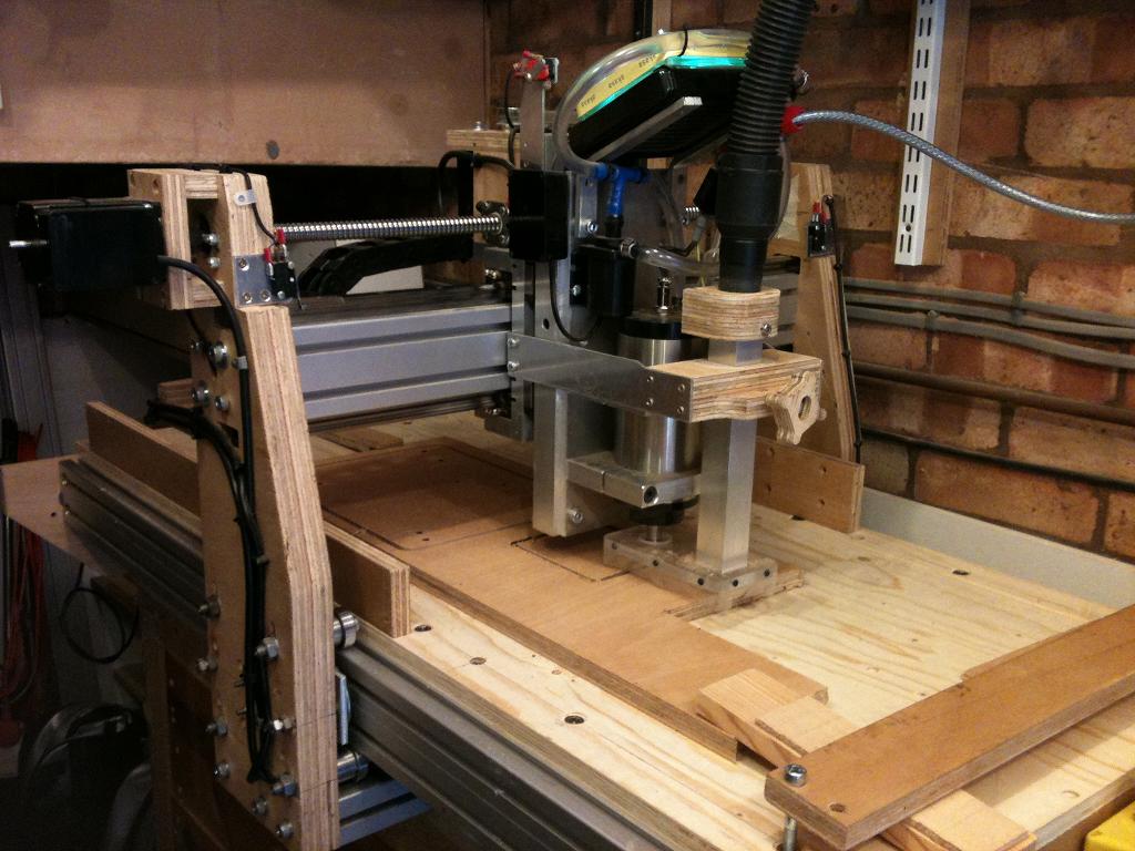

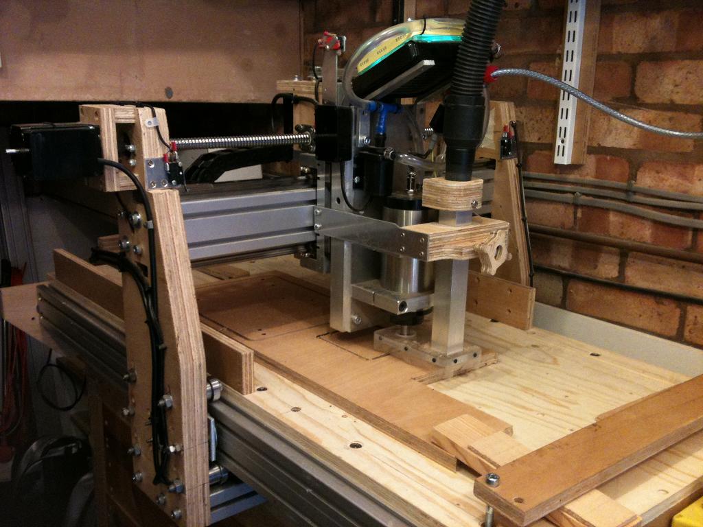

    Sorry Eddy, it was just some plastic sheet I had lying around. You can see the floating shoe and plastic skirt on my old machine . . .
