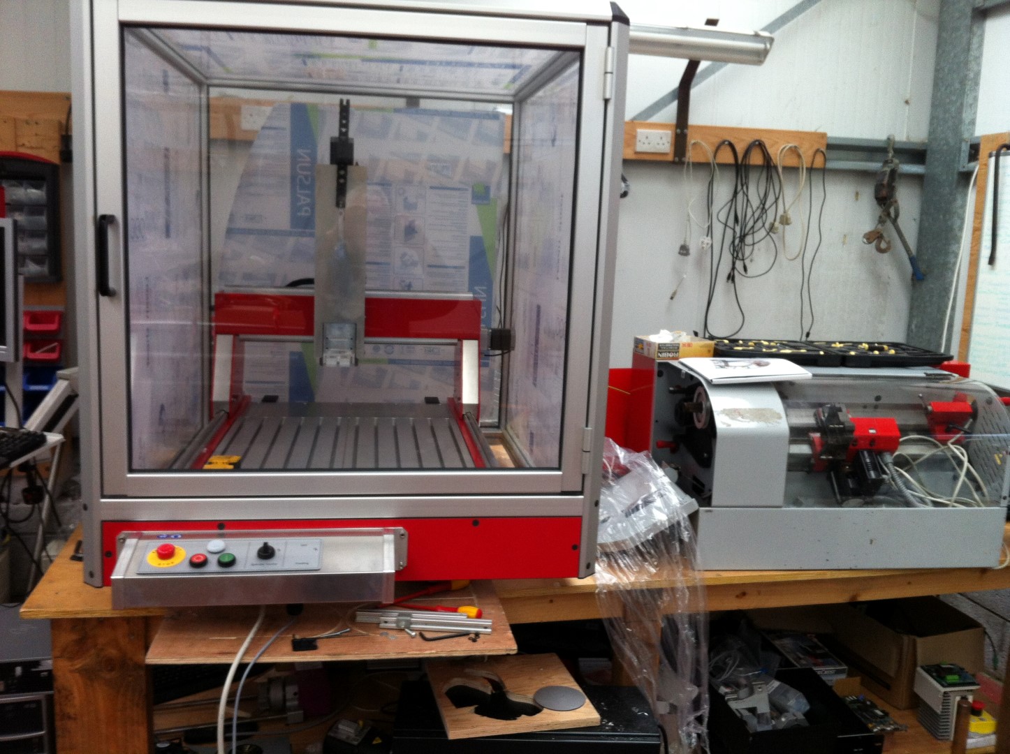

    I can post servo stepper prices if requested. We also offer a fully enclosed version currently available on the smaller 604012 machine. We can enclose the bigger machines and can discuss this further if requested.

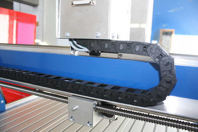

    Maintenance While keeping the machine clean and free from swarf and potential hardware snags is essential for reliable operation - the machine is virtually maintenance free. The helical raceway inside the ballscrew drive mechanism can be lubricated using easily accessible grease nipples. There is adjustment options on the drives for long term wear. As of yet we have not had to do this on any of our installed platforms.
