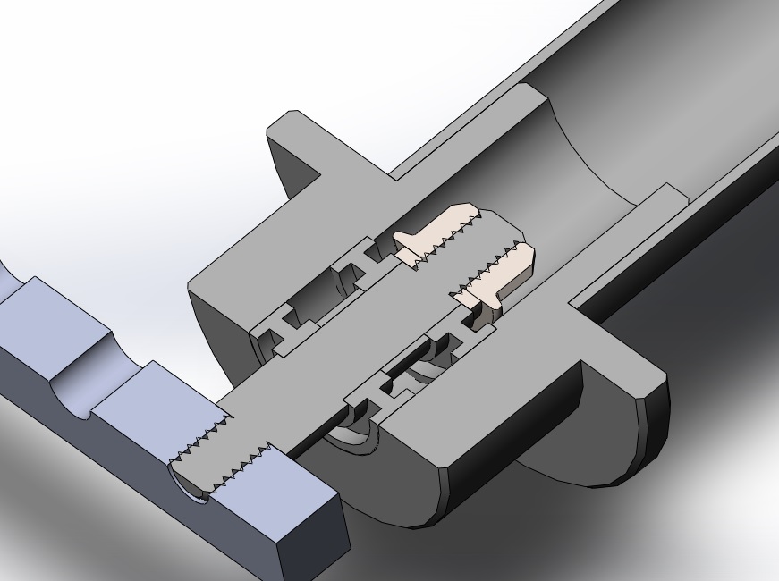

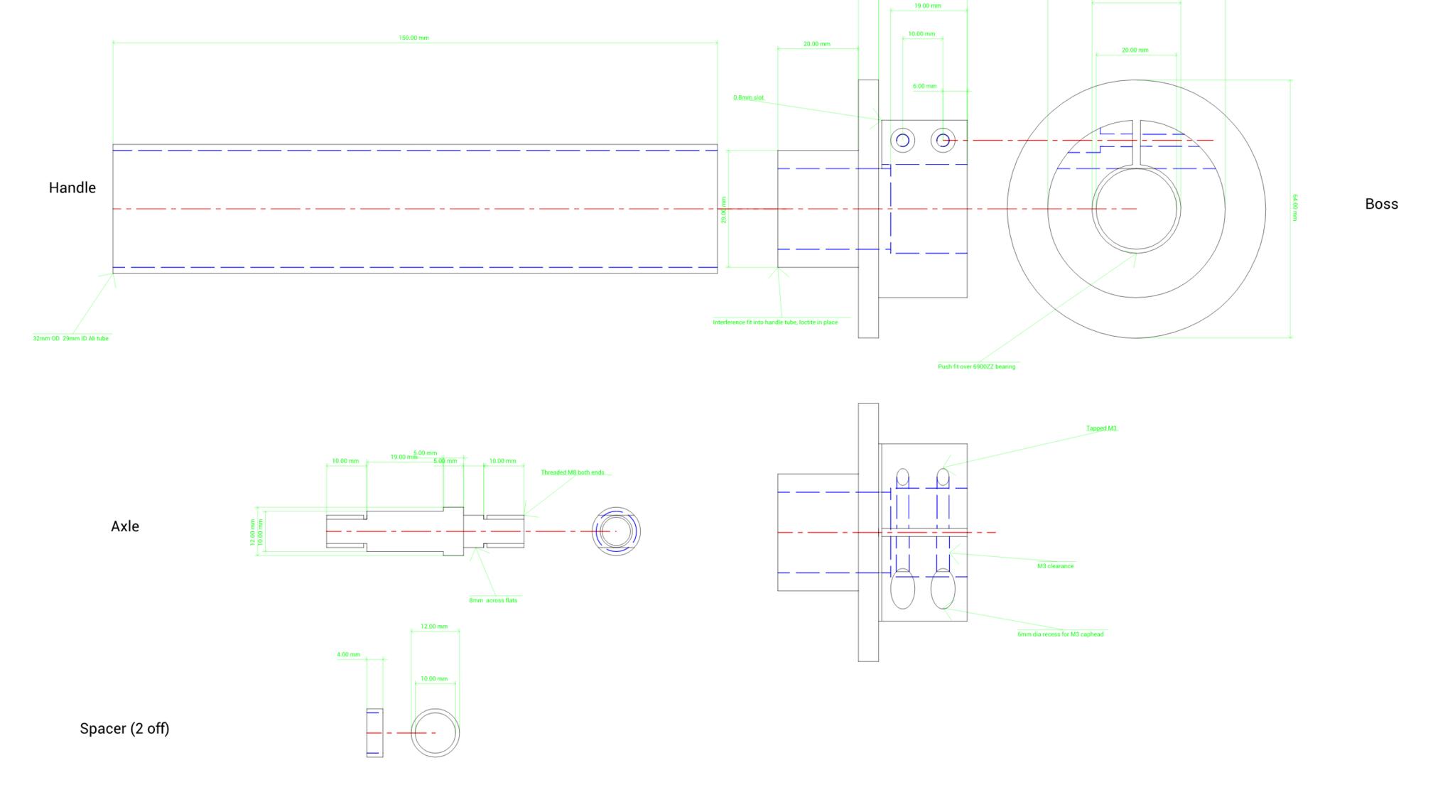

    Updated drawings attached. I've only taken the radial slot down to the top of the bearing, think that'l give enough movement?

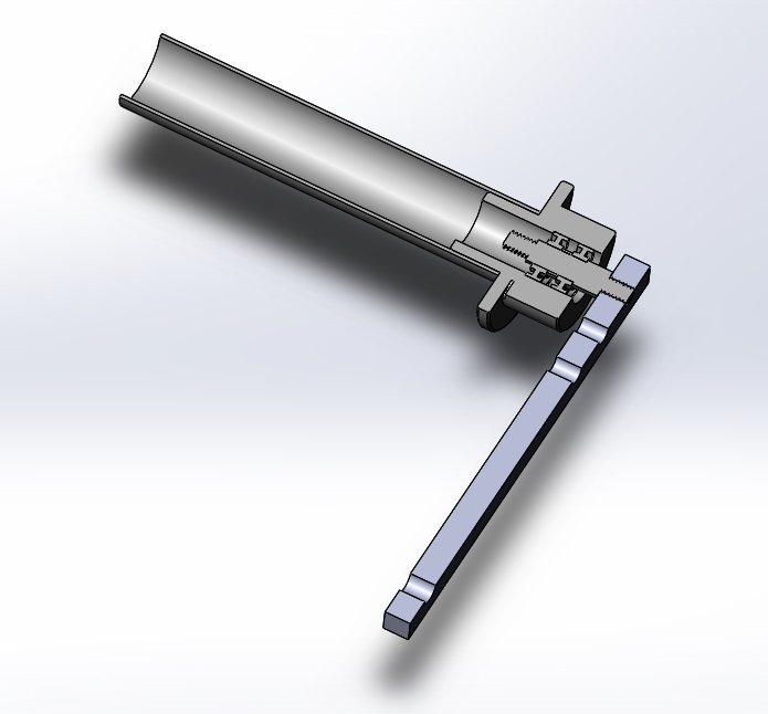

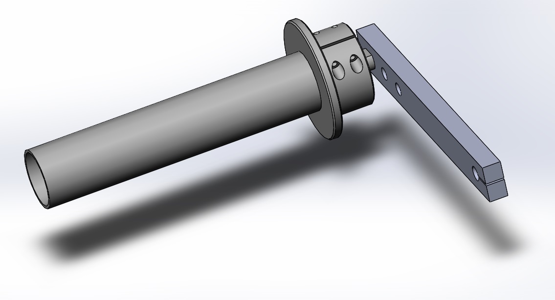

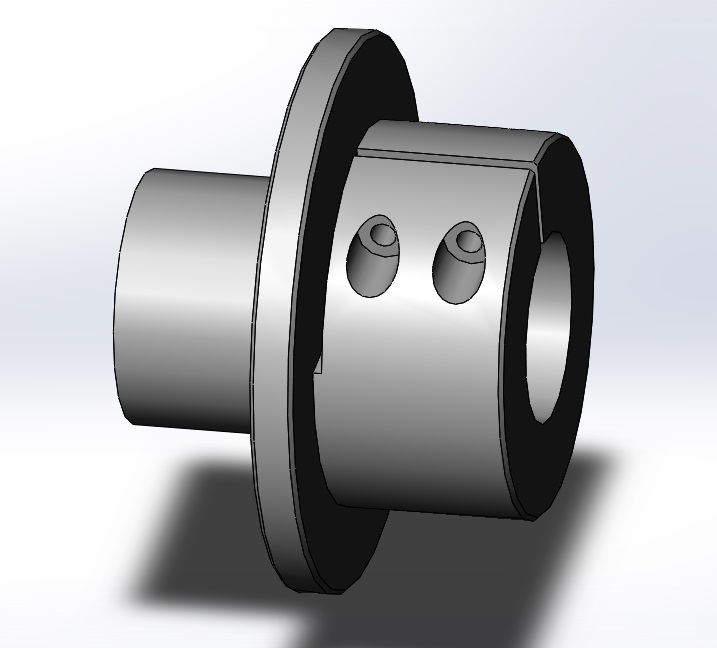

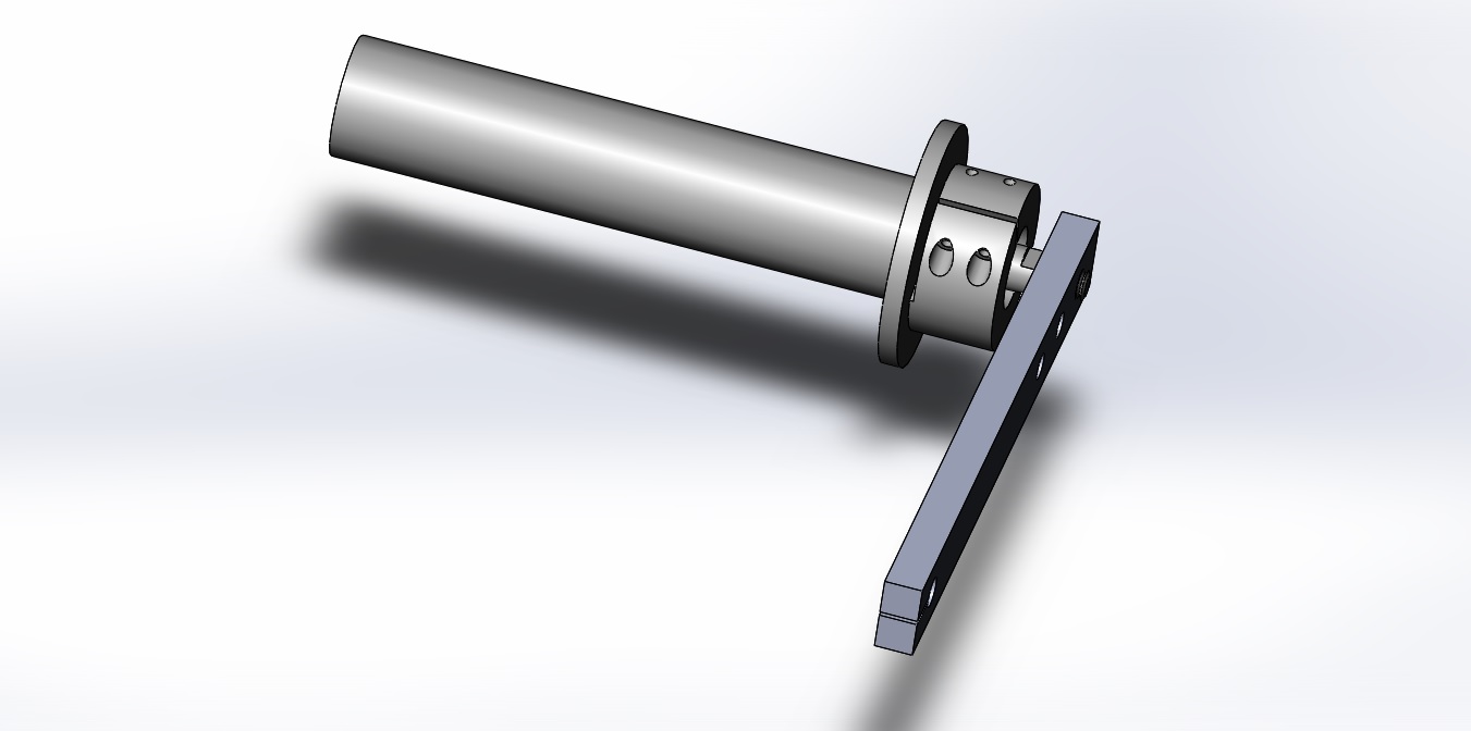

    Personally I'd have gone for solid and let me take the weight out of it by boring.!
    Regards clamps bolts then probably 2 has it will clamp more even. How many bearings are you planning on using.?
    Also the specs for 6900zz are 22x10x6 and if this is being assembled like I think (see pics) then you have allowed for 2 bearings @8mm is this correct.?
    See pic6 and you'll see what I mean with 6mm bearing and 4mm spacer between, it leaves shaft sticking out.!
    Let me know if I'm wrong and if this is the final drawing.
    cheers
    Dean.

  9. Dean,
    If you prefer to machine from solid and dont mind the wastage feel free I went for the lowest cost approach.
    When you say 'shaft sticking out' I assume you mean the inner end of the axle? Thats why there are 2 spacers, the second goes on the end of the axle and a standard M8 nyloc nut & washer bears against it. I did it this way as in the past i found a M8 nut is too large and fouls the bearing outer race (da max for bearing 12mm, A/C for nut is 15mm) and turning an M8 washer down to 12mm is fiddly.

  10. #20
    Dean,
    Ok will do not a problem just small delay on material, which I've sorted. I Should have material for weekend so will do it then.
    Ah ah my mistake didn't see x 2. . . . Lol . . . . Thou think it better to space the bearings far apart has possible so I'd be inclined to make a washer, so I'll do that if you don't mind. I'll make wider spacer and turn a washer down, turning washer down is easy enough so no problem.
