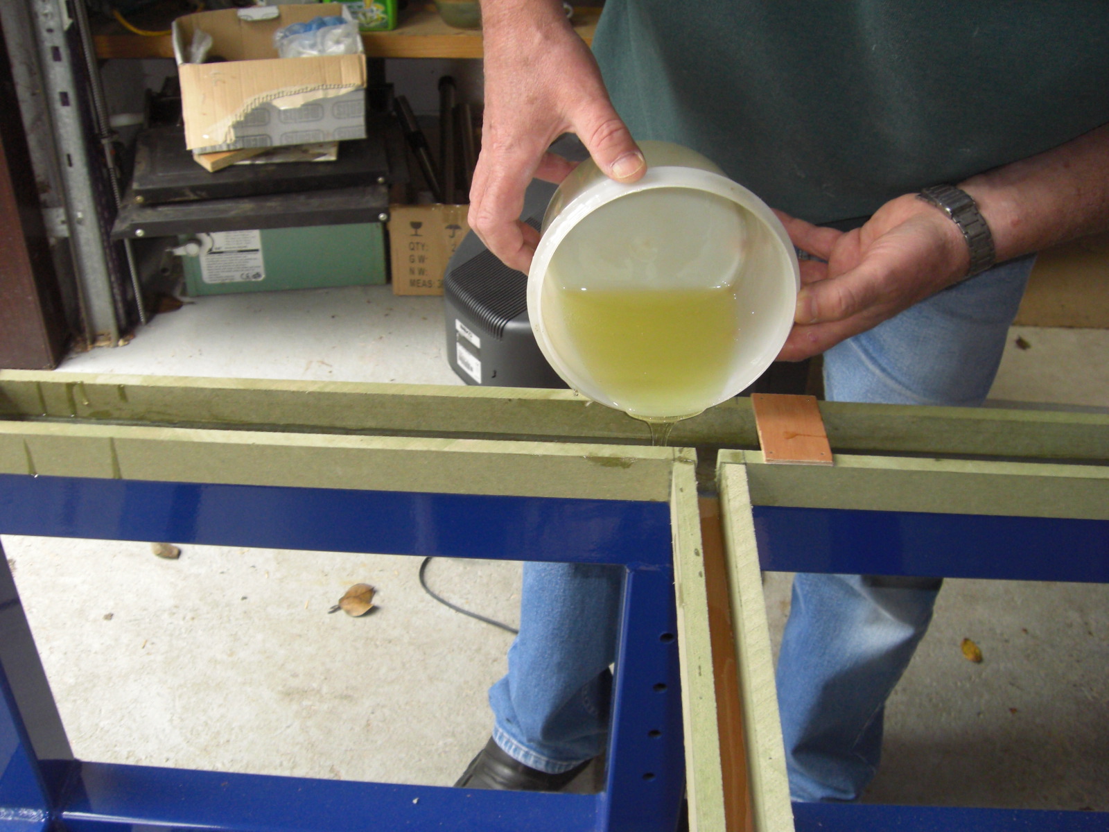

    There are ways around this like Epoxying the top rails so they level to each other but this is more involved..
    I sort of made a similar frame and used epoxy like others have done on here like this:-

    The bridges from one rail to the other is to allow the epoxy to self level.
    The Epoxy is Wests System 205/109 very slow setting hardener ..Clive
