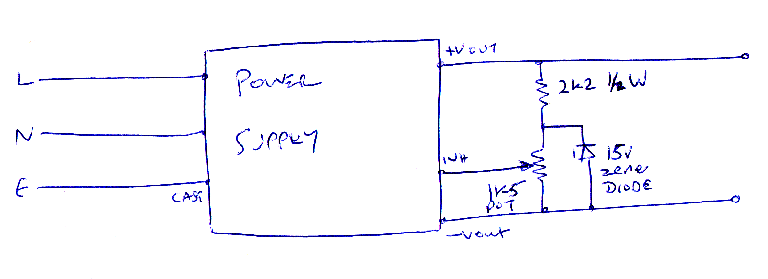

    The two questions being asked were, how do you connect to it and how can the output voltage be reduced below 50v.

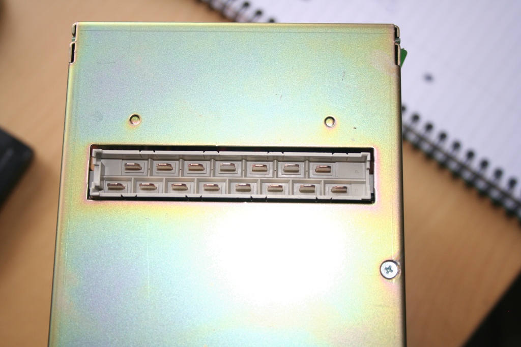

    The first is easy, standard 4.8/0.5mm LUCAR connectors fit perfectly, so no need for an expensive socket.
    The second less so... but I'm working on it. The attached datasheet shows that the Inhibit line must be between 5.5v and 11.5v approx which controls the output voltage between 50 and 57v approx. As the inhibit line drops below 5v the output volts is fixed at 42v until at some point (to be determined) the output is turned off. At 42v the supply is out of regulation (but exactly what that really means is open to experimentation). The circuit diagram below shows one way to set the output voltage.

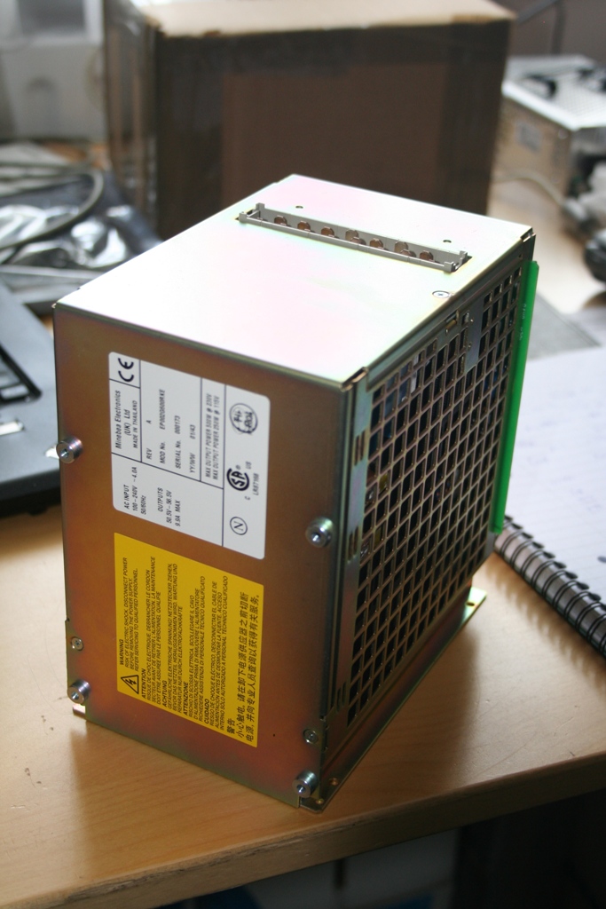

    Pic 1 shows the unit, Pic 2 the connector block.

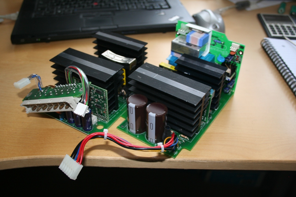

    Pic 3 shows the two main circuit boards when stripped out of the case. Note the substantial heatsinks.

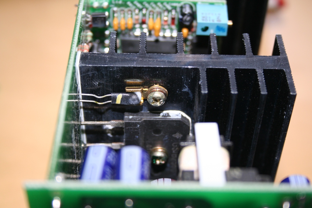

    Pic 4 shows the input RFI filter - a sign of quality

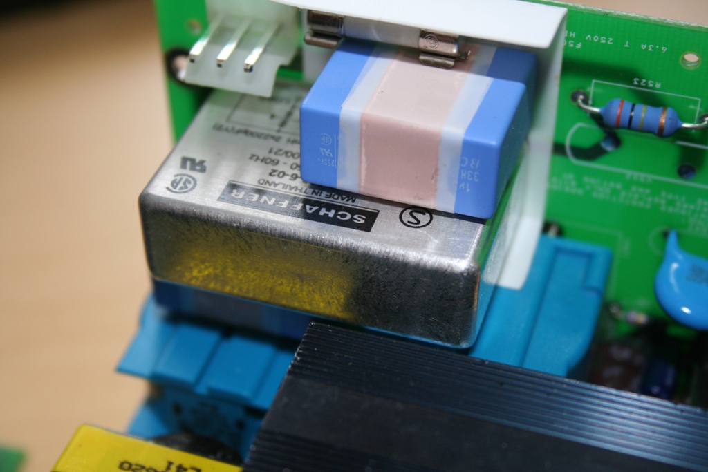

    Pic 5 shows the daughter board which is a separate switch mode supply to provide internal intermediate voltages. The adjustment does not control the main output volts.

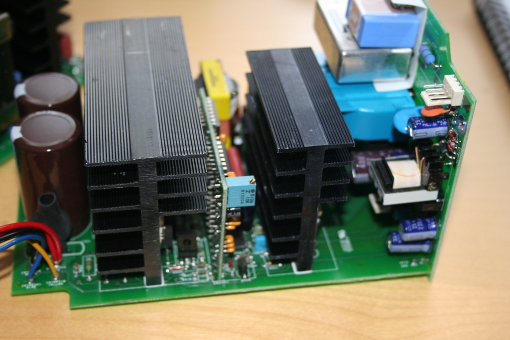

    Pic 6 - another sign of quality - a temperature sensor on the main input bridge rectifier heatsink. The 25A bridge rectifier below it converts 240v AC to 330V DC

    The datasheet shows that if the inhibit line is left at 0V the PSU will sit at 42.8V (out of regulation). You also mention that it might turn off at some point, but I can't see that mentioned in the data - is this from experience? I'm thinking of just trying (leaving it plugged in in the corner) it to see what happens... You'll probably remember that I need 50V max for my drivers (aiming at 42 to 45V).

    No I haven't tried it - but whats the point of an 'Inhibit' that doesn't? Need to put a 100mA load on as well for test so need to find a 470ohm 10W resistor...

    Which is why I am working to figure out the mod to control the volts down to 35 - 45 instead of 50 - 57. It may be as simple as changing the resistor controlling the current sink device in the feedback loop...
