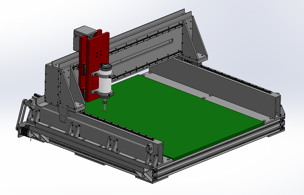

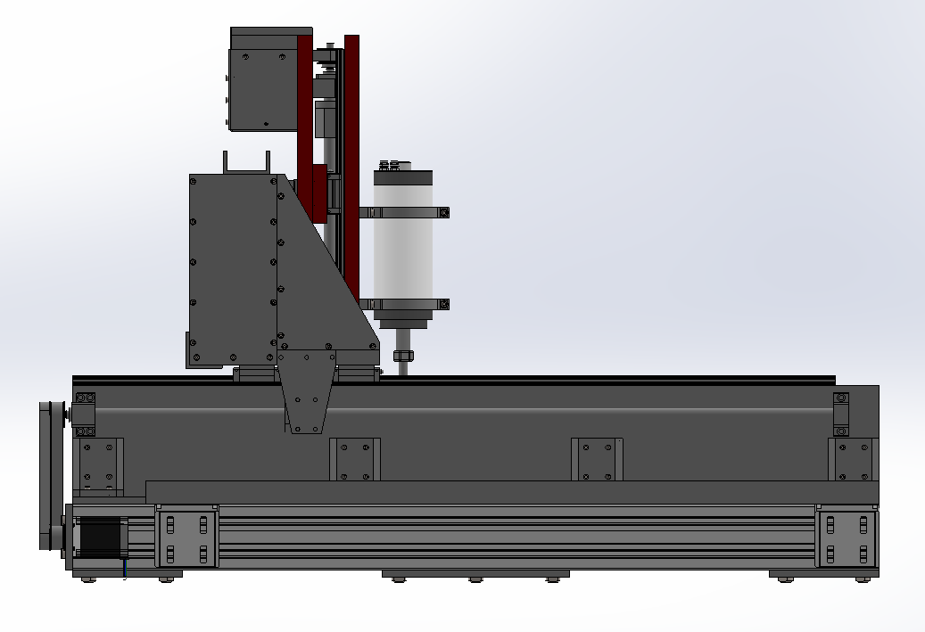

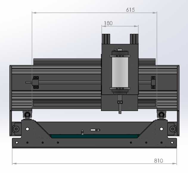

    The design has progressed a bit so I thought it was time to get a bit of feedback...
Name:	2013-08-17 perspective.png
ID:	9523 Click image for larger version.
Name:	2013-08-17 bearing block placement.png
ID:	9524 Click image for larger version.
ID:	9525 Click image for larger version.
ID:	9526 Click image for larger version.
ID:	9527 Click image for larger version.
Name:	2013-08-17 front with dimensions.png
    I've decided to try to increase the maximum material thickness to more like 100mm (up from 50mm before). To achieve this though I seem to have ended up with an unusual bearing block placement on the z-axis, see image 2. The idea is to be able to lift the z-axis high enough so that the bottom of the gantry is the limiting factor for the material depth. As drawn I have 180mm top to bottom between the z-axis bearing blocks but I could easily increase this - I was thinking 250mm would compensate for the additional over hang of the z-axis.
    The gantry has changed design several times . It started out as two pieces of 45x45 heavy (a bit like this) then got changed to two pieces of 60x90 heavy , then to a single piece of 90x90 heavy.
    I finally settled on two pieces of 45x60 heavy with a backing plate of 10mm aluminium, the unsupported span is 610mm. The deflection calculator on the Metallin website (using the closest match) seems to think the z-axis deflection should be ok. Using 60x90 heavy would reduce deflection, I'm sure, but it was expensive and reduced the x-axis cutting. I think this is probably a fair compromise.
    The belt arrangement of the x-axis has been improved. The ratio is now 1:1 and there's better belt contact with the stepper pulley.
    I've not added the y or z-axis steppers into the diagram yet (should be fun). Also still to be drawn is a chip guard for the y-axis screw. There will be a thin plate with a long slot (and maybe brushes) for the y-axis connection to the z-axis assembly.
    I'm all ears.......

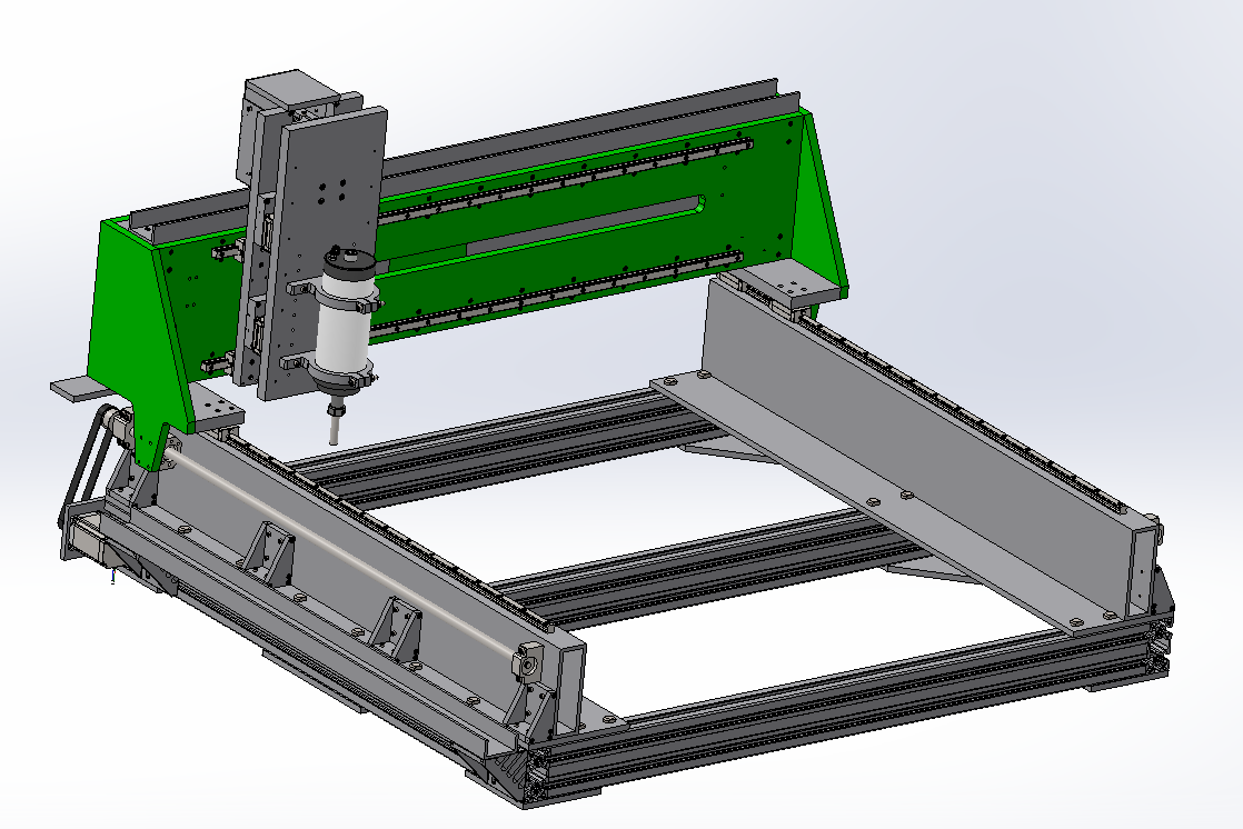

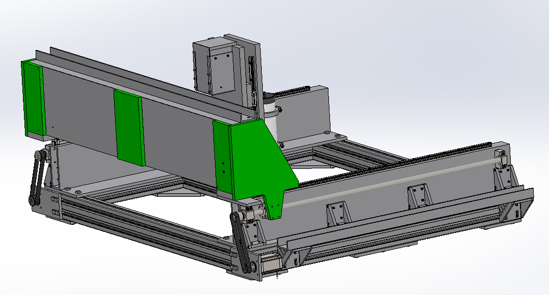

    After my bracket making endeavours the other week I've been thinking that it's probably better if I just get the majority of the pieces cut professionally. I think I probably could just about cut the pieces myself and end up with a working machine but I'd be old and grey by the time I finished (or I'd end up buying a milling machine).
    A benefit of getting the parts made is I don't have to worry about cuts that would be difficult for me to make. With that in mind I've changed the design slightly. The parts in eye watering green have been upgraded from 10 to 15mm. The brace for the gantry is gone in favour of a single stronger side plate (there will be M5 bolts through the side plate into the front and back gantry plates and the base plate).
Name:	2013-11-16 perspective 2.png
ID:	10774Click image for larger version.
Name:	2013-11-16 perspective 1.png
    I was thinking about maybe getting the parts water jet cut by a local company that could also supply the aluminium for the job. Unfortunately I have no idea how much water jet cutting costs, I'm guessing it's not cheap though. The other option would be to find some kind soul around these parts that would cut them for me.
