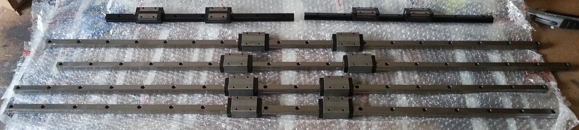

    I've been doing some reading about the electronics side of the project recently hence the lack of updates. I'm currently favouring a Mach based set up using an Ethernet SmoothStepper and the PMDX-126 board. A fairly expensive set up admittedly but one that I hope will be fairly trouble free. I admit I'm tempted to try out LinuxCNC first as I have a pile of old computers hanging around and a fair bit of experience with Linux (I run half a dozen Linux servers) but as an old friend once said to me "Linux is only free if your time is worth nothing" and I've found that to almost always be true.
    My rails finally arrived from South Korea (48 hours to get from South Korea to Cardiff, 3 weeks nearly to get from Cardiff to Gloucester!). I got caught for import duty but not a lot so can't really grumble and they were still much cheaper than locally sourced stuff. I've given them a little slide about and everything seems fine. If I press down on the block it slides more easily, I'm guessing this is pre-loading? Is there anything in particular I should look for to check if they are ok?

    The rails came from eBay a seller called fa-system. All told they cost £484, the same kit from Zapp would be £683 (not sure if that Zapp price includes postage). As far as I can tell the rails are still in tip top condition. The Z-axis have clearly seen a harder life than the X and Y which look almost brand new, I'd guess they all still have a ton of life left in them though.

    End of next week is good with me for the BOB. I've looked at that seller and even bookmarked some of the rails but they would be miss matched sets and the NSK S20 rails that are 1390mm long look like they have a bit of damage to one rail so not 100% happy about getting it. Might just have a look about and see what else is available.

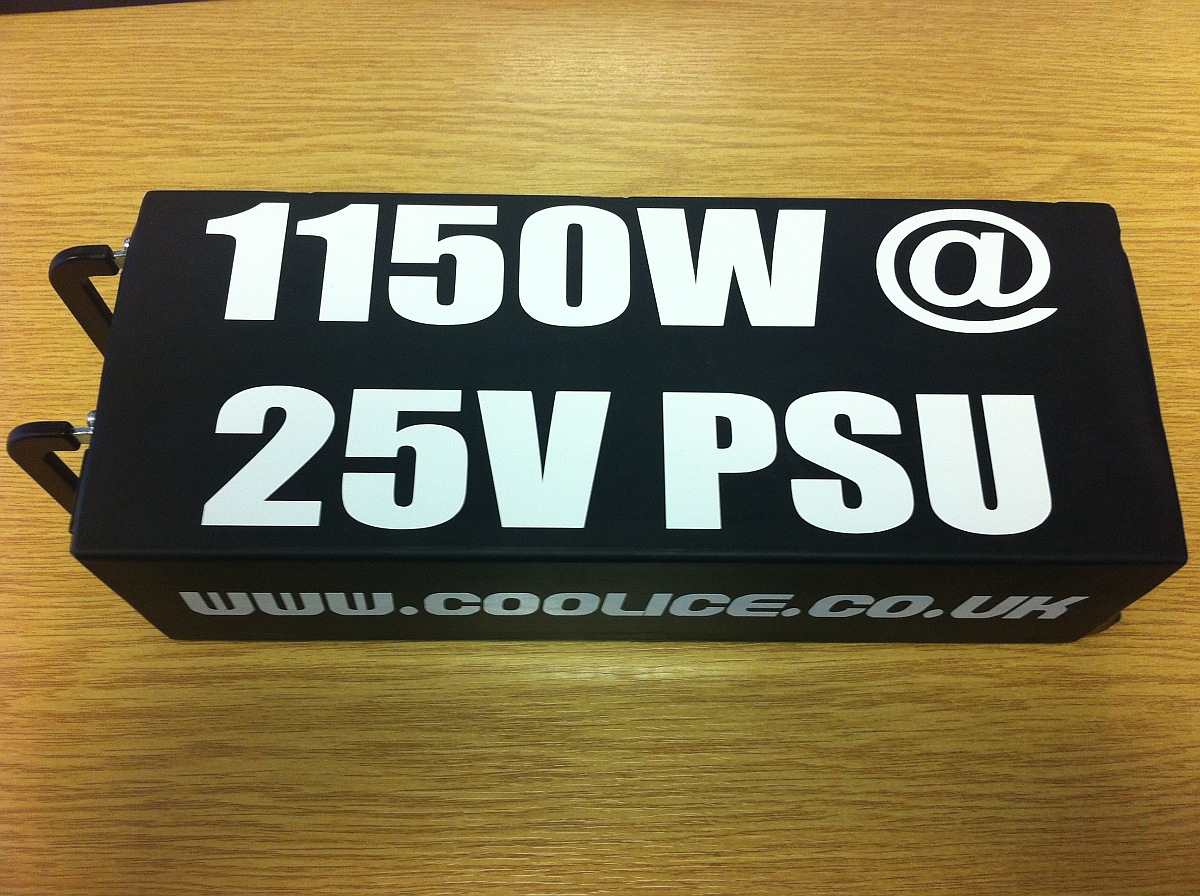

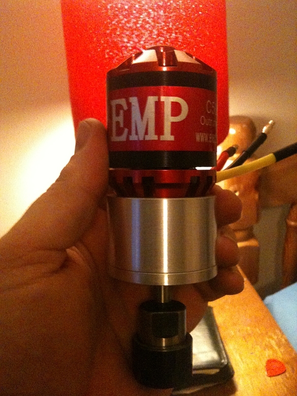

    I've made my own spindle which should put out 1.7kW and I've got a 25V 47A PSU to power it....

    I think you are right not to touch those NSK rails, the damage is way to close to the bearings for my liking. There are some HiWin and THK clones over on AliExpress that looked ok and the reviews I've found are generally positive.
    Does the power supply really have that written on the top? I can't quite tell if it's been "photoshopped" on. You certainly wouldn't mis-read the spec.
  9. #59
    I got it made from a chap on the heli forum I'm a member of, it was going to power my LIPO battery charger but I've got a bigger supply for that now The writing is vinyl stickers so could be peeled off if so wished...

    Just looked at the rails again and the damage is right at the end of the rail, as it's 1390mm long and I only want 1300mm I could cut that off....
