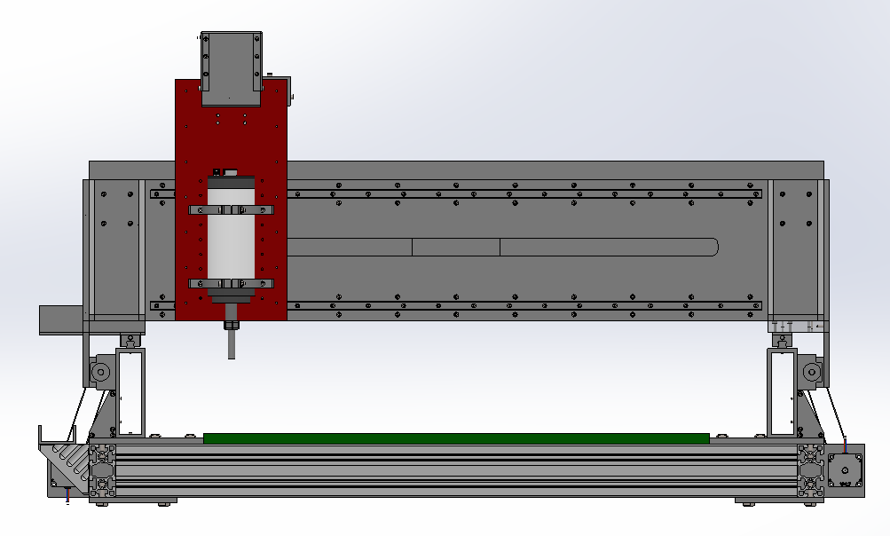

  1. Is the plan still to mount it vertically?...how is it going to be attached to the wall?
    The original plan was to go vertical but the design has grown quite a bit since then to the point where it's not practical to vertically mount it, at least not in my current workshop anyway. When I move to a bigger workshop I might look into mounting it vertically again but to be honest I think what will probably happen is I build a steel base for it and use underneath the machine for storage.
  3. Ah, ok - my next question was going to be how will you level it if its going to be horizontal...but I guess you'd put adjustable feet on the steel frame in that case?
    Also - I got my wrist firmly slapped by Jazz for my design with the stepper motor mounted on the Z axis front plate...he said it should be on the Y axis plate instead to help keep it out of the way & reduce the weight on the z axis.
    For now I'm going to put feet on what you see as the machine will either be on the floor or a bench somewhere. Once it's in it's final home on a proper frame there will be "something better".
    I agree having the stepper on the front of the Z-axis isn't ideal but I don't see it being enough of a problem for me. I moved it from the back plate to the front plate because I had to get power and water to the spindle anyway. Having the stepper on the back plate made getting the cables over more difficult so the front plate seemed like a better choice. As I see it there are a couple of other advantages as well, it's allowed me to lift the z-axis screw up away from the chips a bit and the weight of the stepper will act as a pre-load on that axis.
  5. I thought you'd have your reasons...thought I ought to mention it though ;-)
    Looking forward to seeing the actual build!
    Nah nah not having that Geeky boy I only suggest or recommend if you choose to do it different then I don't give a toss, it's your loss. . Lol
    Quote Originally Posted by Wobblycogs View Post
    It's not a problem(my machines like that) just from experience the other way round is better, allows higher accelerations and Velocity and reduces chances of missed steps on Z axis when working hard doing 3D work.
    No advantages here in real use only Disadvantages.?
    Chips will get in there no matter unless you cover, hence why I fully cover, May not be so pretty but it's the only way to keep chips out properly and increases component life too.
    The extra weight of Ballscrew, 2 x bearing mounts, stepper motor, Stepper mount, belts & pulleys makes a considerable difference to the acceleration you can achieve and extra weight will cause missed steps if motors pushed remotely close to it's corner speed.
    The extra weight acting has preload is hardly worth the costs in performance and extra stress on motor/drive.
    Again not saying it won't work because it does, just works much better other way.!!
    Thanks Dean. Given what you've just said I'll stick with the stepper on the front of the Z and see how it goes. It wouldn't be the end of the world to move it to the back to get better performance if it's needed.
    I've started pricing the parts up, it's looking like the build will come in around the £2000 mark. I'll put the pricing spreadsheet up somewhere once I've finished filling it in as it might be useful to people trying to decide if they can afford a build.
    Ok but I will say " I TOLD YOU SO" when you start asking why Z axis is doing strange things.!!!. . . . . (Oh Did I forget to say My Z axis done like this uses Nema 34 motor.!!)
    Well I couldn't leave it alone :-)

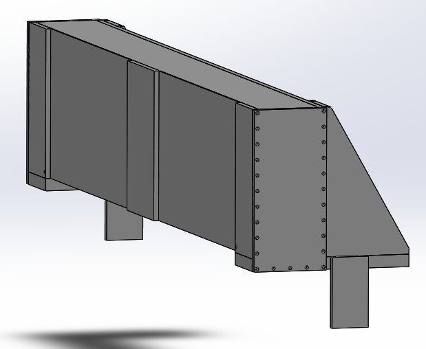

    One quick re-design of the z-axis stepper placement and I can't believe I didn't just go with this all along. Trying to save a few pounds on the z-axis I think was a false economy. This design has the ease of cabling of the previous but with lower z-axis weight as well. Double win, now I've just got to plug all the numbers for the z-axis parts into the spreadsheet again...

    Great. . . . . . Now put a proper bloody cover over the Z axis and give those bearings and screws a break. . .Lol
