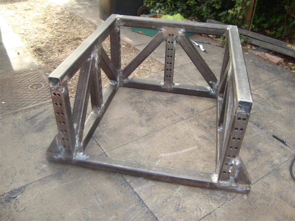

    Hats off to Jonathan’s latest build http://www.mycncuk.com/forums/router...g-machine.html. What a great insight into CNC machine building - the level of detail and open source nature of the build is fantastic and there is no questioning the level of work that has gone in and the result is a good machine – the video speaks for itself. For someone looking to build a machine this and other such posts on this forum are an exceptional source of information – far above and beyond any consultancy invoice. Hard detail is given at every step - invaluable.
    Contextually the build has highlighted the importance of the bed alignment in a CNC system. The welded frame predictably has twisted and bent from the thermal loading generated by the welded frame and this design decision has challenged the use of a profiled rail from the outset. This has been clearly illustrated by the work required to align the rails on the machine and to align the machine for accuracy – tram and twist etc. It may well have been the most cost effective frame build in a DIY context but it is not sustainable commercially. Also the estimated price tag of 4-5k not including the time and extensive know how gives the general audience a feel for the cost and effort that goes into a “sufficiently stiff” CNC router. There is also the question of relieving the stresses in the welds and the long term stability of the bed.
    There is also the question of Mach3 lost position? Possibly due to missed steps perhaps due to some slight lock up – eliminated by the cleaner pulse trains from Linux giving more motor performance perhaps? Unless there is a software issue with Mach (not passing the driver test – or other quirk) then the software fix (move to linux) has potentially overcome what is actually a hardware issue? Perhaps there was a motion controller used with Mach3 and not a LPT - in which case the previously stated possible issues are invalid. These and other comments are based on images and description and are therefore limited in the amount of information available and cannot be taken as conclusive, but purely observational.
    In the words of JAZZ “First let me say not going to pull it apart or condemn because the machine is very well thought out and professionally put together” The comments and message in the previous two paragraphs are aimed at putting some context behind what we feel have been very strong statements towards our design on the basis of a “digital viewing” – handed over in detail and in a timely fashion not attempting to “hide” anything – but in essence are only observational context.
    If every second machine didn’t work with Mach we couldn’t offer it. It has to work every time, every machine. The machine has to be stable long term. The bed is put together with refined assembly processes in Germany. The system is very portable and retains its performance in transit and does not require any tuning on arrival. It arrives and it works. Here are a few videos of the machine being put through its paces. (no backlash/geometric compensation was used in any video posted to date)

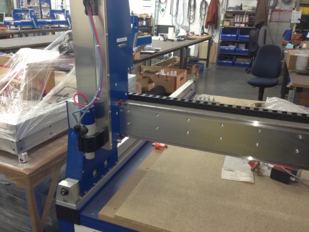

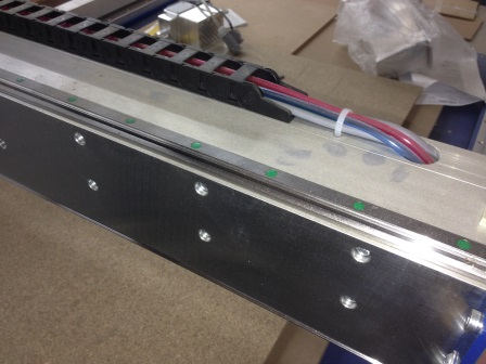

    The JBEC CNC router series linear slide system went through a full digital mock up (DMU) and was also been mechanically tested and refined in a physical kinematic system analysis. For intellectual property reasons further details will not be disclosed. On the bigger machines with a different application space profile rails are used. We are working on a bigger machine currently that will indeed adopt profiled rail due to its size and performance parameters and consequently will have a bigger price tag.
    We feel that such severe comments should not be made on the basis of a digital viewing without access to materials, BOM with fits and tolerances. We, JBEC and our German colleagues welcome criticism based on the machine in action and subjected to tests.
    In light of the above post content JBEC wished to explicitly convey the following message.
    • JBEC has opted not to use welded frames in CNC builds as it is too difficult to machine/prepare the frame surfaces for profiled rails. It is viewed as not a viable option to mount a profiled rail on such a system commercially.
    • JBEC has concerns over the use of welded frames long term, as table stability will be a major concern. Any stress relief or shift in the frame alignment will cause the rails to misalign and the machine will lock up/ torque out.
    • JBEC strives to match the components to suit the design/market sector and end user and to provide an economical and fair cost basis.
    • JBEC recommends the use of only HIWIN or THK Rails on the larger Bed type machines which will be made from machined steel to maximise the accuracy and precision
    • The JBEC series machine is tried and tested, has long term stability and hits heavy in the functionality and performance on offer in the target market and is more than fit for purpose.

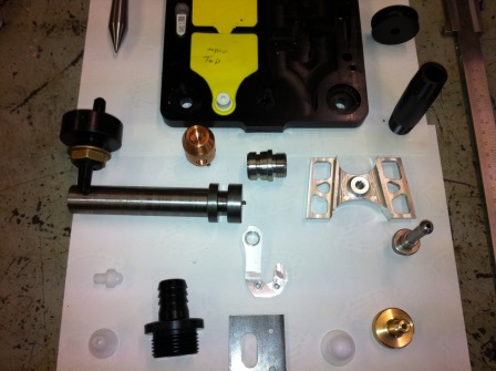

    For what its worth here are a few examples of work done in house just to show that we are not just a CNC supermarket.
    Aluminium bike parts
    In house machining

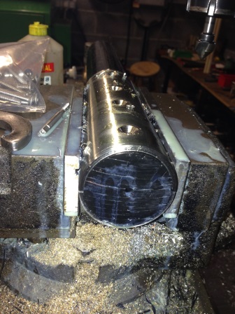

    In house machining

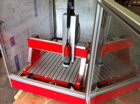

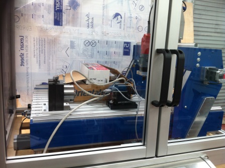

    Built enclosure for small machine

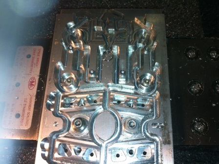

    Mould machining
