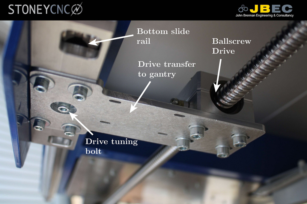

    Figure 4, shows the mechanism used to transfer the drive from the ballscrew carriage to the bottom slide rail. Note the 5 bolts in the mouing system connected to the slide rail. The 4 outside bolts fasten the aluminium panel to the slide for the drive transfer. The middle bolt is used to tune the gantry position - and is discussed further below.
    Figure 4. Bottom rail and drive system assembly

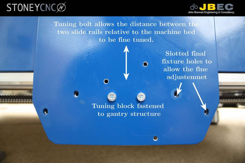

    Figure 7(b) shows the gantry side aluminium panel and shows the two bolts fastened to the tuning block as shown in Figure 5 and Figure 7(a). The 4 other holes shown are slotted to allow the tuning bolt to be used to adjust the slide setup. Once tuned and adjusted the holes are fastened and the gantry is ready for final assembly. The system is modular and therefore easy to change, service and tune long term. The result is a very stiff structure that provides excellent support in all directions apart from the direction of motion where linear almost frictionless travel can occur
    Figure 7 (a). Bottom slide assembly setup
    Figure 7 (b). Side panel for drive tuning

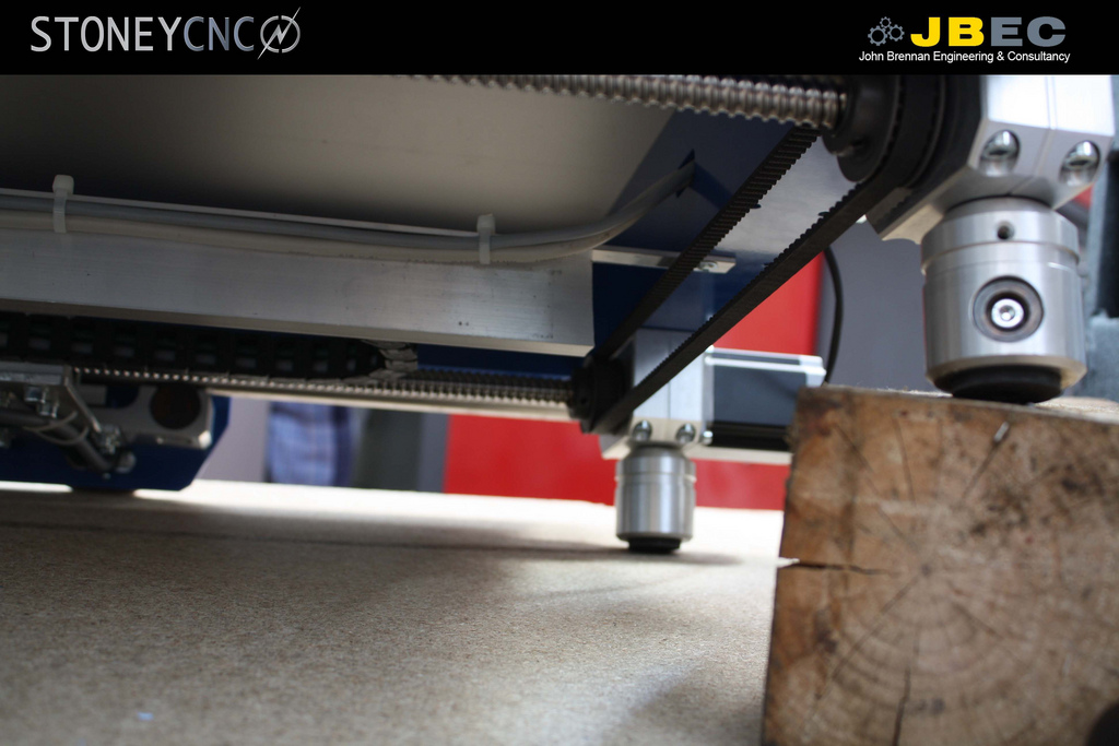

    Figure 9 shows the two ballscrews used to drive the gantry structure. Both the side pillars therefore have their own drive mechanism from each of the two ballscrew carriages. Figure 10 shows the cable management under the machine bed used to transfer the drive motors and spindle cables up into the gantry tower structure. Figure 11 shows the drive distribution from the stepper motors to the two ballscrew pulleys driving the two Y axis ballscrews.
    Figure 9. Dual ballscrew drive

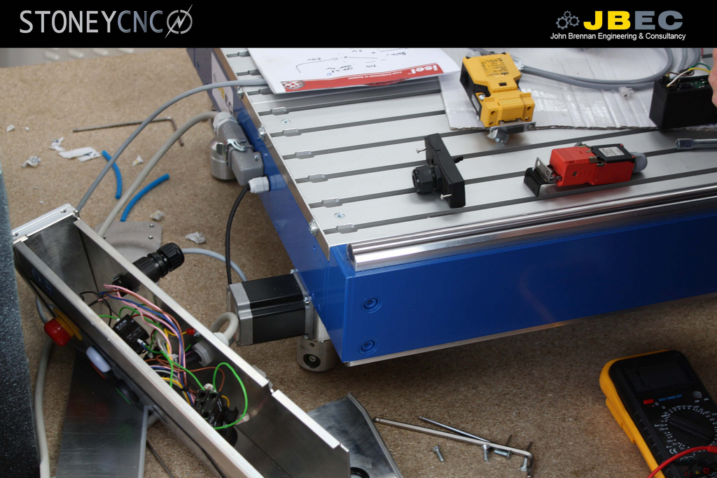

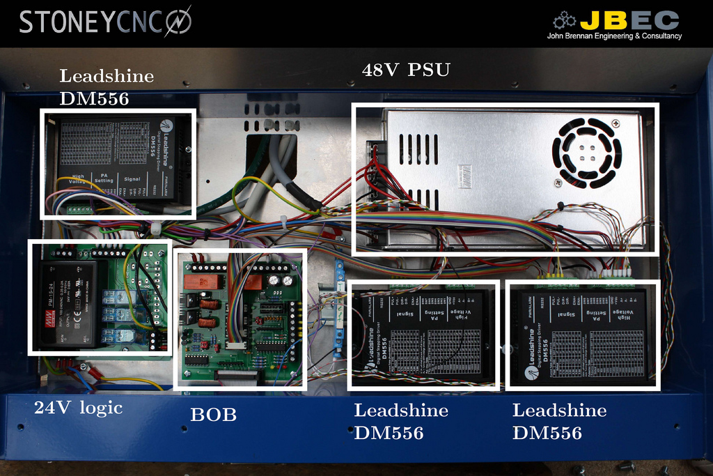

    Figures 15 and 16 shows the control electronics. She runs on a 48V PSU matched to the oriental motors specs running each of the three axes. There is a BOB for the LPT logic distribution from the PC side and there is a 12V relay board for the user interface buttons on the machine control panel. Figure 17 shows the innerds of the machine control panel. The latched start, stop, Estop and spindle on/off override switch are all operating safely on 24V running back to the relay card. 230V AC comes in and up through the machine for the spindle only and does not come through the control panel.
    Figure 15. System electronics
    Figure 16. AC in and LPT connection and 4th axis connection.
    Figure 17. Control panel work
