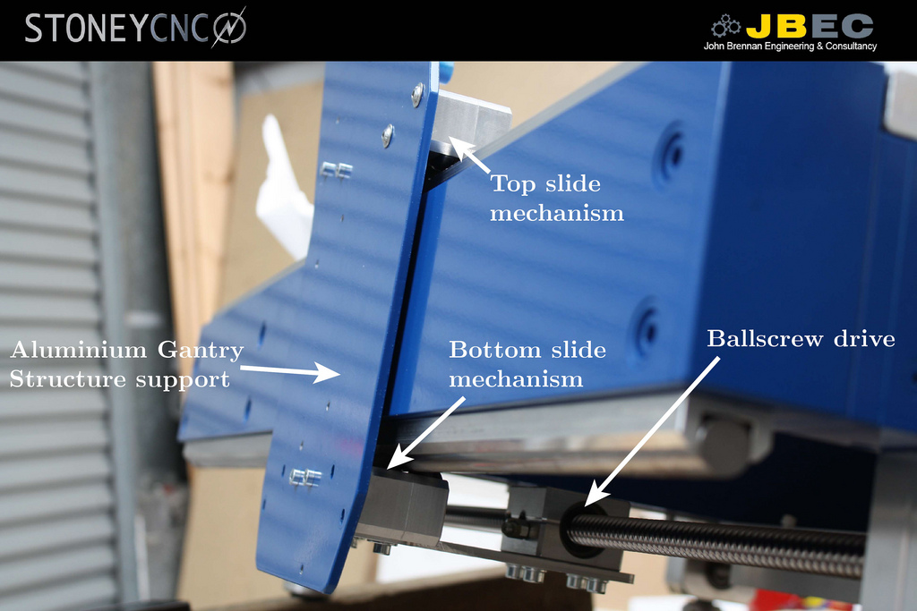

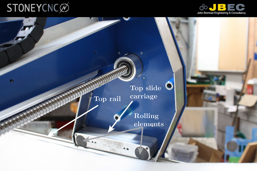

    Figure 3 shows the top slide rail mounted and bolted to the main side aluminium panel. A second inside panel covers the assembly shown and increased the torsional stiffness of the frame as it is shown. Shown also is the ballscrew encapsulation at the opposite side to the motor.
    Figure 3. View of the slide rail mounted on the bed.

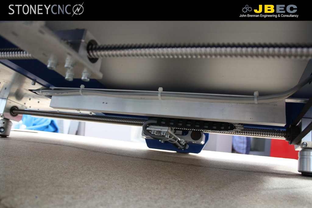

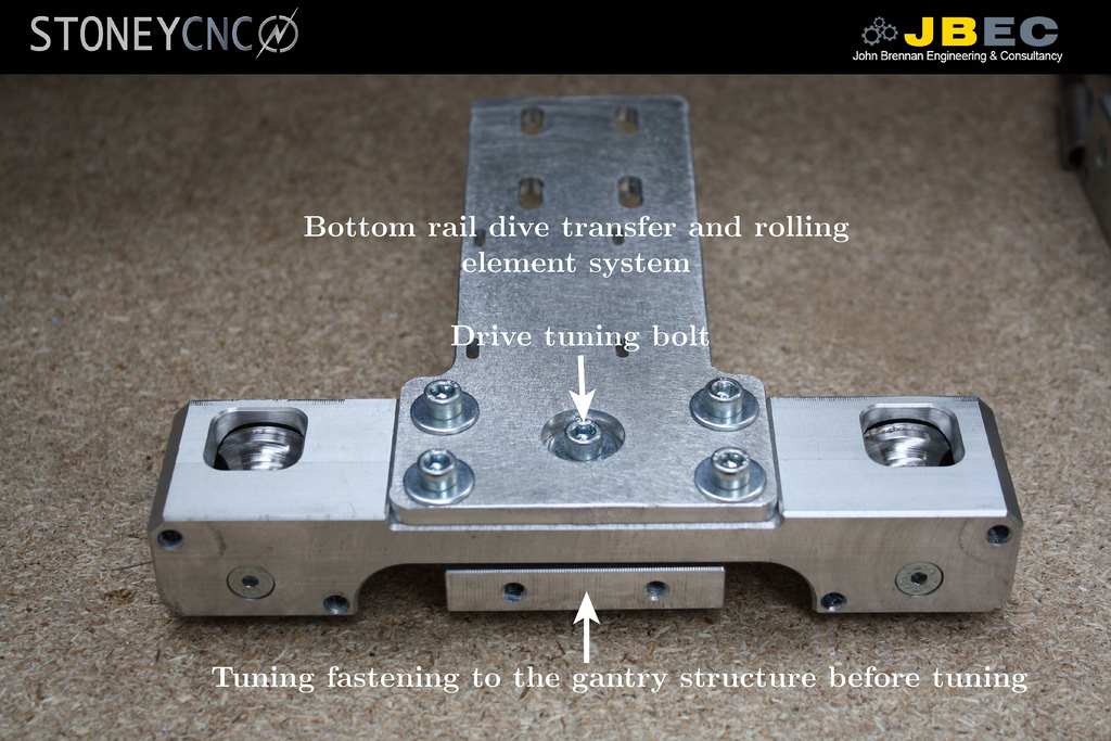

    Figure 4, shows the mechanism used to transfer the drive from the ballscrew carriage to the bottom slide rail. Note the 5 bolts in the mouing system connected to the slide rail. The 4 outside bolts fasten the aluminium panel to the slide for the drive transfer. The middle bolt is used to tune the gantry position - and is discussed further below.
    Figure 4. Bottom rail and drive system assembly

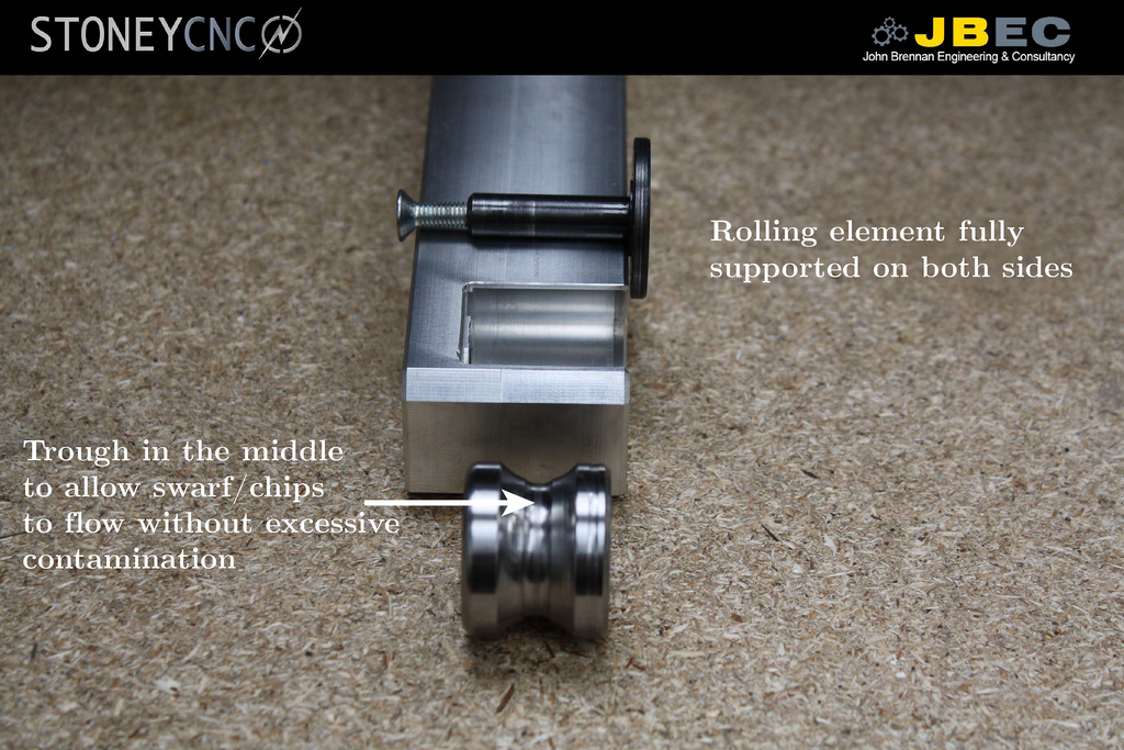

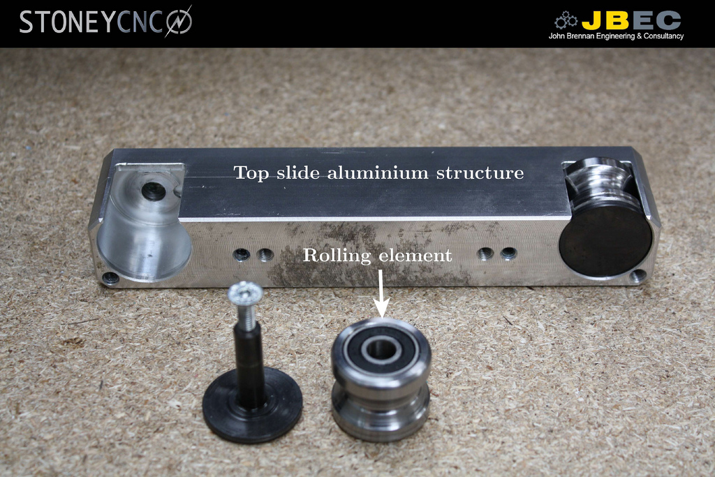

    Further to Figures 3 and 4, Figure 5 shows the linear slide disconnected from the slide rail. Shown are the rolling elements used to interface with the slide rail. Note also the tuning block connected with the tuning bolt shown in Figure 4.
    Figure 5. Image shows the exposed rolling elements
    Figures 6(a) and (b) show the linear slides composition with the rolling element shown. The rolling elements are supported on both sides and have two internal bearings. Not also the trough in the rolling element that allows some leeway for swarf and other possible contamination getting into the drive system.

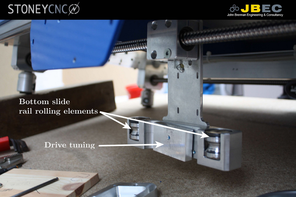

    Figure 7(b) shows the gantry side aluminium panel and shows the two bolts fastened to the tuning block as shown in Figure 5 and Figure 7(a). The 4 other holes shown are slotted to allow the tuning bolt to be used to adjust the slide setup. Once tuned and adjusted the holes are fastened and the gantry is ready for final assembly. The system is modular and therefore easy to change, service and tune long term. The result is a very stiff structure that provides excellent support in all directions apart from the direction of motion where linear almost frictionless travel can occur
    Figure 7 (a). Bottom slide assembly setup
    Figure 7 (b). Side panel for drive tuning

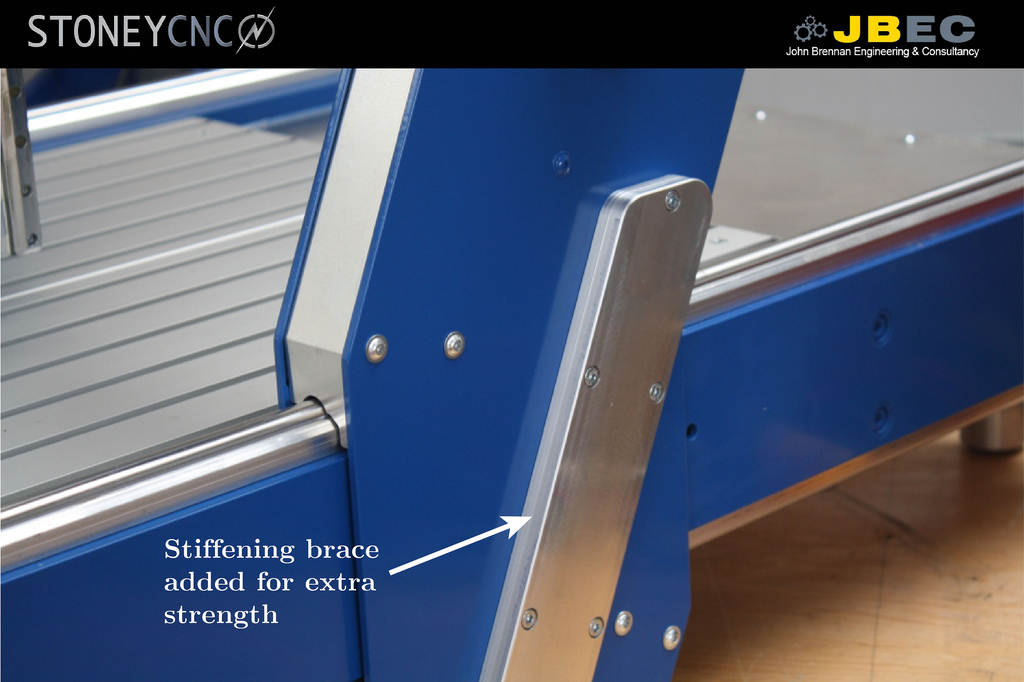

    Figure 8 shows the extra aluminium side brace installed to provide extra stiffness through from the ball-screws into the gantry tower.
    Figure 8. Stiffening plate

    Figure 10. Cable management under machine bed

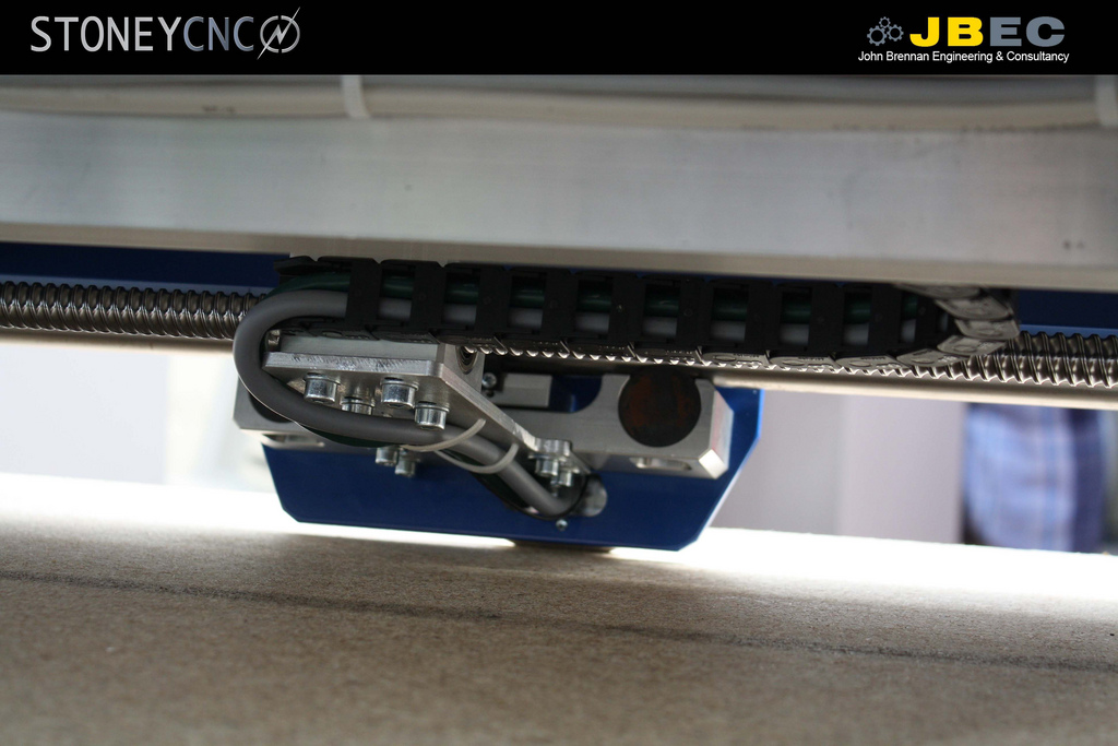

    Figure 11. Belt drive to the two ballscrew pulleys.

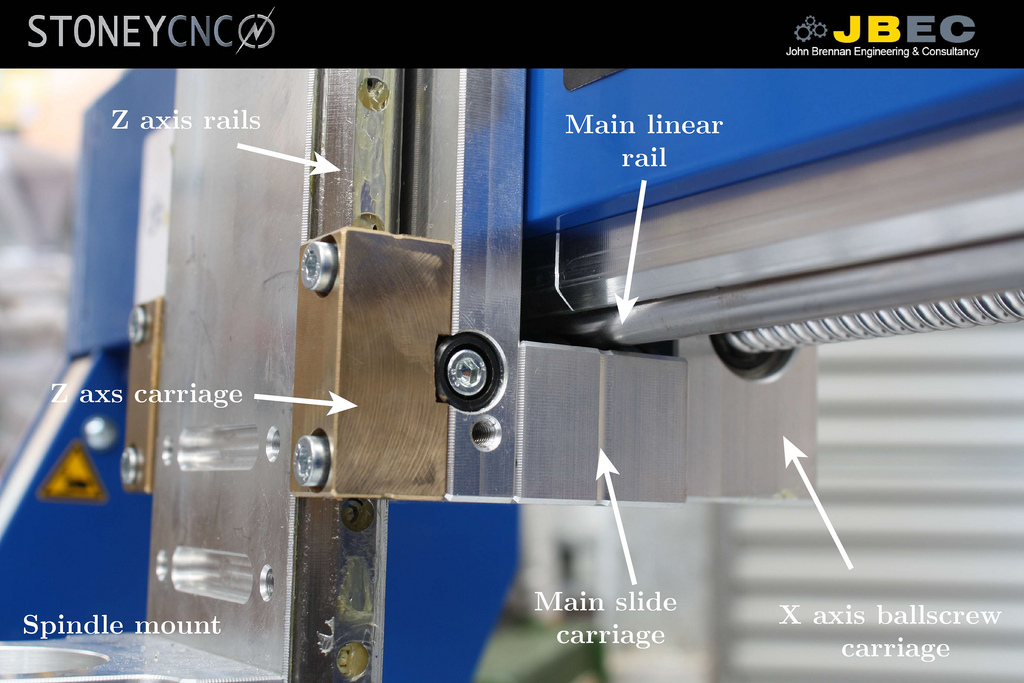

    Figure 12 shows an overall view of the Z axis slide and drive mechanism. As shown the upper and lower z axis guides are spaced apart such that they are located in the same locations on the gantry as where the X axis slide mechanism mounts on the main X axis slide rails. This is further illustrated in Figures 13 and 14. Figure 14 shows how the ballscrew drive will transfer force directly at the same location as the main X axis carriage system, and from there directly into the X axis guide system.

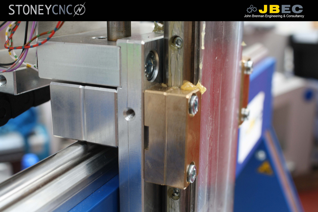

    Figure 13. Close up of the left hand side upper prismatic guide

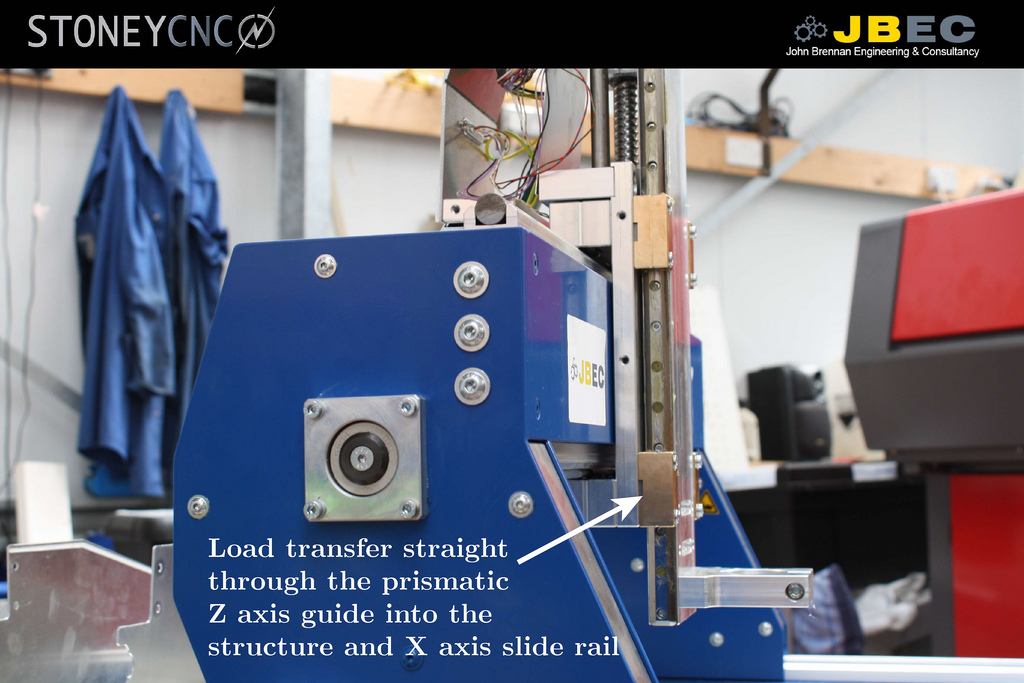

    Figure 14. shows how the process forces are translated into the gantry tower structure.
    If ever you are put in front of a CNC router system you are about to part cash with. I would ask every customer to look at this aspect of a machine as it plays a core role in the machine performance. If you grab the spindle structure (not too hard in case you break it before you've bought it :) ) and put some pressure on the structure in all directions and see how it performs. What your doing essentially is simulating a cutting process where you are putting forces on the machine. The level of "play and delfection" will dictate the performance.
    You will pull the machine off the table before you bend and flex the gantry structure with any significance on this platform.

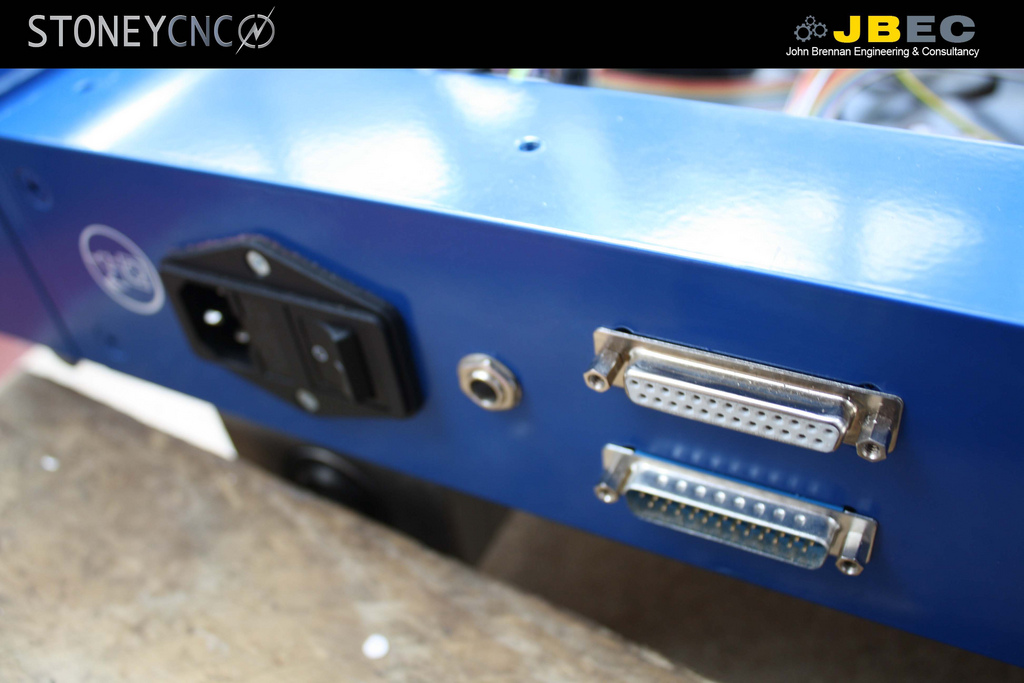

    Figures 15 and 16 shows the control electronics. She runs on a 48V PSU matched to the oriental motors specs running each of the three axes. There is a BOB for the LPT logic distribution from the PC side and there is a 12V relay board for the user interface buttons on the machine control panel. Figure 17 shows the innerds of the machine control panel. The latched start, stop, Estop and spindle on/off override switch are all operating safely on 24V running back to the relay card. 230V AC comes in and up through the machine for the spindle only and does not come through the control panel.
    Figure 15. System electronics
    Figure 16. AC in and LPT connection and 4th axis connection.

    First let me say not going to pull it apart or condemn because the machine is very well thought out and professionally put together. far far removed from like of strike CNC and some other 'Merchant's' that are dicey.! . . . I congratulate on the professional way it's done and presented.
    What bothers me is the the fact you have what is basicly just a supped up version of skate board bearings coupled with very flimsy gantry sides connected to flimsy ballnut brackets. Now for £5100 for machine and Electrics only, I would expect much more for my money with real profiled linear rails and substantial frame.
    With this rail system and weak frame work I foresee that this machine will be very baggy within side 3yrs if worked 8hrs day and will require plenty of maintenance and setting up to keep accurate much after the newness has worn off.!!
    Personally for best part of 6k investment with PC, spindle etc I'd want better than this machine provides. That said for Hobby use then it's rail system and IMO weak gantry are fine, It's just far too expensive.!!

    I agree that the ballnut mounts in particular look much too thin, and that for the amount this costs you should be getting proper linear guides not glorified skate bearings.
    No. If you clamp an indicator to the bed and touch it against the spindle or Z-axis and try what you suggest you'll see plenty of movement on the dial. I agree you probably wont see the deflection before pulling the machine off the table, but that's besides the point since the tolerances required for a good CNC router are well below the distances anyone can see. Can you see 0.1mm deflection?
    If I was buying a CNC router I'd take a dial indicator, a force meter (e.g. cheap hanging scales would do) and a piece of string with me, then use them to do, at the very least, the following tests:
    • Set the dial indicator up to measure the deflection in each axis and apply a suitable force, divide the two readings to find the stiffness of each axis and compare that to typical values or other machines.
    • Use the indicator to check the backlash of each axis. For any machine that uses ballscrews and is set up correctly, the backlash should be less than about 0.05mm in X and Y. If Z uses rails with low preload, the backlash should be close to zero as gravity pre-loads the axis. If it isn't then that implies the rails and ballscrew could be misaligned.
    • Again set the indicator parallel to each axis, and give each axis/slide/ballscrew a sharp tap. The indicator needle will oscillate and should return to zero (+-backlash). If it doesn't return to zero then something's loose or the ballscrews aren't mounted properly. If the indicator oscillates for a long time before returning, then I'd be concerned that the machine will resonate when cutting.
    • With the indicator in the spindle, put a large mass on the machine bed (e.g. sit on it), and see how much the bed deflects.
    • Mount indicator in spindle on L-shaped bar and use it to check the spindle is in tram. This is less significant than the other points, since you should be able to correct it without too much difficulty, however it's a good sign of how carefully the machine has been built

    And 100% if you put our system up against a metal milling machine then yes 100% the slides are not fit for purpose and the gantry is made of chewing gum! Also - anyone who is clued in and has access to fabrication facilities could indeed put together a platform with more performance for less... not accounting for the time, design and nouse to do it. Volume production, installation and follow up support to run a business are, as I'm sure you know, a different story.
    If someone could build, supply and support a machine to the same quality level as use then I want to see it!
    And yes again - profiled rails TKH, HIWIN etc are phenomenal pieces of hardware! And when I first saw that particular slide design concept I was also initially sceptical. However - the Germans know what they are at and I have been proved wrong!
