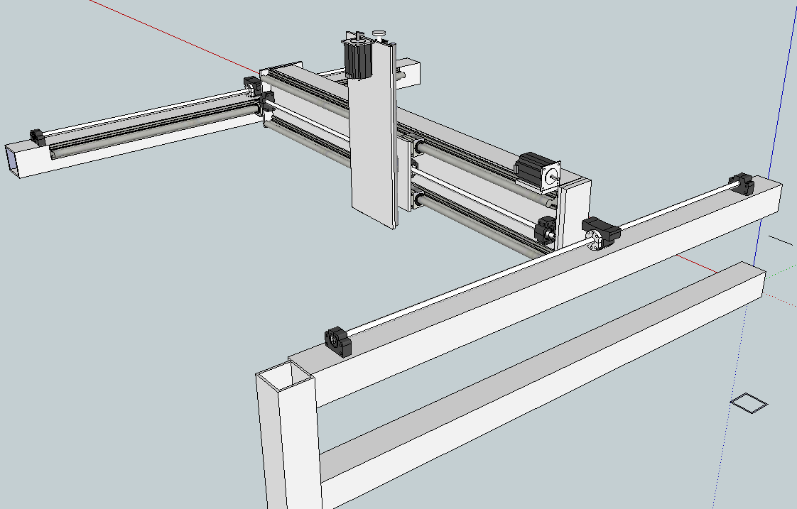

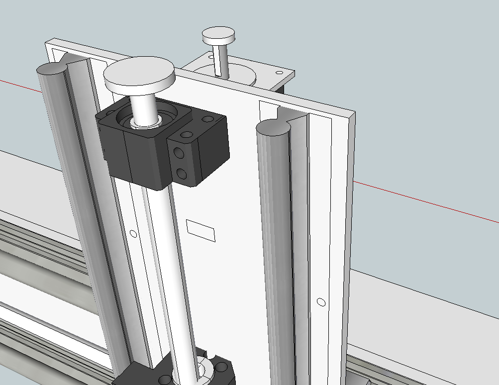

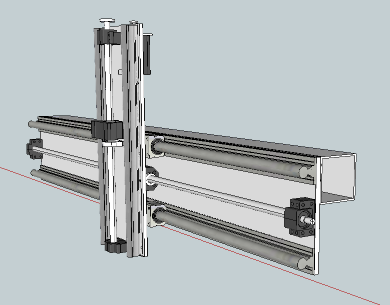

    On request of fellow members of this forum, I think its prudent I make some drawings discuss all my ideas etc before I go balls deep and order the gear. So today has been a crash course in 'sketchup' which incidently ROCKS. Ive attached pictures of my gantry design
    It is, to be fair a bit similar to motoxys. But as there was so much discussion around this subject I hope he doesnt mind me harnessing the wealth of ideas around this very subject.
    So assuming the gantry is 1300mm does this look about ok?
    (If there is anybody out there, not used sketchup before, or just want to copy this design, ive uploaded my sketchup file for the below for free download to anybody who is interested http://www.pensys.co.uk/cnc1.skp

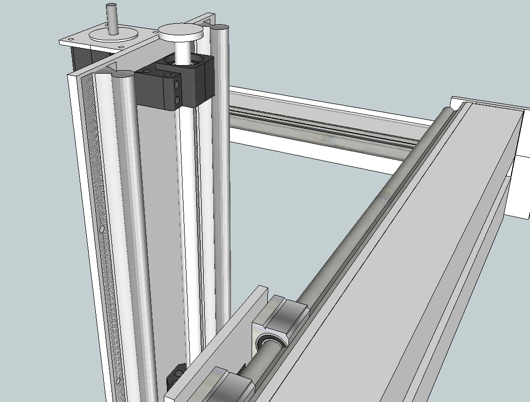

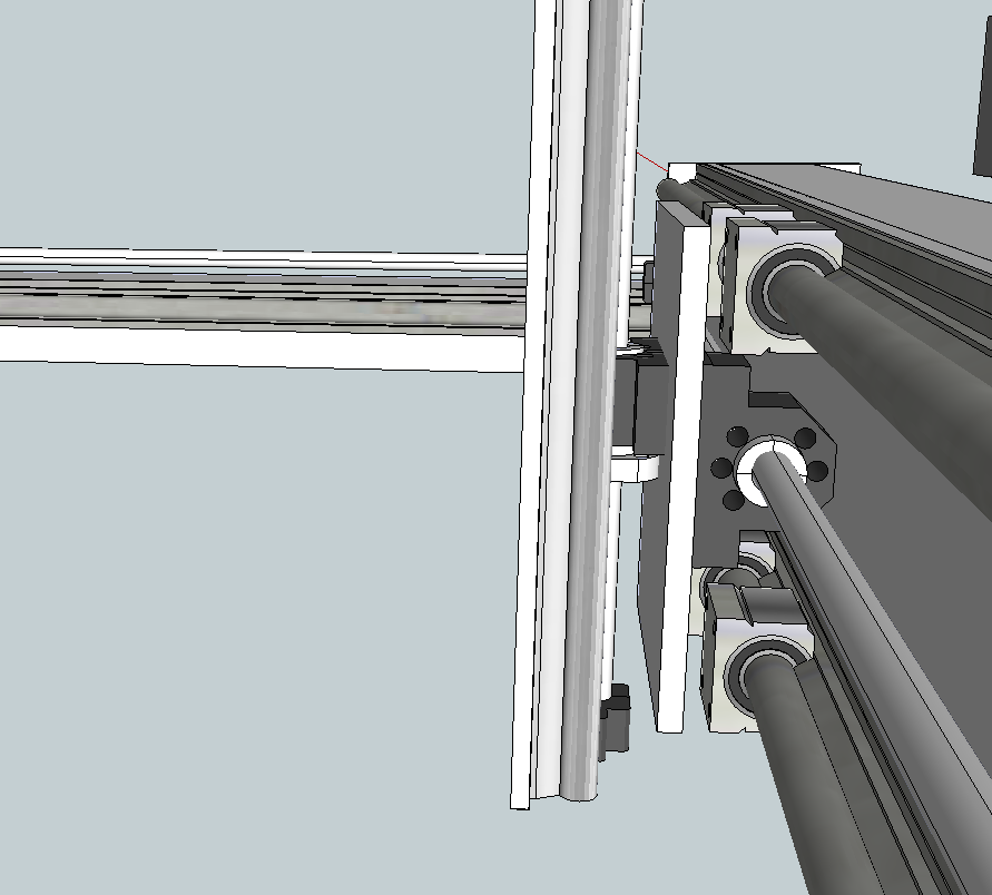

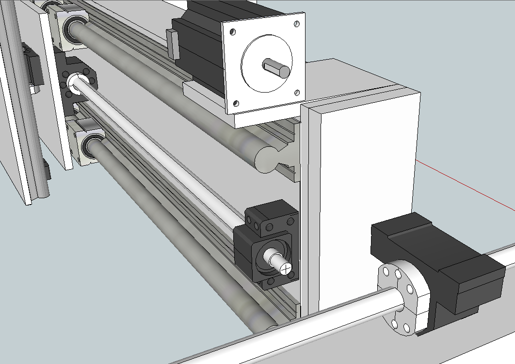

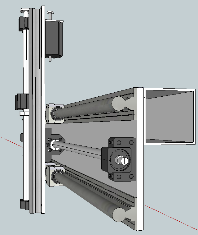

    spent most of last night laying awake. I get a bit like this when im 'on one' with something like this.
    The more I read, the more ive established that the cutting ali is all about getting the strength in the right places. You dont want things flexing. I fear this may be copying another idea ive seen somewhere, but instead of having big lanky gantry support uprights with the linears at the bottom... how about having the linear rail at the top. this way, I dont have to decide now what the maximum height I want to work with is, plus I think its likely it will be very rare that im dealing with anything 'deep' as such. therefore I can cater for bigger objects by lowering the cutting deck and from an amount of movement I have available in my z axis?
    I have an abundance of wood available to me, so Im thinking the uprights and cross members that support the Y linears etc (the table as it where) is going to be made of wood. then the gantry out of ali... does anybody think this is a really bad idea?
    anyway, ive made some more pictures available...

    I think im going to have two ballscrews for the gantry (one at either side) with two steppers.
    The design you've just posted with the tool operating below the X-rails is far stronger, especially with an adjustable height bed. See mine here (or come and see it in real life if you want), don't pay much attention to the Y-axis though as that's weak.
    I do...it is far easier to make a machine to cut aluminium efficiently if you only use metals in the design. You'll need to use coolant if you're cutting aluminium regularly and clearly the wood wont last long or stay put if it's getting wet. You'll be much better off with making a steel frame. I get steel box section from a place called Adey Steel in Loughborough, which is not too far from you. 60mm box section is a good size for the frame and if you stick to 3mm wall thickness it's much easier to weld with a cheap welder.
    Not sure what thickness it is in the drawing, but the Z-axis plate looks a bit thin. 20mm thick is a good size.
    Put a few supports for the long rails on the frame to help stop them bending towards the middle.
    (Edit, forget this bit - written before previous post.
    With the one piece of box section the gantry torsional stiffness is quite poor - imagine what happens when you apply a force to the cutter when the Z-axis is at it's lowest point, the gantry will twist. If you just put a second piece of box section below the top one, aligned to the bottom face of the aluminium plate then the torsional stiffness will be much improved.
    If you're after 1m travel then a 1300mm wide gantry is a bit generous since 200mm is plenty for a Z-axis.
    Instead of putting the rails for the Z-axis on the Y-axis carriage, put them on the plate which holds the spindle and moves up/down and have the bearings attached to the Y-axis. This is generally a stronger configuration, especially with an adjustable height bed, since it minimises the vertical distance between the cutter and the support bearings (the overhang). This also can save some aluminium, depending on where you put the stepper motor.)

  5. Another thought/idea: if you're going for that layout is to consider putting the x-axis motors/rotating ballnuts on the gantry rather than rotate the ballscrews. This way you could easily upgrade from 1m to 3m by changing out the ballscrews & x-rails and retain the same motors/etc. and you dont need to invest in expensive bearings for the ballscrews. The downside is marginally more weight on the gantry and constructing rotating ballnut mounts is more tricky.
  6. The Following User Says Thank You to irving2008 For This Useful Post:
  7. #5
    Like that Idea, I noticed on Jonathons this idea was used, but disregarded its main advantage. This way I could buy, say 2m x 1m setup now. make the gantry 2m and the x axis x axis 1m. If its as successful as I hope I can then re-make the x axis longer. Need to think of a cunning way to make the rotating housings... I can worry about that at a later date. Going to start from scratch in sketchup again. this time with my newly quoted 60mm steel box from Adey Steel, and with the new design wide gantry and static screw.

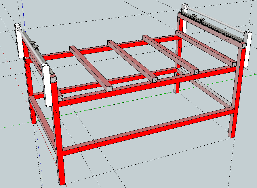

    thanks for the comments gents.
    however, although id love to build a machine 3x3. I cant afford too!. Im simply make the biggest I can whilst maintaining my marriage :D
    anyway, done a bit more on the design. but those bearings look mighty small for such a large spanning gantry....
    might have to have a re-think...
    what do you guys think?Click image for larger version.

    I don't like the bed being unsupported over a 3m length. You can at the very least mount a piece of steel box section vertically at the back and the front, but the front one would have to be removed when you make the axis longer. A third piece of 3m long box section in the middle wouldn't go amiss either. Also I would make the bed bolt on to the 4 verticals on the other side, again to make it easier to extend the bed in the future. Currently the frame can 'skew' quite easily, since there are no triangles - so add some pieces to make triangles! You can do this in all 3 planes which is a good way of using up the left over box section since no doubt you'll be ordering in 7.5m lengths. Incidentally how much did Adey Steel quote you for the box section, presumably 60x60x3mm? Their pricing seems to be a bit random...
    The way you have mounted the ballscrews is good since it allows adjustment of the height via moving the 4 pieces of box section, which is nice and strong. You can make the end mounts fasten to the box section via holes slotted horizontally to get adjustment in the other axis, which will help when aligning the ballscrews.
