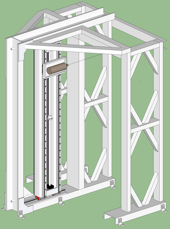

    New poster, but been lurking on and off for quite a while now. I want to build a router for cutting Wood & Ali as a hobby.
    Was going to build a Mechmate a few years ago but had to give up my rented workshop, so it got shelved.
    Now I intend to build a more "garage friendly" machine as that's the only space available!
    Been through a lot of design ideas, looked at alot of designs on here and that american forum etc.
    I was recently heavily influenced by Jazz's Vertical router test thread.
    My main design philosophy/goals are.
    • Acccuracy as good I can make it.
    • Over engineer when in doubt.
    • Use the large amount of steel I have in the garage from my aborted Mechmate build. Also some electrical stuff Geckos , Bobs etc i bought.
    • Mixture of Bolting & welding, but restricting welding to non critical areas due to me being a crap welder!
    Overall machine size is 1500 wide, 2000 tall & 1350 deep. (I missed most of that off the Dims. Doh!)
    Cutting area is 700 x 1580. Z axis travel is ~250mm.
    The frame is steel made up of a mish mash of steel i already have.
    The large channel is 200x75, most other stuff is 100x50x4 (channel & tube) & 50x50x3 tube.
    The moving Y/Z axis which is the width of the bed is made up of 2 100x100x6 tubes with a full back of 6mm plate.

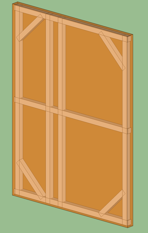

    The orange base is epoxy/granite with steel inserts.
    I intend to use gauge plate for the mounting plates etc.
    Hiwin 30mm rais & carriages (over the top i know, but i have a stash of 6 of em i got cheap a while ago.)
    Chinese 20mm ball screws.
    For motors, i already have nema 34 3.9Nm steppers & gecko's
    Its basically 5 parts. The big Y gantry, the two side frames,top stiffeners, all tied together using the epoxy base.
    The moving X axis only has to deal with cutting forces, inertia and friction. Not it's own weight as far a deflection is concerned.
    Ditto for the Z.
    The only part fighting gravity is the Y. A small mounting plate for the spindle.
    Here are some early drawings. I would be most grateful for any feedback & advice.
    Don't be shy. You won't hurt my feelings!
    Greeny
