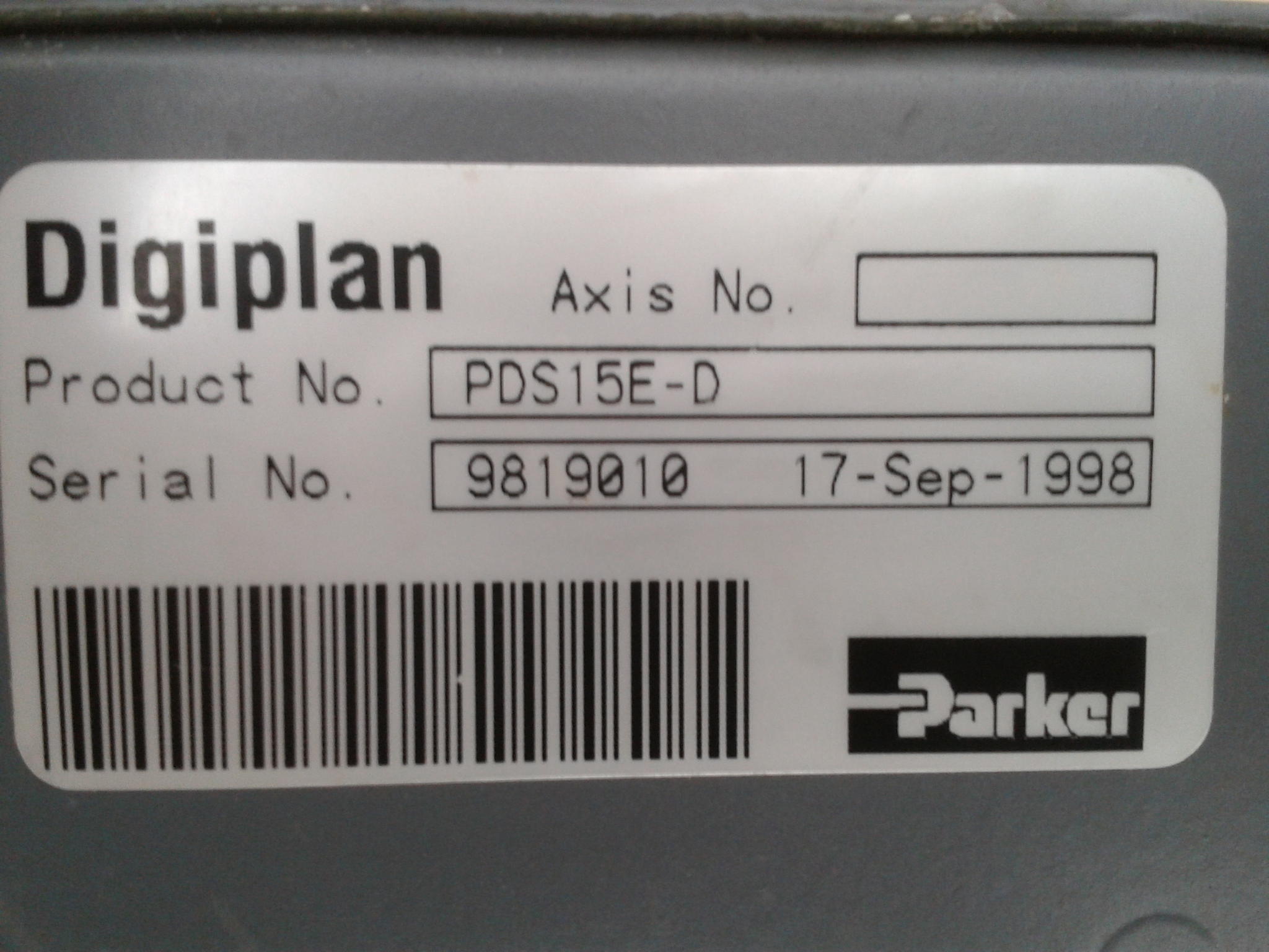

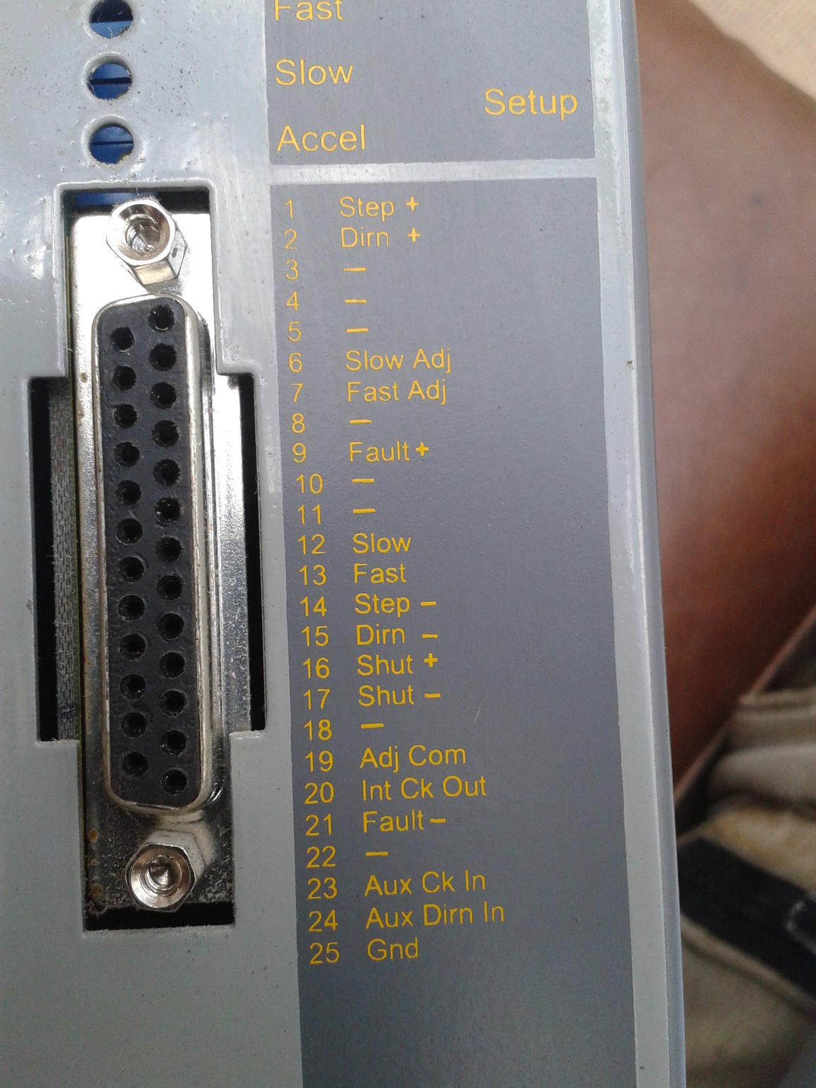

    got these from a scrap machine, as they look quite professional though maybe i could use them on my upcoming build, i considered if i could connect the break out board correctly it should work (should is the magic word), after all it only needs a few wires connecting to get it going, i did like the fact it only needs 240v kettle lead to work , no need for power supplies although i did get a switchmode supply and a 4 way indexer which im sure i dont need, cheers Nik

    Looks like step and direction into 1 and 2 then 14 and 15 link together and go to ground on the BOB
    No idea how you set amperage though ?

    Looks like the dip switches at top John.?
    Can you show pic of those switches Drnik.
  5. any part numbers or other identifying marks?

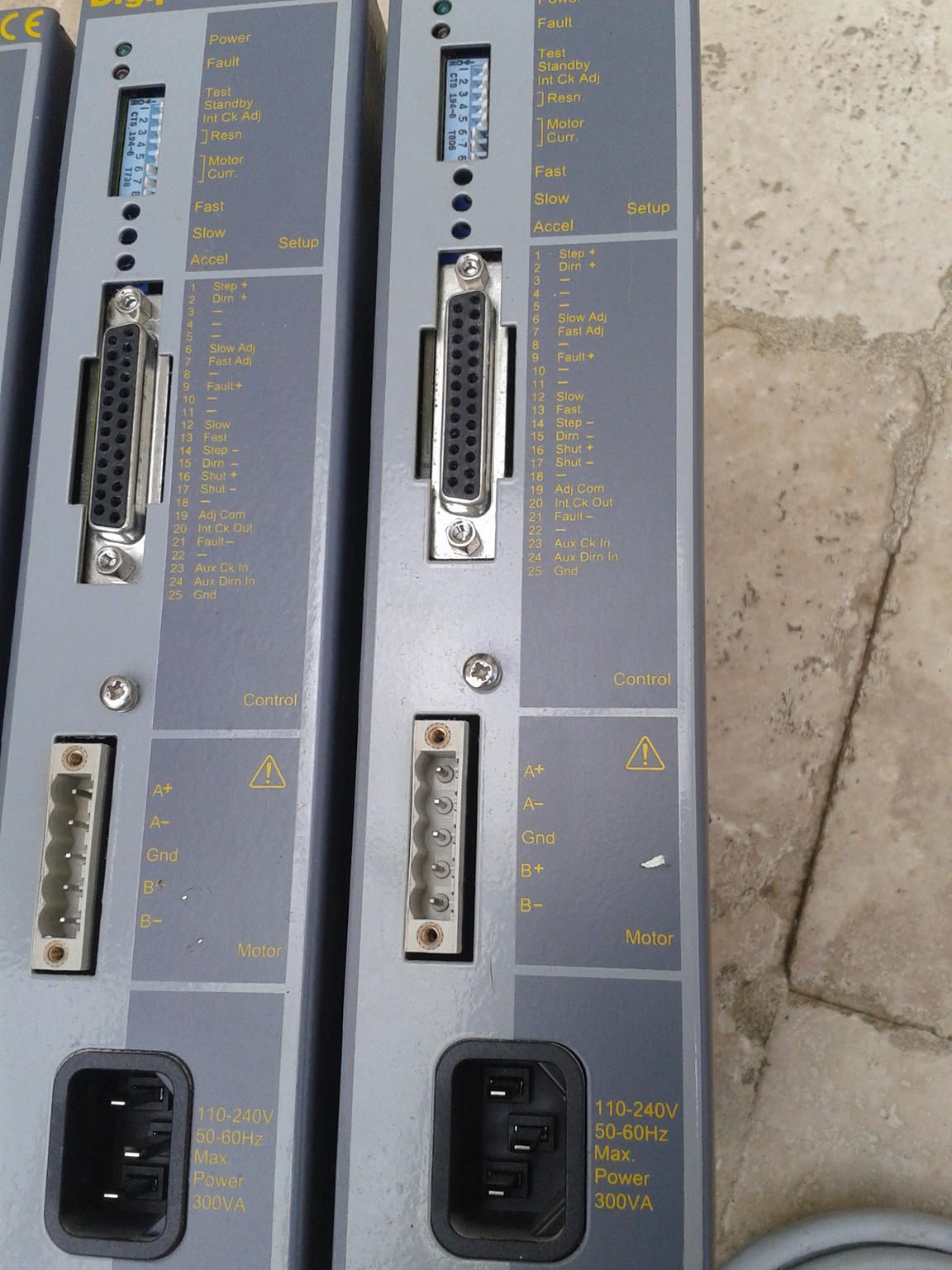

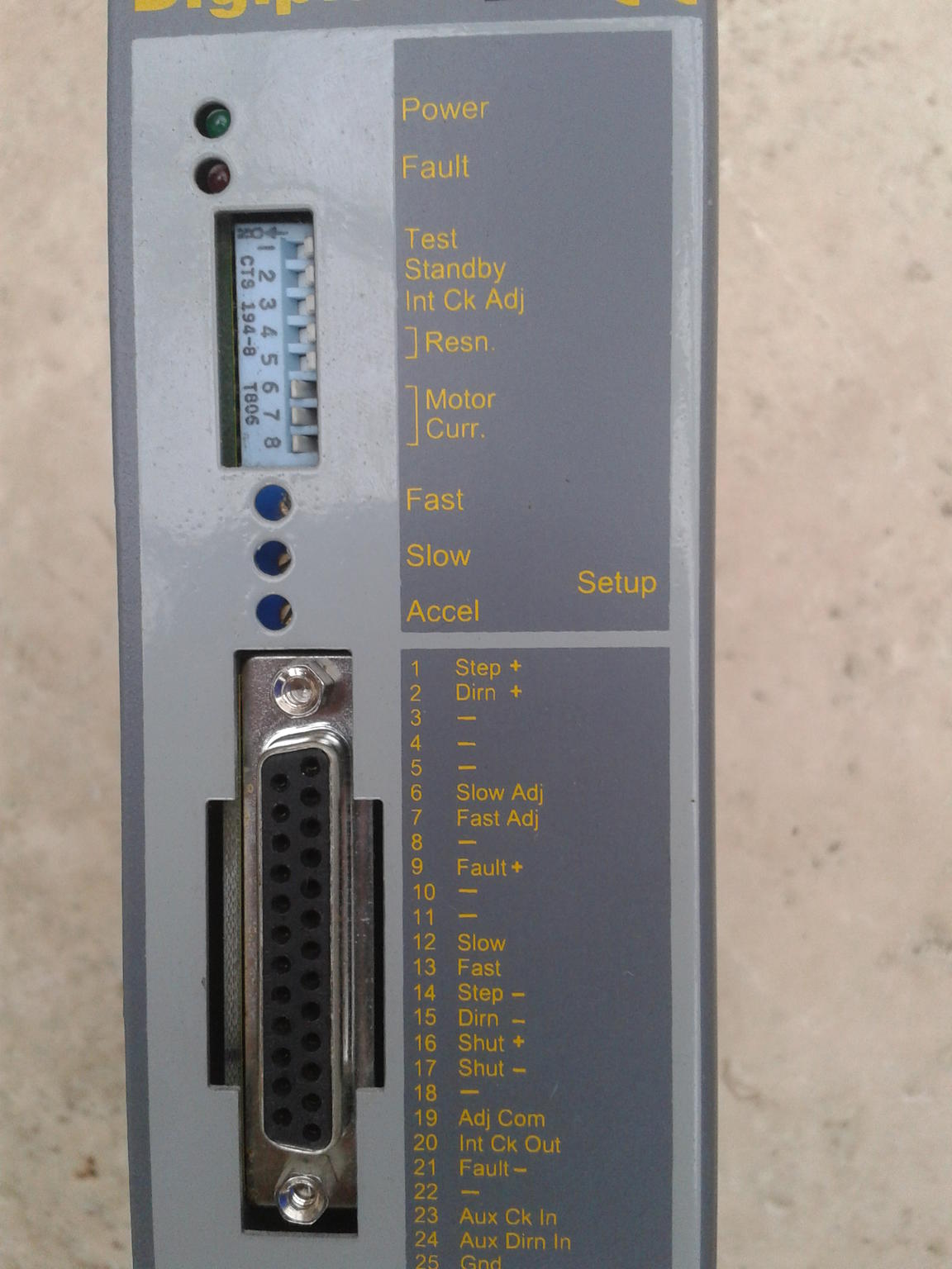

  6. The bottom 3 switches of the top bank are labelled 'motor curr'. Also 2 switches labelled 'resn' I'd guess are microstep setting?
    More intriguing are the 'setup' trimmers for accel, etc.

    Hi John
    We use this Parker equipment at work send me a pm with the model numbers I think we will have the manuals for them.
    Andy
    You can tell I hav'nt been on here for a long time!
    Nick send me your details including model numbers I,m sure I can help.

    Hi Irving
    These are used with DIP Switch 3 where you can have internal speed control.
    well cheers Andy, i'll post these pictures

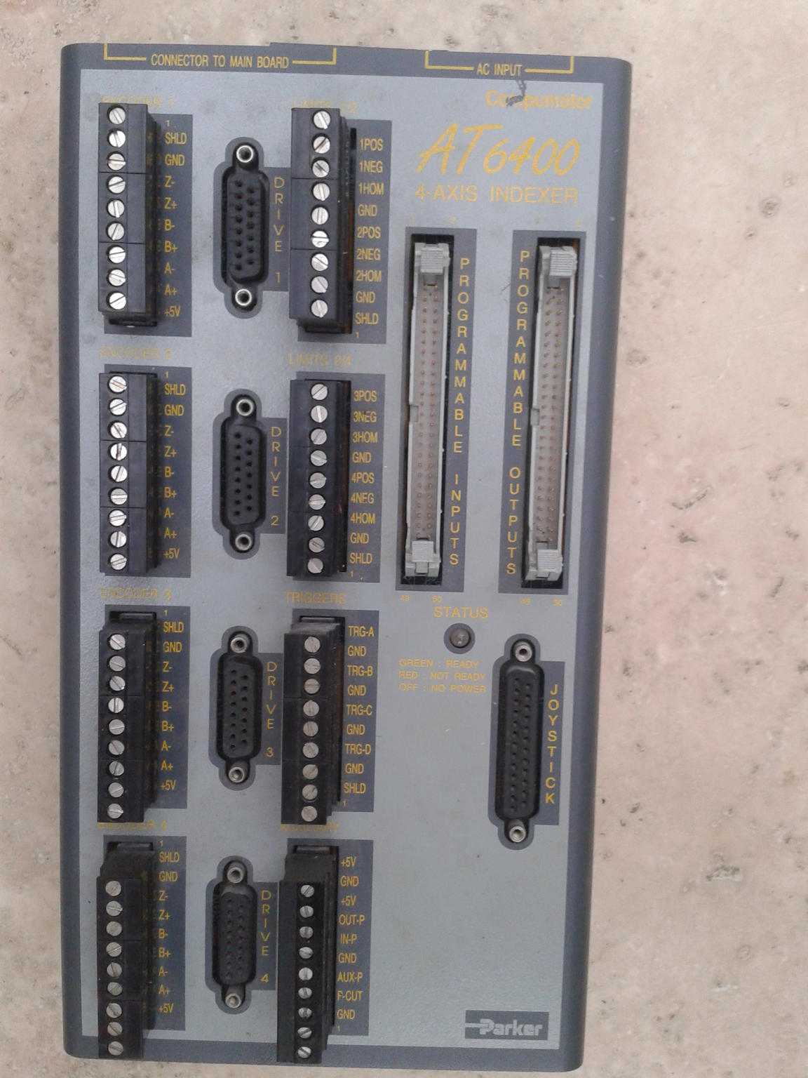

    i also got this as it was attached to the 3 drivers, im not going to be using it,

  10. Manual here http://www.parkermotion.com/manuals/PD/PDS_E.pdf‎
    2.5A min, 5A max driver in 350mA steps
    step settings 400, 1000, 2000, 4000 (i.e. 1/2, 1/5, 1/10, 1/20)
    opto-isolated inputs
    regenerative dump circuit
