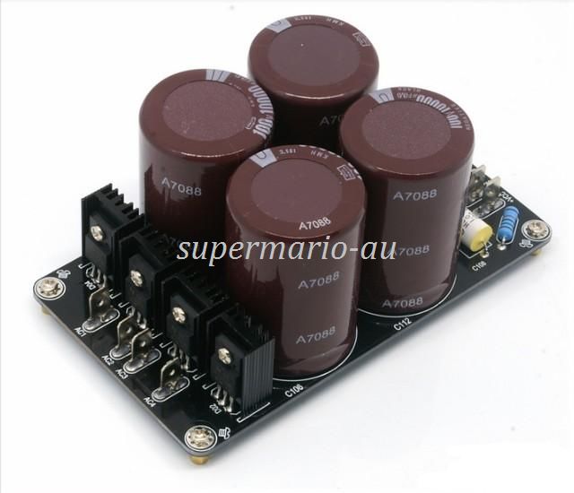

    Now i before i update with pictures and details i have a question. Please sb. help cause my ignorance here is astonishing! I thought all was simple and obvious, but...

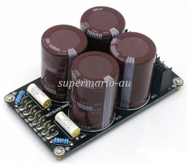

    I have a toroidal transformer 2x50VAC and Power Regulator Board PSU. So one side of the board says AC1 AC2 AC3 AC4. Here i connect AC1, AC2 to the 50VAC1 and AC3,AC4 to the 50VAC 2.
    At the other side it says VDC+ VDC+ Ground Ground Ground VDC- VDC-, so as i need 70VDC i connected Both VDC+ together for the + and both VDC- together for the -, but now i gave 140VDC measured between + and -. What i am missing??? i remember the time at school when + was + and -was-, something changed these years or what?

    PS: PSU problem resolved, Neale helped me here http://www.mycncuk.com/threads/7659-...9481#post59481

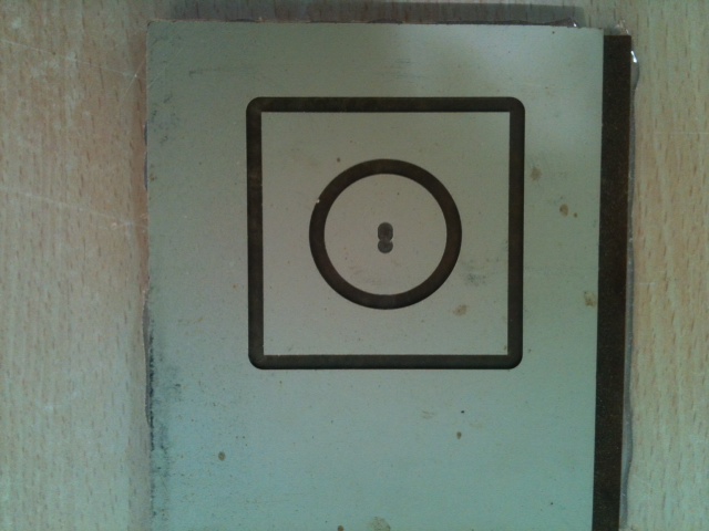

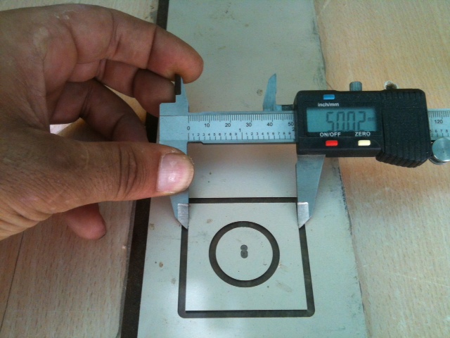

    I am still not convinced how i have to wire the proximity switches. I mean as Limits or Limit + Home. The cables i use is 8 pin. I am still not convinced at that squaring the gantry thing.
    Lets see- the machine is perfectly square. And when i say perfectly look at this - moving one of the long ball screws that move the gantry, the gantry moves with ease and the other ball screw rotates by itself :-), all along the distance i mean. I tried moving them in opposite directions but there is no play so actually i can not make it not square, at least by hand i mean.
    For the moment i will go as so far that connect the gantry switches only from the left side and make all limits. It will save me some thinking how to pass the cable from the right side. Will do some tests and see if its worth connecting them Limits and Home. For the purpose will make a small connection box at the back of the Z. cause the design is so, that all cables meet there.

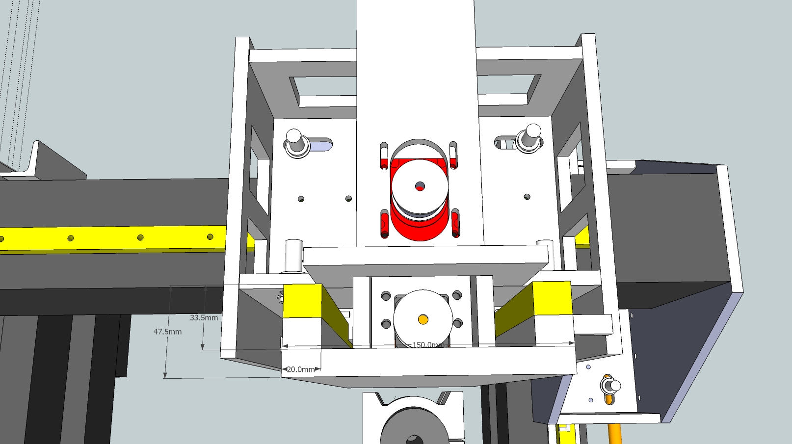

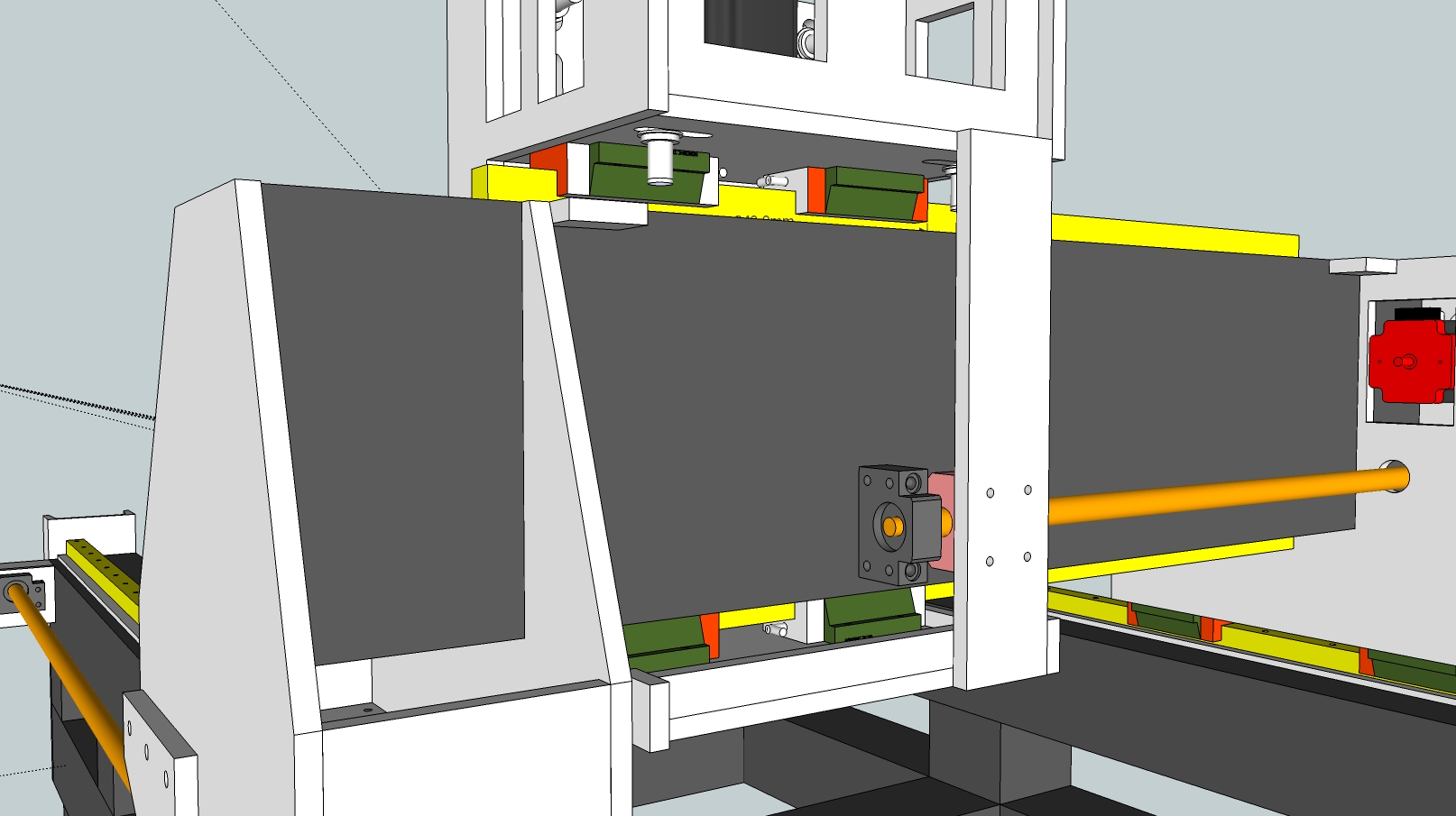

    1. How did your succeed to have Z axis rails in the same plane? Did you use epoxy, or did you mill the 6mm plates?
    The Z axis rails are in the same plane for 2 reasons:
    1. When i mounted the bearing blocks first, i checked the plate with straight edge. luckily it was almost straight. Some hits with big rubber mallet made it perfect.
    2. Now having achieved to mount them on a plane surface, using precision square i squared 1 raw of them and tightened them. The rails were in the bearing blocks but not attached to anything else. cause when you measure long things, its easier to detect any error.Then using digital caliper i measured 150mm, tightened the bolt on the caliper and from both sides made sure the distance is the same . Tightened a bit, then with the digital caliper made sure its parallel to 0.01mm. Little bumps with small plastic hammer helped. Then tightened it finally.

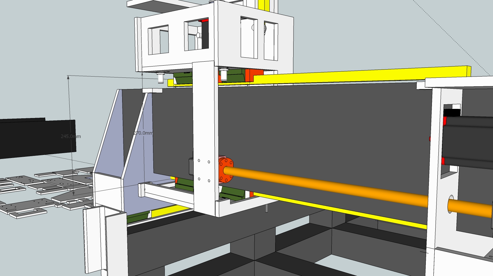

    4. What is the clearance from the lower part of z axis to the cutting surface. Also what is the real traver for your z axis.
    260mm and real travel of 215mm
    Now, careful cause this is still unconfirmed info and just a point of view. Its just what months of mind games told me. As i said it many times in the forum, cause that's my view for a DIY really multitask machine, i seem to find that the Z to bed/ frame without anything else/ 250-260mm is perfect. With the trade off that when alu sheet is routed it had to be risen another 100mm at least, using MDF, wooden or so, ribbed or solid, removable bed or fixture.

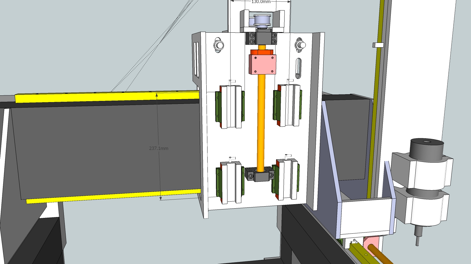

    Below is how my z plate ended. As you see the solid bars combined with the rails reinforce the plate and is very doubtful it will bend, think of bending a solid steel bar ~50mm thick and at least 50mm wide, 500mm long. Another pint here is that i use 2 spindle mounts separated at spindle both ends. So the mounts and the spindle further reinforce the thing. No it will not bend in any way.

    Quote Originally Posted by ba99297 View Post
    5. Finally what is the horizontal distance ( from left to right ) for y,z axis carriages and the vertical distance ( from bottom to top) for y and z axis carriages ( outer side of carriages)?
    Thanks for you time
    Vagelis
    What i believe is the absolute minimum for a good strong machine- 240mm for the Z Spacing left right
Name:	cnc 100x100x3 profile x400y1000z200 z axis carriage distance.jpg
    The vertical is my minimum for such a long Z plate. The width of 150mm is the minial as i see it , again having in mind the length
Name:	cnc 100x100x3 profile x400y1000z200 Z distances.jpg
ID:	12686 Click image for larger version.
Name:	cnc 100x100x3 profile x400y1000z200 Z distances 2.jpg
