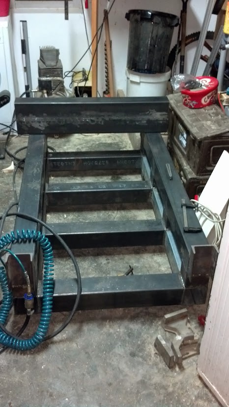

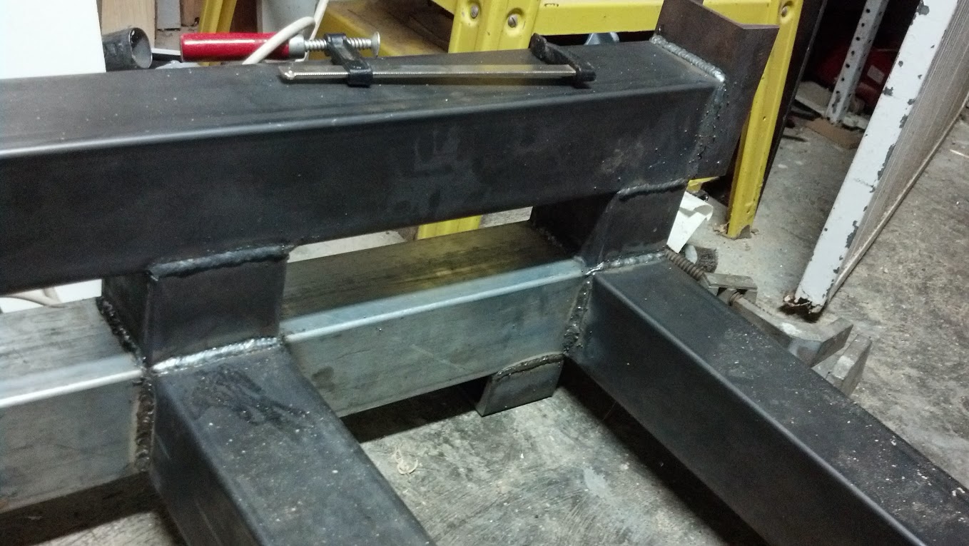

    The frame looks good.
    The welds look fine considering you've not ground the mill scale of before hand. Although MIG welding will burn through the scale, it can lead to weld contamination as standard MIG welding can only burn of a limited amount of contamination.
    Thanks for the heads up. next time will not only grind 1mm the corners but as you say.
    Here are 2 recent pictures. Just soldered the hardstops for the gantry from 100 UPN profile. My friend insisted on soldering 4 short legs, again from UPN100 profile. Strengthwise i would have soldered 6 legs instead of 4, or none at all and lay the machine and thin layer cement the machine on place but i was very curious of the deflection of my design.
    Now just measured it so here is the result:
    1. Applying 100kg static force/me/ on any one of the bead beams leads to 0.045 mm deflection in the middle
    2. Applying the same 100kg to middle of the raised sides supported only at both sides by 9 cm legs from 100UPN profile leads to 0.03mm deflection on that side.
    Conclusion: With gantry and bead mounted in real working conditions the overall vertical deflection of the machine will be unmeasurable or less than 0.01mm which is irrelevant especially with 0.8kw spindle. So first impressions are perfect.
    Anyways, i will most possibly insert pads in the middle of the machine when placing it on its place, so it will stay rigid and quiet
    PS. In fact using the excel file for calculating deflection on gantry and gantry side, i guess the real final value of deflection in all directions of this particular design of the finished machine will be 0.0035mm. Which i believe is great.

    it looks really warm there... ive just returned from holiday in turkey, to miserable cold england. :(
    top work... keep the photos coming...
    Your test shows that the deflection due to the frame will be very small (<0.01mm), but remember the linear guides and Z-axis especially will all lower the stiffness, so overall your deflection will be greater. Still, your gantry design looks reasonably strong so I expect it will be fine.
    Thanks. I am aware of that. For me this build is a preliminary build to my real machine. A kind of experiment. Something like how far i could go at every step.
    As the machine we all know is a sum of its components.I constantly meditate on "the machine is strong as its weakest part". The Hiwin blocks are with A preload, the deflection calculator tells me the gantry sides deflection cutting aluminum will be lower than 0.01mm, so i guess the weakest part will be the Chinese spindle bearings and the bit. I will be extremely happy if i succeed in making a precise machine, just for the sake of it.
