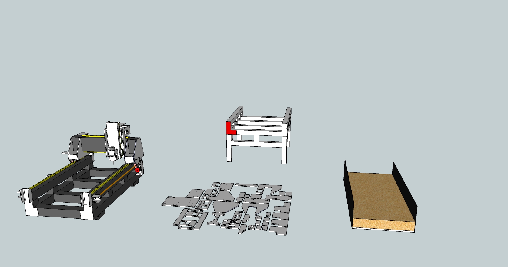

  3. #53
    Hi guys,
    thanks to all for the valuable inputs.
    For now i have to wait until they cut with laser the pieces, so i can proceed further.
    Meanwhile as a thanks to all for the help , here is the Sketchup file/its in winrar format for easier transfer/. So anyone who wants can use it as it is, use parts of it or just use the components or table drawings. Before ordering the laser cut parts i revised it piece by piece and against the ballscrews, housings, etc. So all small errors are fixed. It cost me a whole day to rework it precisely. The empty spaces are for epoxy, there are some clearances where necessary. The machine has work area of 400x1000x200 . Any questions are welcome if you have something that is not clear. The main point being here is that the machine is completely scaleable up to the limit of the ballscrews or with minor adjustments even up to 4x8 , this without changing the type or thickness of the profile. Other main point is that the drawing is final drawing, no need for correction before real assembly, however there are some steps to be followed, but easy to figure when playing and simulating the actual assembly. If by channce there is a small error i will fix it right away in the future.
Name:	cnc 100x100x3 profile x400y1000z200.jpg
    So enjoy it and thanks again. Will update when i have more to show.

    Hi Silyavski,
    Thank you very much for putting your sketchup files up for everyone. I am in the process of designing a new machine and learning sketchup so your files will be a big help! :)
    What sort of rough price does the laser cutting cost?
    Looking forward to seeing your machine come to life!

    I dont understand something
    The cncrouter will have legs down to ground or the cnc on the left of your scetchup will be put on the white table
  7. #56
    Hi there,
    The table on the right is if sb wants to upscale it to 1000x1500 or similar,with small adjustments, using the gantry from the left. On the left is the complete machine 400x1000 which i am building now.
    Furthermore have in mind the gantry can be simplified removing the raise sides if intended mainly for aluminum.

    Quote Originally Posted by cncJim View Post
    I ordered them in my country/ Bulgaria/ and they cost there 250 euro. + 50 for a guy to bring them when he is coming back from there in 2 weeks.
    Here in Spain, the price would have been outrageous.
    Anyways, its a lot of metal. I don't have the means here, that's why i preferred laser cut. But in fact if you can cut and drill and have spare time, they are quite simple to produce at home.
    Now i am designing my next build and definitely will try to lower the number of parts.
