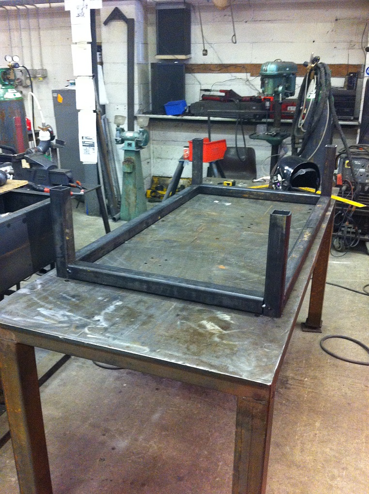

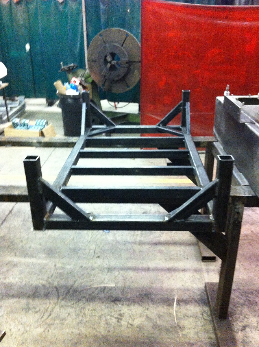

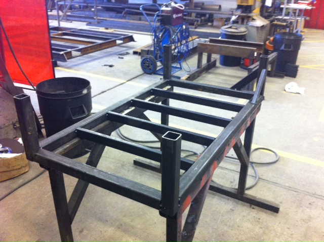

    I'm no expert (I seem to weld every 4 years or so) but what I did was cut the pieces to length, dry assemble the uprights and the main frame outer pieces then put either one tack or a couple of tacks on each piece.
    Then I got a square and spirit level and made sure all was as good as I could get. I then tacked in the bed braces..

    I then checked all was square again before starting to add the angle braces...

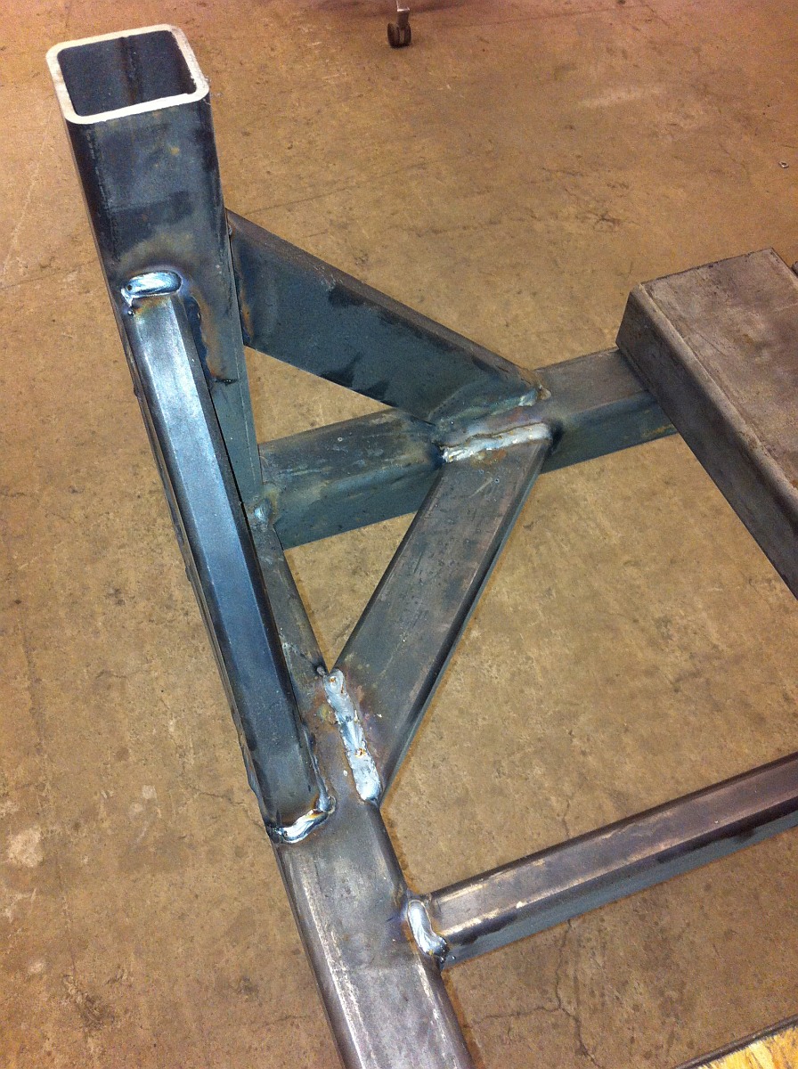

    I then checked that the uprights were still square and all was good and then started welding the uprights. Now here I confess I didn't do it in small short runs spread out round the frame like I probably should have. I just did it in one or two runs per weld (50mm long welds as using 50x50x4 box)
    I then checked to see if all was still square (otherwise the angle grinder would have to come out!) and then proceeded to weld up the rest of the welds. I didn't do it in any particular order (it was pretty random) and then after finishing the frame (but without the X axis rails welded on) I checked all the frame was still level and the uprights were still 90° to the bed.

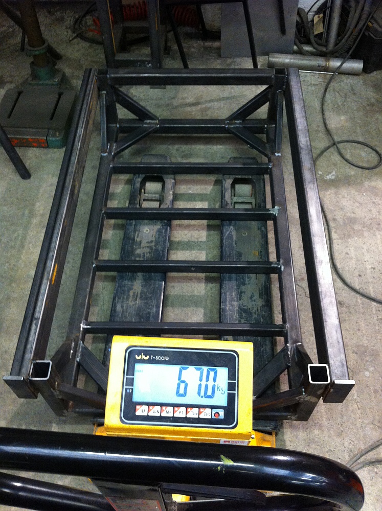

    I then did the same for the second rail checking for parallellness (is that a word?) in both directions with the first rail as a reference but also checking the second rail against the frame to make sure it wasn't out. I then did the same weld procedure for the second rail and it turned out pretty square and parallel....probably more from good luck than skill!

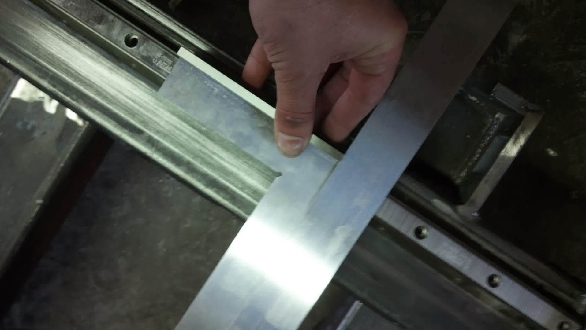

    Buying the precise 1m straight edge and precise square was a very good idea. In a matter of minutes i placed and aligned the rails. I would say that its crucial .
    Both cost around 100 euro and a week research , see here: http://www.mycncuk.com/forums/tool-t...-straight.html

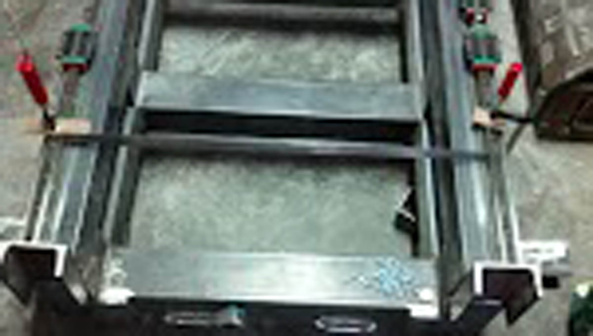

Name:	epoxy hiwin 3.jpg
    Once in place and squared i rechecked them using a long steel ruler made from 2 rules and magnets, which i fitted inbetween and checked at both ends. Tight fit as expected. I supported it with alu beam so it would not bend/ like in the picture, while i was making the shot/

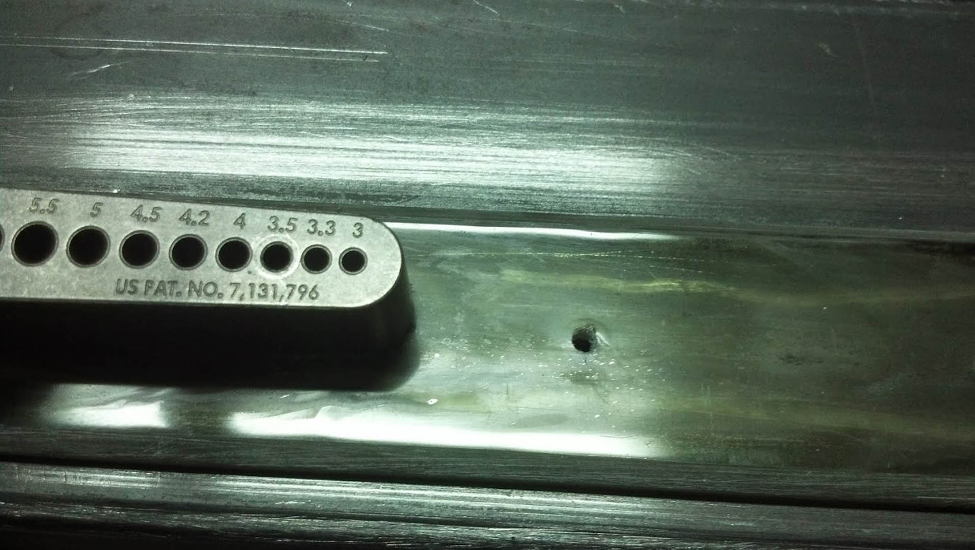

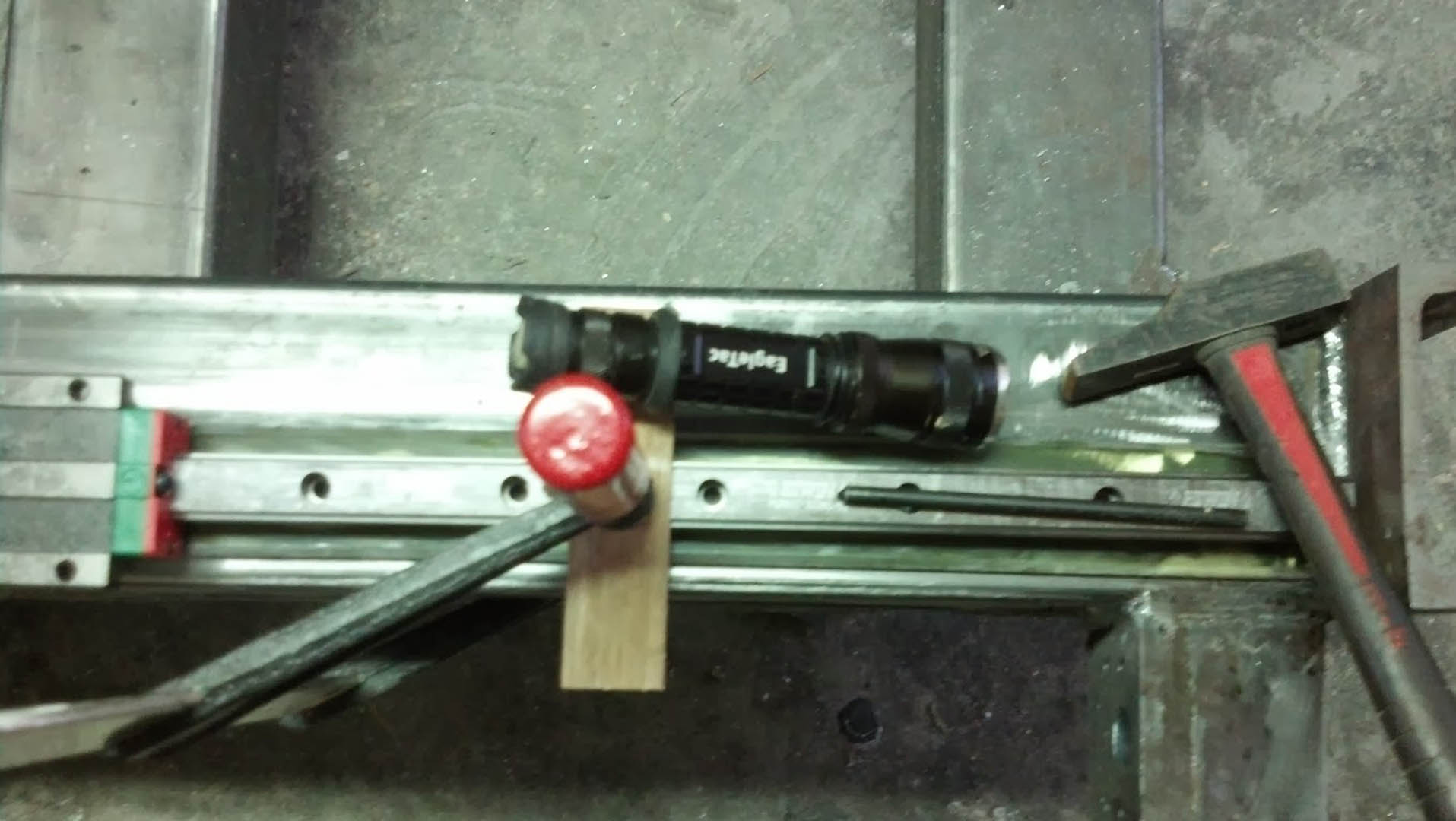

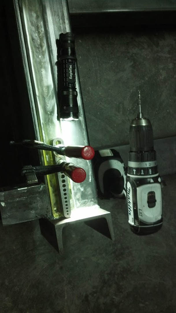

    I was tired and working after work. But i wanted and started to feel a kind of satisfaction not being in a hurry and doing things right. So instead of drilling through the clamped hiwin rails, i used a hole transfer tool lightly using the hammer. And a torch, to see better.
Name:	epoxy hiwin 5.jpg
    And as i started to feel that satisfaction, i decided to continue accordingly the process, drilling first 3mm holes, using the very handy tool to keep them vertical.
    The torch helped again to see things , illuminating the epoxy from below.
Name:	epoxy hiwin 8.jpg
    Some holes and here is what happened. I had to go for a new drill, as it seems if the drill is not perfect, it adds heat and the epoxy lifts around the hole. Not a big deal, will scrape it with a small straight edge. The epoxy scrapes nicely, as i said-like snow flakes
