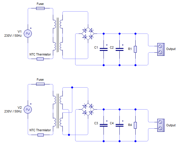

    That cap you have linked to looks like 63V rating to me used with the transformer that you linked to would that not be a bit low? ... Clive
  2. #22
    Sorry, I accidentally linked to the wrong transformer. This is the correct one:
    Toroidal Transformer 500va 0 35v 0 35v
    It's 35V, so 35*2^0.5-1.1=48.4V approximately, which is fine.
  3. #23
    The mains things are;
    Capacitors:
    SNAPIN:4700UF/63V Panasonic (ECES1JU472N) 25.5 X 50 | eBay
    Transformer (other places have them too):
    Toroidal Transformer 500va 0 50v 0 50v
    Rectifier (excessive rating, but means you don't need a heatsink so it's easy):
    KBPC5006 Bridge Rectifier 50A 600V
    Plus you'll probably want a fuse holder and a switch...
    Why post this and only give some of the information required.!!. . . This is exactly why I won't do this on a thread it's dangerous and you of all people should know better.!!
    You linked to Caps but didn't say how much capacitance is required or even mentioned the fact more than one cap can be wired in parallel to reach desired capacitance.
    You haven't mentioned resistor for draining the caps.
    Your lack of full information is dangerous and your playing with other peoples lives and expensive hardware.. . Give it all or shut up.!!

  8. Guys, lets not start WW3, ok.
    You both have valid points and all the info is out there including the thread I linked to. BUT none of this in the right form for a newbie to electronics at this level. What we need is a properly structured tutorial to help answer the question 'how do I build a linear PSU for x volts' with a 'best practice' design, a schematic and assembly guidelines along with photos of good - and, maybe, bad - examples.
    I'm willing to have a stab at the words and there's a good working schematic that I drew in the thread I linked to.
    What say you?
  9. #29
    Your the MOD and resident electrical genius so Get on with it then.!!
    I think the point we're making here is that you don't need to be an electrical genius to do this, you just need clear instructions. Therefore we need someone who can explain things clearly, but you have made it apparent that that's not me, so I'll just contribute with this circuit diagram:
    Two versions depending on whether the transformer secondaries need to be placed in series or parallel to obtain the correct voltage. Two capacitors pictured, but more/less may be needed in some cases. I put in the NTC thermistor for soft start, which is optional for most size transformers in this application. I see no reason to put a fuse on the output since all the drivers I've dismantled (PM752, PM542, DQ860MA, AM882, 2M880N) include their own individual fuses, however it may be sensible to include one in case somebody decides to use the power supply in a different application.
