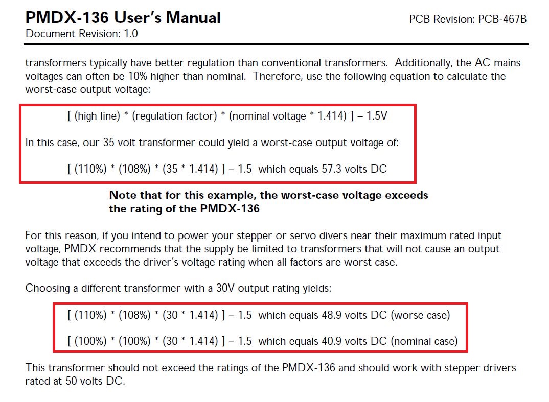

    Hi all,
    All this week I was looking for information related to DIY PSU,
    and found this assembled power board : PMDX.COM - Products for CNC and motion control applications
    AC input 18-35 volts
    DC output 24-50 volts and up to 10 amps
    It seems that this is what I need for my Gecko drivers,
    but one thing I can't understand, see pics from manual.
    If I good understand, so I have to choose 30V/AC transformer if I want to stay on safe side, but at the same time lose some power?, or I'm ok with 35V/AC ?

    Gytis,
    If your unsure then has a guide just check the voltage coming into building, if it's on the high side then go for the lower transformer to be on safe side.
    There actually 33Vac transformers which will suit better see below. 2x33 will give approx 45-46Vdc and 500Va will give approx 7.5A or 625Va 9A

    Gytis,
    Measuring it at a random time is pretty meaningless - at any one point on the grid the mains voltage can and does vary by several volts over time. I'd advise getting a transformer based on the standard mains voltage tolerance (i.e. 230+10%=253V in the UK), otherwise the power supply can't be described as stable and safe for the drivers.
    So with a 230V to 33V transformer, using the 10% tolerance and 1.1V drop for rectifier, you can expect up to 33*1.1*1.414-1.1=50.2V. Granted that's not likely to occur at all often, but it is over the rated voltage of the drivers so using the 30V transformer is would be less of a risk. If using a 35V transformer (i.e. the spare one I had) then I'd add in some extra diodes or a linear regulator circuit to keep the voltage within the specification.
    Yes I agree Erring on safe side is best but it will give him a clue to what the supply is doing which he doesn't have NOW. Esp if he checks over a time period.!
    I think the 33vac will be fine because the G540 Gecko can handle more than 50Vdc for short bursts and it's very unlikely you'll ever get near that voltage.
