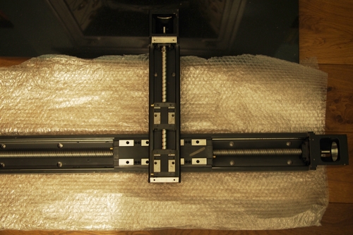

    I've been reading this forum for a while now. Lots of knowledge people here. I was wondering if any of you had used or had any views on the KR actuators from THK?
    I can get a used THK KR55 with 680 travel (2 blocks) or 800 (if I remove 1 blocks) for a fair price. I was thinking of using it for the X axis, on a machine that will occasional use pretty large router bits, primarily on hardwood. The lead is 20, so it's going to need some torque to shift it I guess.
    My main reservation is not knowing how to compare the permissible loads on one KR block vs two rails and four blocks (well spaced).

    I can't see a problem but would need 2 blocks.
    Regards the lead then depends on the work your doing and the micro stepping your using on the drives.
    For Mainly wood use then 20mm lead will be ok and with average 800 micro-steps then you'll have theoretical resolution of approx 0.02mm which is plenty for wood.!! . . . . You'll also have massive OTT speed for cutting so you may want to think about gearing it 2:1 and increase torque and resolution.?
    Thanks for your reply. The blocks are each 128mm wide (including the wipers etc), which is why I thought I might be able to get away with one block.
    You Could try it but I wouldn't 128mm just isn't enough IME..!!

    I did have a quick read over at CNC zone about the KRs. I can see that people using the smaller models, single block, and large routers might have an issue with them as Zs. I've picked up a KR46, with two blocks and it's the same width as the spindle I'll use, so I'm sure it will be fine. It does look a bit tall, being so thin.
    The KR55 is a monster, beautifully constructed.
