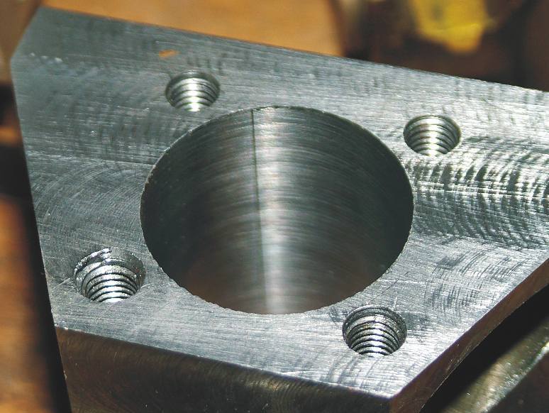

    Not easy when your centre drill loses it's tip and you don't want to lose position :confused:
    Bottom left hole in the piccy, looks a bit chewed but hey, it's there.
    I attacked the remains of the drill tip with an ordinary masonary bit and smashed it to dust, then an undersized drill to make sure it was all out.
    By now the hole was clear but way off centre. I switched the drill bit to a 5mm milling cutter and put it back on centre before drilling it through and threading it M6.
    Amazed I got away with it

    First off nice recovery but unless you are putting a centre hole in a shaft for running in the lathe forget centre drills.
    I know most books and tomes of learning tell you to centre drill first but all these were written years ago before CNC. Industry hardy ever uses centre drills now, they use spotting drills very short fluted and stiff drills with a different angle on them and it's well worth buying a couple of the smaller sizes to replace centre drills.
    If you do need to centre drill then it also pays to regrind the drill and loose half the pilot length, they are far too long to do what they need to achieve.
    years ago it was to form a reservoir for the white lead that lubricated the dead centre. Nowadays most people use a revolting centre and this doesn't apply. All the pilot has to do is stop the point touching the end and this can also be achieved by having a small flat on the very nose of the revolving centre, this also protects the centre to a degree as if it doesn't have a sharp point it can't get damaged.
    Now someone will say grinding the pilot down will loose half it's life, but snapping it will loose all it's life, make the choice.

  6. here's a bit of advice
    john S Advice is spot on (forgive the pun) centre drills old hat
    when you have broken the end of your c/drill into the the job this then becomes embeded
    into the material ,so if you try to remove it the tool will push off toolsteel on toolsteel
    hence the banana
    so heres what to do get a carbide tool (stronger then toolsteel) low revs and just feed in
    slowly until embed toolsteel is removed then you can drill it after
    hope this helps

    I have tried that in the past with varying degrees of success. If the broken end starts to turn it usually prepared to drop out. If it flips and suddenly becames a lot taller, being edgeways on, it is goodbye carbide cutter. That's why I favour attacking them with a cheap masonary bit if I can't be fagged to set up and spark it out

    I have a set of carbide centre drills for slowly peckdrilling out a broken hss c/drill.
    Also i have found that going a few sizes up on the c/drill and just using the point to spot the position helps centre the drill
