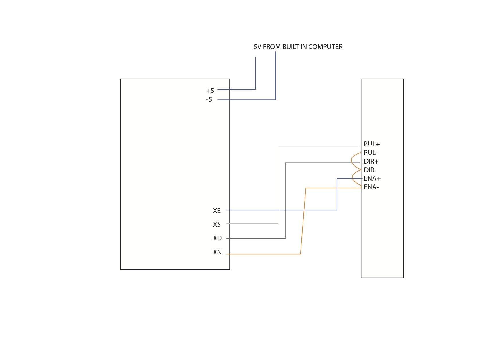

    Title covers it all really, I have been testing my AM882 / ZPA5 setup and I have a peculiar problem that I have narrowed down but not resolved.
    I can control the motor with the Pro tune software and the motor moves smoothly. However, once the settings have been written to the driver and I try to run them from the ZPA board the motor jumps, jerks and stutters. It moves, in the correct direction but just like there is interference messing up the signal.
    So I have put some ferrite beads on the wires, tested it in the case and out of the case even tried another ZPA5 board from my other machine and it still behaves erratically when the BOB is in control.

    Might sound bit obvious but you've not just tuned motor wrong in the control software are you.?
    Like Gary says without seeing wiring or what exactly it's doing it's hard to say anymore.
    Motor tuning is ok as I am moving the stepper perfectly with the Pro-tune software. It is only when the control board takes over does it go wrong.

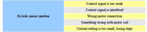

    It says in the manual that erratic movement can be caused by weak signal or interference. How can I check for this?

    You'll need an oscilloscope to do it properly but chances are you have just got something wrong with wires or settings.
    Your not trying to run this with a Laptop are you.?
    Where did you get the PP cable.? . . It must be a straight thru cable not an old printer or serial cable.
    Regards the motor tuning then that's nothing to do with Drive settings it's the control software sending out pulse's and if you motor tuning is set to high you could be getting stalling motors.?
    This will most likely turn out to be something simple like dodgy wire or wrong settings. Would be very unlikely you'll have electrical noise issues. The drives clearly work fine has do motors so they are ok and wired correct.
    It could be PC related like low voltage parallel port, unfortunately don't know anything about your BOB so unsure if it pulls signals high or not.?
    Sorry can't be more help than this.!!
    EDIT: Oh if your using Mach3 then try the PP driver test to check your PP port.
    If still having trouble and can't see any thing else wrong with wires, drives etc then sometimes a reinstall can help. It's not unknown for Mach's XML file to get corrupted and cause daft issues like this.!!
