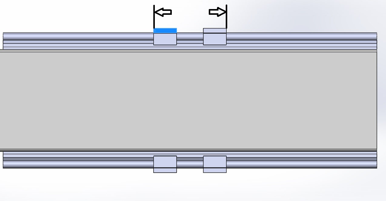

    What far more important is the bearing spacing on the Y axis and the more(within reason) you have the better it will be, obviously this comes at the cost of cutting width so it's a balancing act and personally I won't go any less than 200mm with 300mm being better.
    Dean - could you confirm this for me.
    If Y supported rails are mounted to the top/bottom of the gantry - do you mean the height of the gantry itself ie, the distance between the rail mounting surfaces?
    I think my design is at 175mm currently so may need to extend it.

  4. #24
    Quote Originally Posted by CraftyGeek View Post
    Yep no problem but I like pretty pictures to save my fingers typing so that should show better what mean when say spacing between bearings.

  5. #25
    I think Dean means the spacing of the Y rail mounting bearing mounting blocks horizontal should be spaced wider ..Clive
  6. #26
    Yep I think he does has well. .
