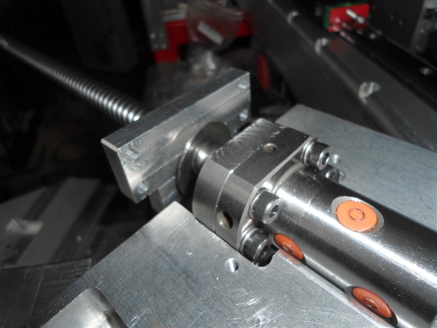

    Obtaining zero backlash
    To achieve 'zero backlash' two identical ballnuts were preloaded against each other other - nothing new here, it's just not normally seen on CNC routers. This will eliminate backlash up until the point when the axial force applied to the nut exceeds the preload force, above which the system will exhibit backlash. This is not a significant limitation since the preload force was selected to be sufficiently greater than the force each axis would experience, be that due to cutting force or acceleration.
    The Z-axis is easy since gravity pre-loads it, due to the large mass of the Z-axis, so there was no need incorporate a second nut here. Although the cutting force parallel to Z could exceed the weight of the axis whilst drilling, a <0.05mm error introduced due to backlash is insignificant here. For the X and Y axes two ballnuts were used on each screw, with one attached as normal and the other preloaded against the screw using disk springs. This nut is constrained rotationally via pins, since any rotation would introduce backlash. Easiest to explain with a picture, so here's the finished mechanism on one side of X, which is identical to the other side:

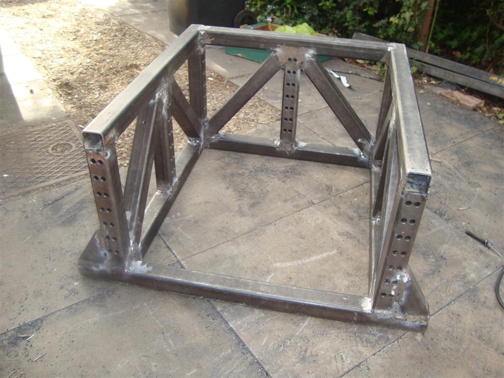

    The frame:
    The high stiffness requirement dictated making a substantial frame, however it could not be too heavy for portability reasons. After a suitable mixture of calculation and guesswork we opted for 60x60x5mm box section and a largely generic frame was designed with the obvious diagonals added for additional strength:

    We did not want to sacrifice strength of the frame just to make it easier to mount the X-rails accurately, so we decided to fully weld the frame and compensate for any discrepancies in the rail mounting surfaces later on. M12 tapped holes have been added in various places so that the frame can be filled with sand or some other material to aid damping. This will be done some time in the future if deemed necessary - for now the frame is empty. The following images show the process:

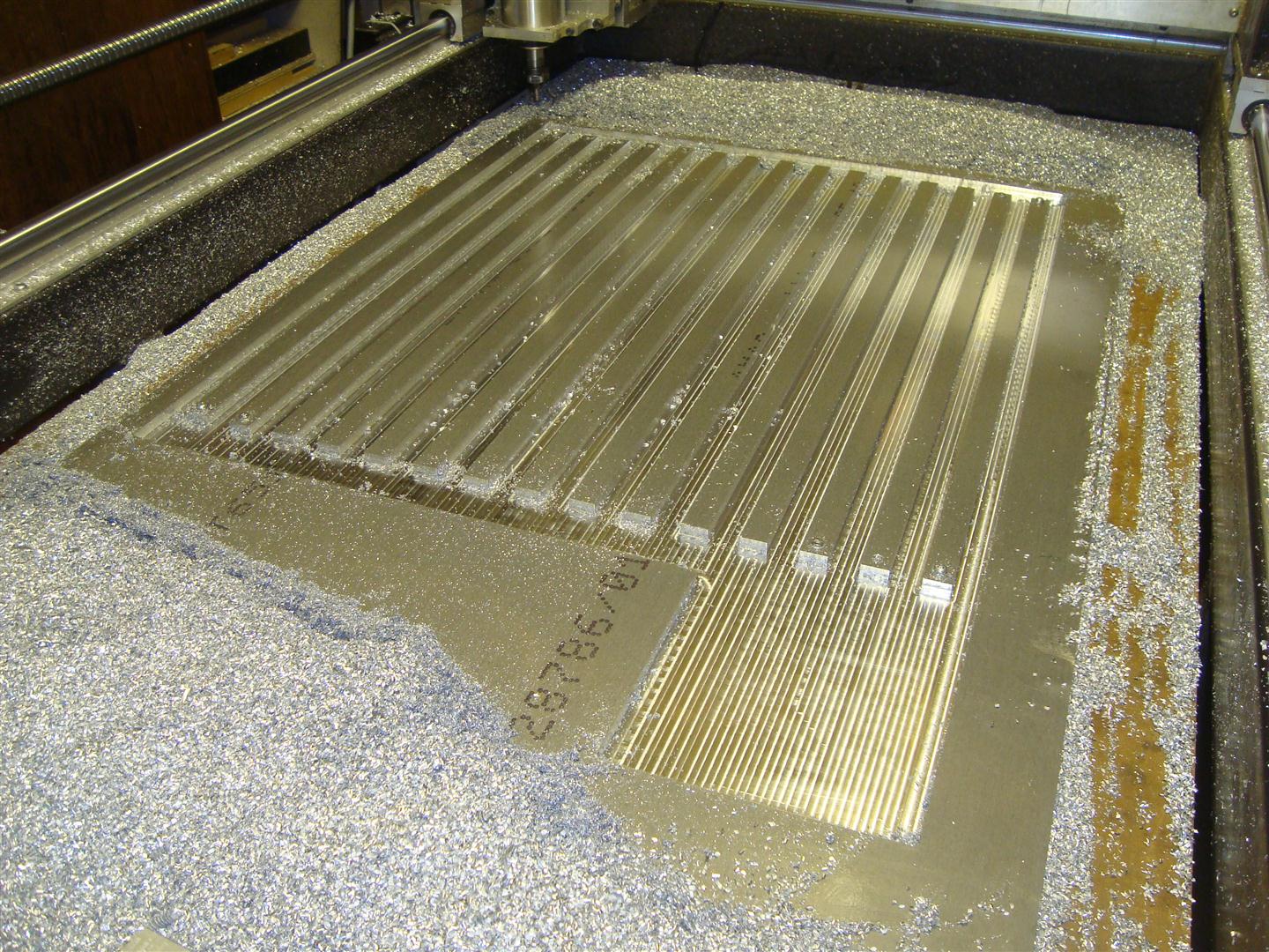

    The bed:
Name:	DSC09649 (Large).JPG

    At the expense of tapping a large array of holes (15x15, about 4 hours with a cordless drill), a clamping system with the following features was selected:
    • Resurfacing or otherwise machining into the bed isn't a permament mark on the bed – the strips can relatively cheaply be replaced.
    • Clamping via T-slots and nuts.
    • Countersunk screws can be removed to bolt directly to the bed using the existing grid.
    • Remove required screws and clamp from the bottom of the bed through the tapped holes using a smaller bolt size – awkward but nice to have for that one time that it's crucial to have an uninterrupted machining surface with virtually no possibility of collision with clamping fixtures.

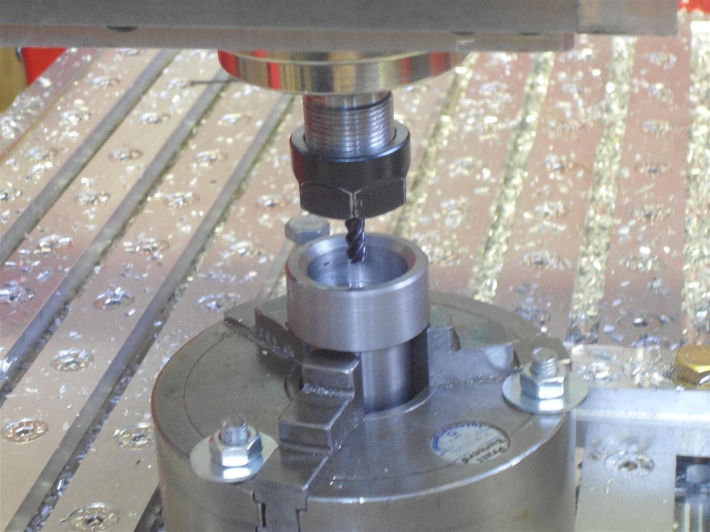

Name:	DSC09922 (Large).JPG

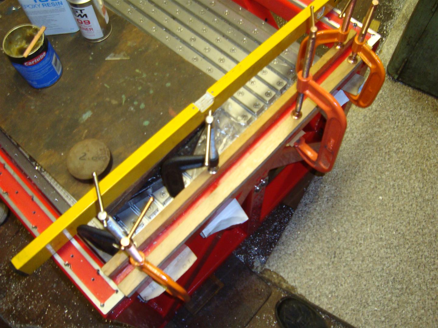

    Consequently, we opted for epoxy levelling. Another option would have been to measure the angular and height error, which could be done by taking readings with the indicator on two different length bars, and simple trigonometry, and use this to mill 3D surface to compensate.
    The epoxy chosen was west system 105 with 209 hardener, since this is the lowest viscosity we could find and the long curing time gives it more time to set level. Two aluminium barrier pieces were cut and a temporary barrier was made across the back for resin to flow between each side, so that both surfaces end up at the same height - i.e. in the same plane. This was the setup:
Name:	DSC00034 (Large).JPG

    Pouring the resin:
Name:	DSC00136 (Large).JPG
ID:	9863Click image for larger version.
Name:	DSC00137 (Large).JPG
ID:	9864Click image for larger version.
Name:	DSC00138 (Large).JPG
    Result:
Name:	DSC00041 (Large).JPG

    25mm thick parts:
    Most of these were pretty generic to machine, except for the bed took several hours to cut on my router and to date is the biggest and most expensive part I've cut on it. The finish is quite nice, as the MDF bed on my machine (at that point) helps damp the vibrations and with a big part like this the rigidity of the bed isn't a significant problem. I had trouble drilling the holes round the outside of the bed on the router, so they were just spotted and then drilled on my milling machine. These holes are to accommodate strips as an initial barrier to coolant (bit pointless). Also seen is the excessively massive drain at the front of the bed, again for coolant. This will have a contraption mounted to it to collect swarf and filter the coolant.
Name:	DSC09658 (Large).JPG

    I tried a 6mm 2fl cutter and easily got 6mm depth of cut at 1200mm/min, so I tried a 10mm 2fl cutter. That easily did 5mm DOC, so cutting a slot 10mm wide by 5mm deep again at 1200mm/min. I tried milling with 70% stepover, and it worked fine up to 11mm DOC, however I didn't try more as I didn't want to push things until the machine was finished, especially since this was with no coolant and less than half the fasteners in place. The finish was still good after that cut, so more is clearly possible.
    Due to an error with drilling some holes in the ballnut mounts, I had to make them again, which seemed like a good excuse to try some more cutting with this machine, again with 20mm plate:
Name:	DSC01165 (Large).JPG
