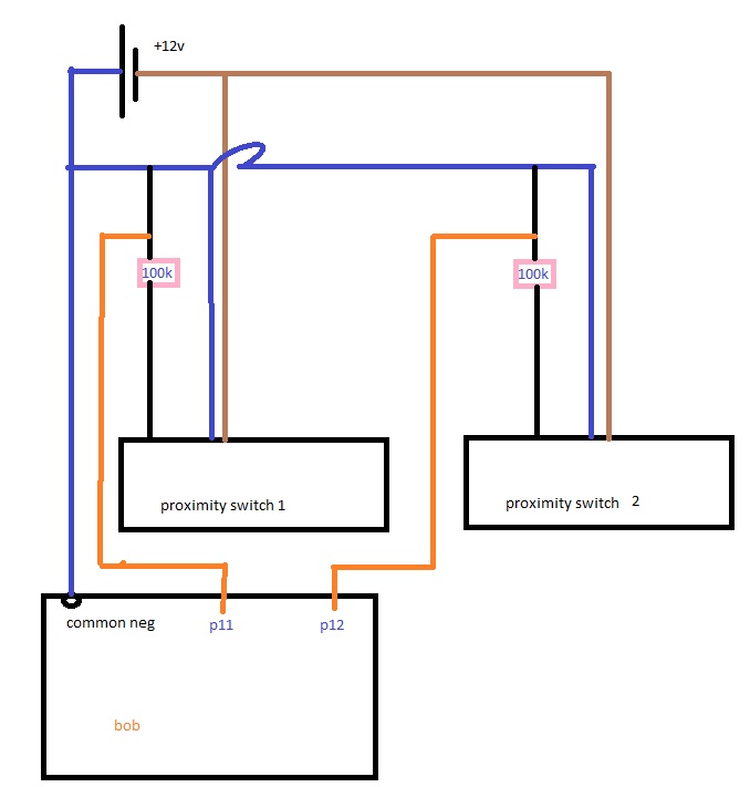

    Ive got the one on Y working, using the below wiring, however as im running two on the X (for autosquare) Im having problems with interference and I wonder if im missing a diode or something to stop feedback from one to the other?
    essentially, if I wire just one... say just to pin 11 its fine, but as soon as I put two in place (ie to pin 12 aswell) I notice false positives on pin 11 if you follow?
    If I do need a diode? or an additional component id be grateful for a recommendation

  2. Your diagram is wrong... the connection to the bob is from the other side of the load resistor, not gnd.
    But I think you are using these incorrectly. If these are NPN the load resistor is from output to + supply, not output to gnd. And the load resistor needs to be smaller than 100k, exact value depending on whther bob inputs are opto-isolated or not.

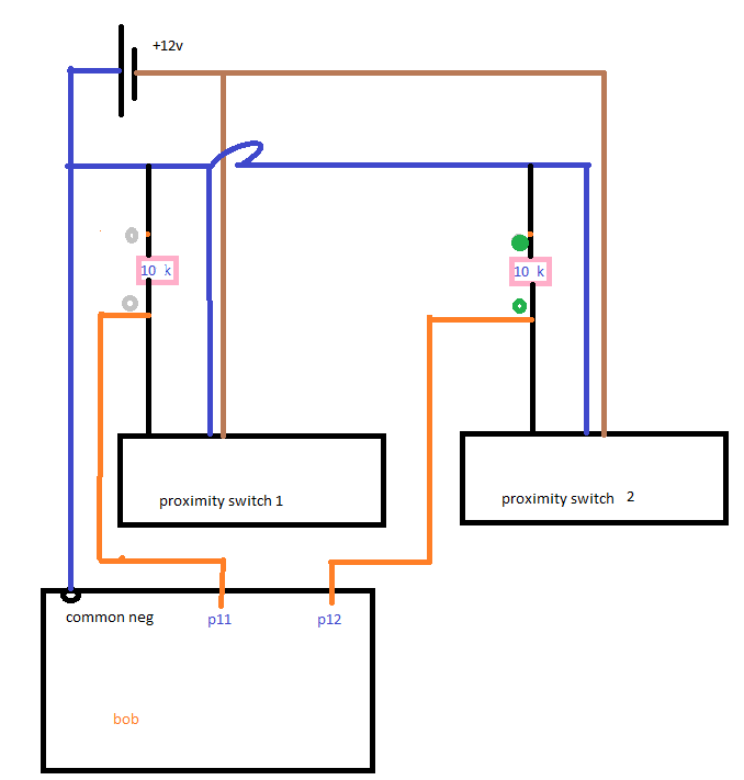

    So what was the problem? Your resistors are 10k, not 100k. I think the sensors you have are not open collector, since they worked without any resistor which implies they have an internal resistor. Putting the 10k resistor from the output signal to ground reduces the output voltage to the 5V required by the breakout board since it forms a potential divider with the other resistor.

    Yes your right, for a start I got the resistor flavour wrong in my diagram... and I was taking signal from wrong place.
    its now like this... and it works
    (incidently) if you measure across the grey spots, or the green spots you get 4.97v high, and 0.01v low

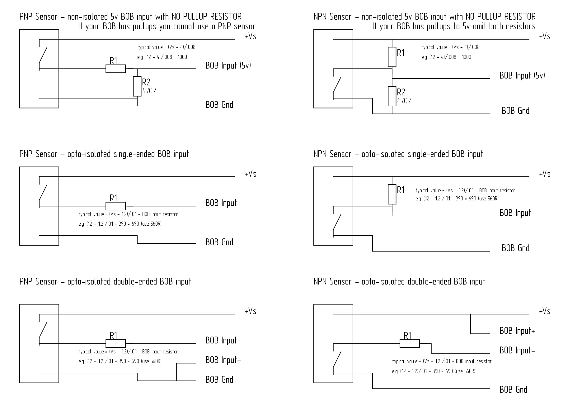

  11. Whats the supply voltage?
    These are open collector NPN sensors so your BOB must have pullup resistors and the external resistors are not needed.
    Diagram attached shows how to use both PNP and NPN open collector proximity sensors.
