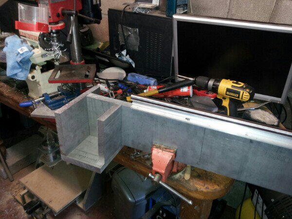

    So it's payday tomorrow so I'll be buying some aluminium in hopes to make this:
    v2 by jessebaker, on Flickr
    the Y rails sit on 6" x 1" alu bar and will have some square section bolted onto it to hold the rails and reinforce the gantry.
    v23 by jessebaker, on Flickr
    the X rails will sit on 3"x2" box section alu or more likely steel.
    as well as having a CNC to help make this, I'm going to be buying a height gauge and a surface plate to help make it accurate. I remeber seeing 20ep0z use one to help me finish my gantry so I think it's a worthwhile investment. though I'll have to get a granite one.

    You might get a granite plate at Tilgear for reasonable money.
    Your design makes for a very rigid gantry and it highlights something I've been thinking about. Say you wanted a height under the gantry of 200mm then with your design you would raise the Y assembly from the bed by about 200mm but then how do you make the 200mm risers stiff ? probably by using a welded steel frame ?
    Edit: I should have checked out more of the build logs first, there's quite a few along the same principle

    after looking at designs that have been posted on here rather recently, I think I'm going to place the supported rail next the ball screw on the X axis.
    this will allow me to align is easier and level it using the epoxy method, it will allow me to keep things very flat very easily.
    I can then bolt that assembly to a steel frame and have it nice and strong.

    Just picked up my alloy and damn it's heavy! :)
