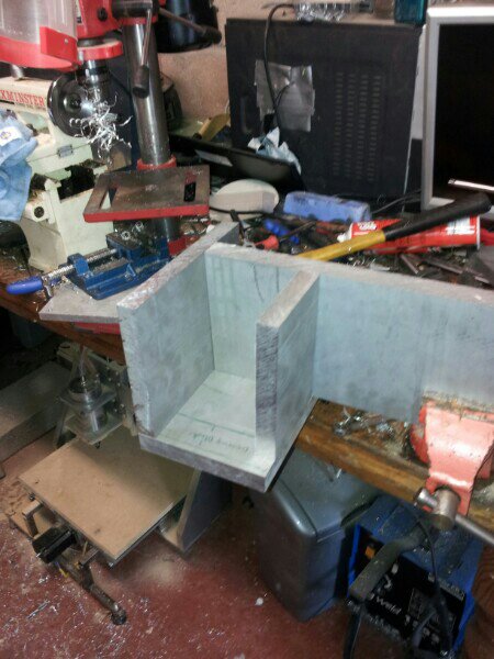

    I've made some slight progress, why do I have to go to work today :(

    Are you just fixing the sawn surfaces together or machining them first? I'd be concerned about fixing sawn edges together...
    no I'm not milling them and I'll probably face the repercussions of it in the way of needing more adjust-ability. I could do it on my current cnc machine, but it'll probably just be more of a pain as I don't know how square the machine is. I just popped it together as the stuff I do on it isn't that accurate.

    with more support block just placed in:
    DSC_0184 by jessebaker, on Flickr
    where the ball screw will sit:
    DSC_0186 by jessebaker, on Flickr
    so far so good. I'm loving the height gauge and I've been making all the holes line up perfectly, no drilling a bigger hole then needed.
    I do have a problem drill into the end of the ganrty plate. at 1100mm long it's a bit tricky to put it in my tiny drill press. and my cordless is a bit kak.
    might have to take it to my old school.
  4. #14
    I've got a few more pictures on my Flickr, it's tricky to grab the url on my phone. I'll update this properly tomorrow.
