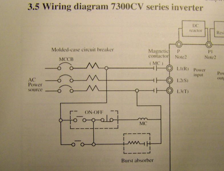

    Teco 7300CV digital inverter, single phase in 3 phase out.
    Circuit diagram image attached...
    L1 = mains live
    L3 = mains neutral
    Question: Why do they use a zero volt isolator to blow the fuse when a simple push button would do?
    I left it out and it seems to work okay :confused:

  2. Why do they use a zero volt isolator to blow the fuse when a simple push button would do?
    I assume by 'Blow the fuse' you mean switch it on/off?
    Zero volt switches are safer they stop machines bursting into life after a power failiure etc.
    No, I mean blow the fuse, or am I misreading the circuit :confused:
  4. I can't see anything obvious that would blow the MCB/Fuse???
    The contactor doesn't short phases. The On/Off buttons activate the contactor with coil the Aux contact (across the On switch) latching the circuit. The burst absorber will be a ~0.1uF in series with 100R.
    No I don't see it :shrug:
    Aha! Penny drops, so that's an aux on switch not the relay, the relay contacts are those hoop things on the inputs. Wondered why it didn't have a dashed line connecting it to the coil :D
    I'm just to used to electronics rather than this industrial stuff, if I draw a box around something then everything for that component is inside the box
    ... and I'm seeing a box that doesn't exist.
    I'll go back to bed
  7. The drawing is a bit inconsistance the Aux switch which is just one of the four contacts on a typical contactor, is drawn as a switch contact (--o_o--), it should look like the contactor contacts (i.e. a bit like a capacitor on an electronic circuit diagram -| |- )
    N.B. a normally closed contact looks like a variable cap i.e. a cap with a line drawn at an angle through it --|/|--)
    Been playing with it and it seems to work fine and dandy, does everything it says on the tin even if what it says on the tin needs a bit of translation
