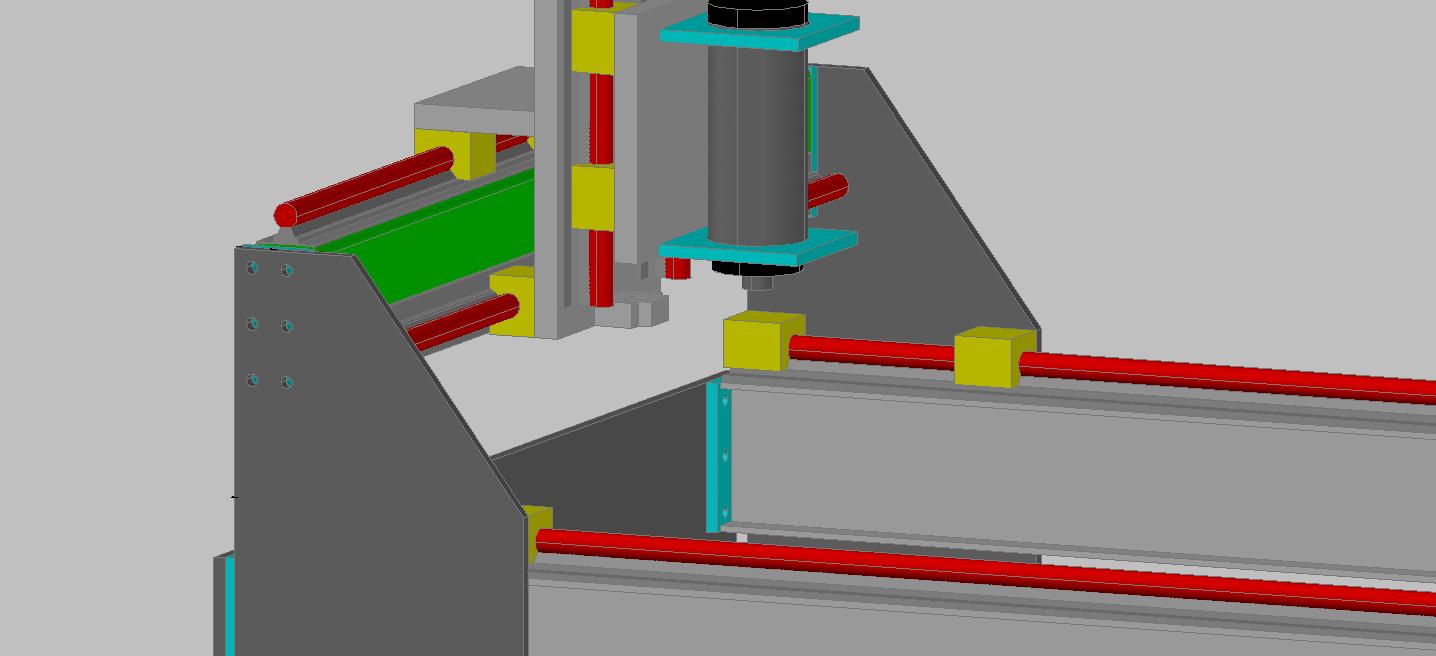

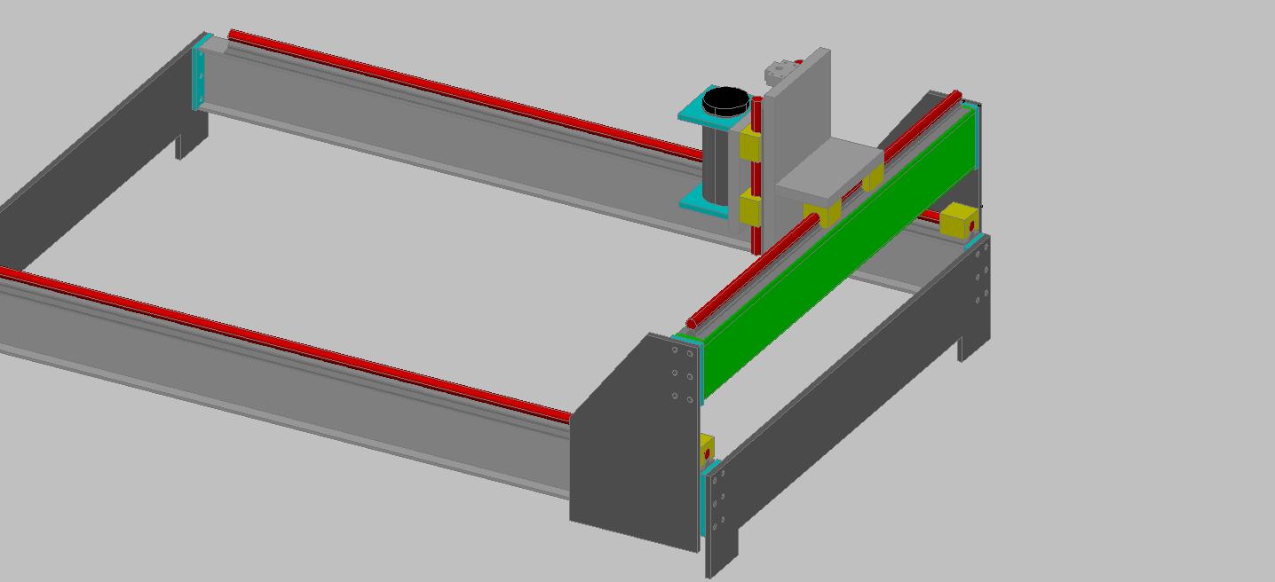

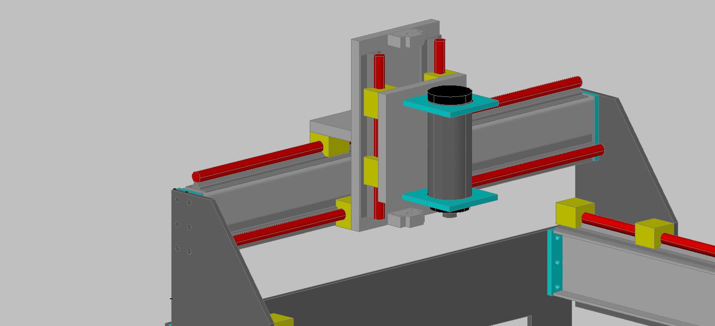

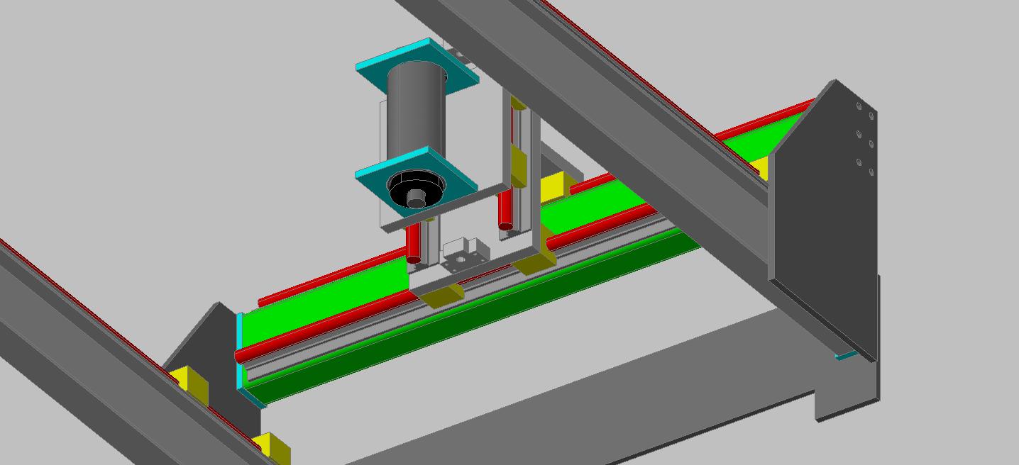

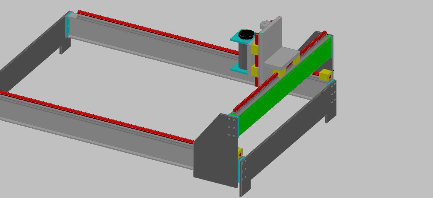

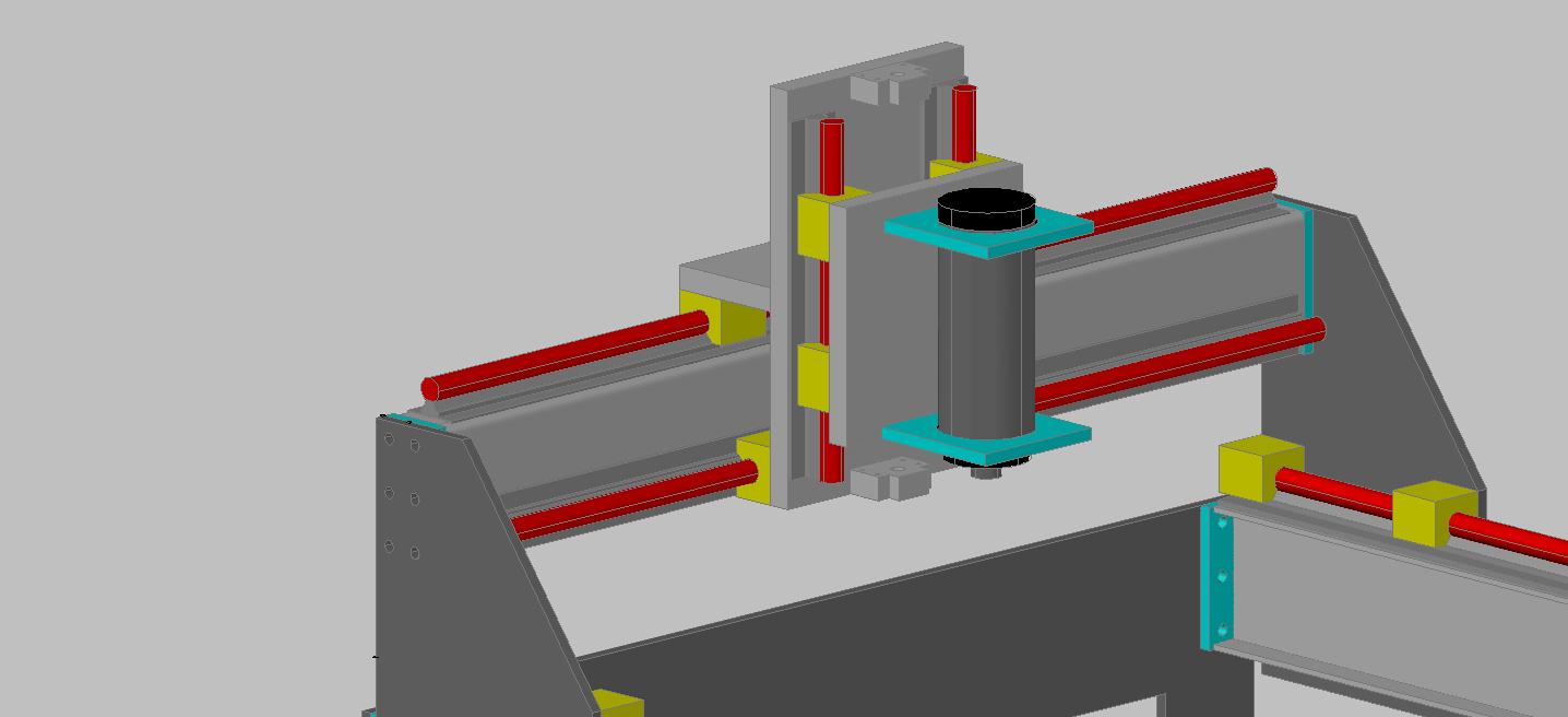

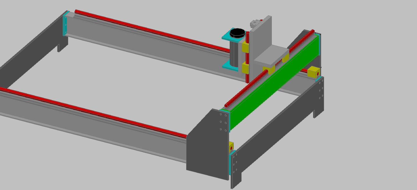

    Last year I am trying to plan and build a cnc router for cutting wood,plastic and ali if possible. The machine dimensions ( of the rails ) are
    X : 1000mm
    H : 1500mm
    Z : 300mm
    As a key element of the frame is steel, with compounds mainly by screws
    I have already bought the motors which are three Yaskawa 400 watt Sigma II with 3000rpm. The servos and a 2,2 Kw spindle ( without the inverter) are th eonly things that I have already bought..
    Thumbnails of drawings I made in the spring are the following

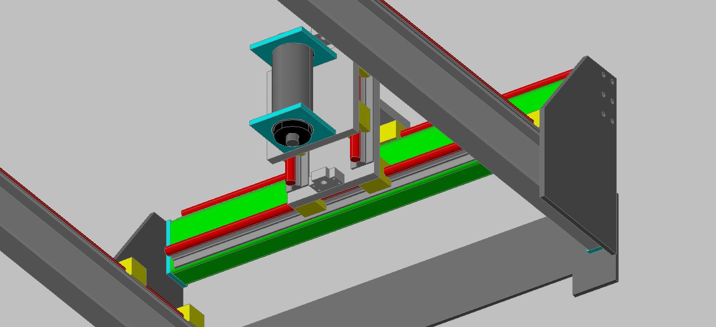

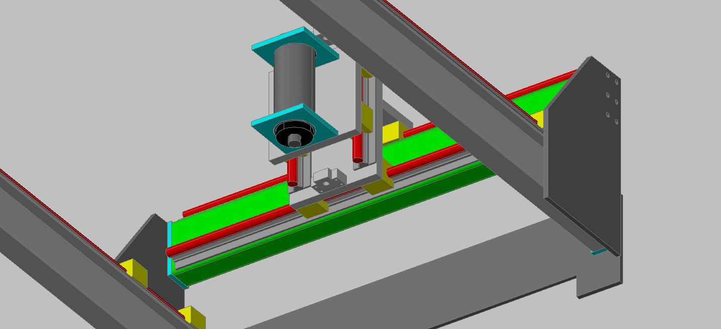

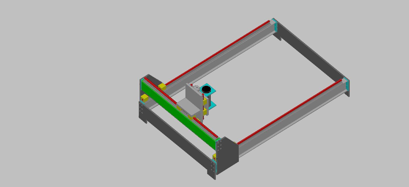

    These are not the final plans. I just upload them in order to give you a general idea of what i am going to build. The gantry will be about 60 kgr heavy
    Do you think the motor are suitable for such a machine?
    What cutting speed is possible to be achieved with these motors?
    The servos and a 2,2 Kw spindle ( without the inverter) are the only things that I have already bought
    In the original design I was planning to move the bridge with a single motor, and a ballscrew under the table in the center , which is why I ordered set of three motors and not four . Lately I'm a little skeptical that my choice and I think maybe I'm wrong . On the other even if I am wrong I cannot spent at least another 500 euros to buy extra motor and driver. Given this limitation of scenarios is
    1. Nothing changes from the original design and move the bridge a ballscrew center
    2. Buy extra ballscrew and placed on the Y axis two ballscrews ( right and left), and give motion by a motor with belt and pulleys
    3. Move the axis Y with a ballscrew in the center and use the following technique
    4. Use the rotative nut.. That means we keep the ballscrew stable and we rotate the nut

    Hi Vagelis,
    I am a beginner here, so take my advice lightly!!
    I have done a lot of reading and looking at other peoples designs.
    Option 2: using two ballscrews with one motor sounds best to me. You can use the pulleys to gear the motor to your needs.
    The other options means you have a ballscrew under the frame in the centre. this means you have to have 1500mm unsupported to allow the bridge to move.
    people have sucessfully used both methods, but for a fixed amount of steel, option 2 allows for a stiffer frame. the relatively low cost of one extra ballscrew and pulleys/belts for me would be worth it.
    Hopefully, more experienced people will offer their opinion for you.
    good luck
    greeny
    Hi Vagelis
    Option No2 is by far your best choice.
    Buy 20mm Dia 10mm Pitch ballscrews and Gear the Motor 2:1. This will allow you to easily reach 13-15mtr/min rapid speeds even with a heavy gantry and the 20mm ballscrew will help reduce whip. Because of the 2:1 gear ratio your torque will double and also because servos give linear torque they will easily handle the higher inertia of 20mm ballscrews.
    You will need to increase the frame strength with some cross bracing to achieve these speeds though has it's very weak how you have it drawn now.
    Also with the Z axis looks all wrong.? You will only be able to reach down past the gantry bottom by the length of the tool or how much the Spindle extends out of it's bracket. This will limit your cutting ability and the gantry could or will catch work in some cases.!!
    Better if you switch the bearings onto the back plate and put Rails on the moving front plate. This gives you maximum strength and will allow reach down and clearance when needed.

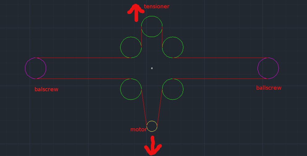

    Both solutions i think they have the same torque and the same rapids. The differense is that case 2 reduce the ballscrew bellow 1234 threshold.
    If i use one motor and two ballscrews i have to tension the timing belt
    The follwing us a 2d plan i made in order to tension the belt
    The magenta cyrcles are the ballscrew pulleys
    The yellow cyrcle is the motor pulley
    The green cyrcles are pulleys with no tooth
    The motor and the green pulley above the motor will be movable in order to tesnion the belt.
    The red colore represent the timing belt
    And finally my questions
    1. Do you think the above plan is a good solution for my case?
    2. can you tell me what pulley width should i buy?
    3. Do you now any suppluyer with good prices an quality for such pulleys and belts?
    4. Does the timing belts have rpm threshold?
    5. If i tension the belt that way ( above plan ) would that reduse its life
    6. Cast iron or aluminium is better material for pulleys
    7. which case ( case 1 or case 2 that i discribe at the begining ) is better?
    Thank you for your time
    Vagelis

    Option 2 would be best in this case but you may find locating 15mm pitch screws difficult and expensive.?
    #1: Really You don't need the upper tensioners just make the Motor adjustable to tension belts. But yes it would work.!
    #2: 15mm belt width will work fine.
    #3 Sorry no I buy local.
    #4 Yes but much higher than 1500rpm . . Think about Timing belts in Car engines.!!
    #5 Can't see why it should provided the tension and alignment is correct, most common cause of belt failure and premature wear is incorrect tension or alignment.
    #6 Aluminium will reduce inertia on ballscrew but wear quicker than Steel but again if correctly tensioned and aligned then not an issue. I've had aluminium pulley on my machine for over 5yrs and it's still fine.
    #7 See above but Like I said before 2:1 with 10mm pitch will be fine I tell you this through lots of experience not theory.!!

    Sorry for insisting to ask but i am trying not to make mistakes ( at least to make as little as possible).
    No problem and you are doing the correct thing asking questions. Just be careful not to get too hung up on specs and calculations they are helpful guides only not hard fast rules.!
    Question #1 X & Y use 10mm pitch but for the Z axis you may want to use 5mm pitch for higher resolution/torque.
    #2 If you where using steppers then I'd say yes possibly, but because you have Servos geared which give torque across the full rpm range and also geared 2:1 so doubling torque then No you will be better with 20mm to help reduce chance of screw Whip.
    #3 The BK/BF are one type of correct end bearings but depending on your design you may prefer the FK/FF type both work the same just suit different mounting locations.
    #4 Well you can buy belt tension meters but they are expensive I believe. After that then it's mostly experience and judgement I'm afraid.
    So long has the belts isn't guitar string tight or washing line loose then with common sense you will tell if it feels right or wrong.
    Regards Backlash then with the 15mm HTD belts I use then I see very little to none, certainly not enough to show in 99.9% of the work I do.
